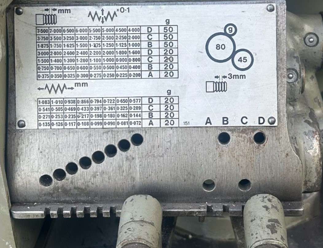

      Hi
      I have not yet cut a thread on my metric Boxford lathe even though it has a built in gearbox at the end of the lead screw.
      I believe that I do not need a thread dial indicator if I keep the nuts on the saddle engaged as I stop and return the cutting tool back to the beginning.

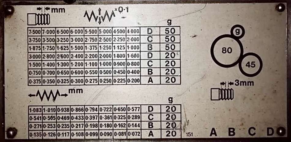

      What I would like help with is an explanation of what are the various settings in each of the 2 lists relate to for the attached chart on the gearbox to engage the the correct levers.
      Boxford screw cutting chart

      bernard towers
        @bernardtowers37738
        I am ready to be shot down in flames but here we go. The lower chart is your fine/surfacing feeds for normal machining operations with the 20 tooth gear in the g position. The top chart is screwcutting using the 50 tooth gear for the top 3 lines giving you on the top line D setting threads from 7.5 to 4mm pitch, next one down C setting gives 3.75mm to 2mm pitch and the next line B setting gives 1.875 to 1mm pitch.Then if you change the 50 tooth gear for the 20 then the next 4 lines come into play.
        Dont forget that the surfacing lever is a different one to the screwcutting one .Best of luck.

          Thanks for answering my question.
          If I wanted to cut an M12 thread with a coarse pitch of 1.75 would I be correct with the 50 tooth gear at g in setting the first lever on the left at the 2nd position from the left and setting the second lever on the right at position B

                    Why would you even mention inches when he’s trying to cut metric threads with a metric leadscrew?
                    Andrew: Using the chart is very simple. Find the pitch of thread you want to cut. Move the tumbler lever to the hole directly below that column which shows your pitch. Now move the ABCD lever to the correct letter for your pitch. Your lathe is now set up for cutting.
                    So in the image below for cutting a 1.5mm pitch you would move the left selector lever to the 4th hole (directly below the column containing 1.5mm) and the right lever to the hole under B.
                    metric boxford gearbox
                    You are correct that keeping the threading lever engaged and backing up the motor means you don’t need to use the threading dial, but you should also know that because you’re using a 3mm leadscrew you can cut 3mm, 1.5mm and 0.75mm threads, possibly even 1mm pitch threads as well, without using the dial at all just by closing the half-nuts anywhere you like.
