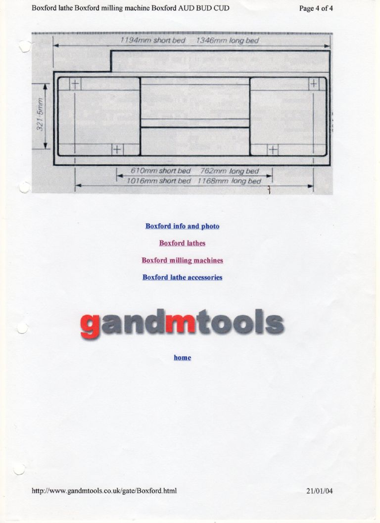

      Does anyone happen to have the layout of the floor-bolt pattern for a Boxford under drive type cabinet? I'm assuming that they are all the same……..though that might be wishful thinking. I do not have the means to be able to lift my VSL LOO lathe high enough to see underneath nor tip it upsidedown! The motor/variator obscures the holes in the left hand end of the floor rail and prevents access to drill through from the top.

            Hi Trevor. I have a Boxford AUD. My cabinet has no holes in the frame for bolting down. I drew a line around the frame on the inside of the end cabinets. I pulled the lathe away from the wall and drilled holes for the Rawlbolts. Slid the lathe back in position and knocked in the Rawlbolts and girder clamps to hold it down. I only used 4 clamps, 2 at each end. I did not graunch the nuts down so as not to distort the cabinet. The cabinet is supposed to be rigid enough that the lathe bed is properly supported by the cabinet to prevent twist. It is easy enough to knock in a few wedges to level the cabinet if needed.

                I would recommend taking your own measurements as I suspect there may be variation between cabinets. On my VSL the socket for mounting feet are closer together at the front of the cabinet than those at the rear. The sockets are a shade over 40mm square with slightly radiuses inside corners.

                    This used to be on G and M's website until they 'updated' it.
                    I'm sure they won't mind a free advertisement!
                    Mine is also on machine feet.
                    I would be very careful rocking it to get feet in. They are rather top heavy so fall over easily! Either borrow an engine crane if you have room or pry it up onto timbers front to back to get your clearance.

                      Bearing in mind what John said about dimensional variation, I levered my lathe onto a piece of 1/2" ply and with a flexible drive welded to a suitably sized wood bit I was able to get around the motor and drive system and bore down through the crud filled holes into the ply.The resulting template was used to drill holes in the concrete for Rawlbolts. The spacing is as per the drawing posted by Ol Elan
