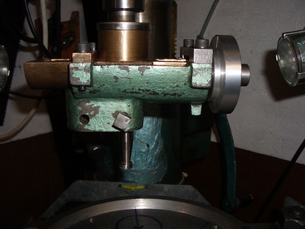

      Lynne
        @lynne
        Good Evening. Attached is a photo of a boring tool that I acquired with the mill. It required a lot of fettling for me to be able to use it, and it is now light fingertip control. I carries no name of mfg. and I would be interested to know its origins. Does anyone have a similar one? Lynneimgp2288.jpg
        #461648
        Emgee
          @emgee
          Dore Westbury, built from a set of castings. Also had a facing facility but it looks like that's not been built on yours.

              #461678
              Kiwi Bloke
                @kiwibloke62605
                Designed by Arnold Throp, who was the founder of Dore engineering, who provided a kit for it. Nothing to do with ETW, as far as I know. It's shown in use in Throp's book 'Vertical Milling in the Home Workshop and discussed by GH Thomas in his 'The Model Engineers (sic) Workshop Manual'.
                The 'Dore-Westbury' milling machine was Throp's re-design of the earlier Wesbury machine. Dore Eng. produced kits, in which the larger pieces were ready-machined, and added the (optional?) back-gear. Castings for the original design were also available, from Woking Precision, IIRC.
                [lots of edits – it's all coming back, slowly (wibble-wobble, wibble-wobble). Virtual prize awarded for anyone who can identify what I'm referencing in parenthesis in the previous sentence!]
                Edited By Kiwi Bloke on 02/04/2020 07:58:23
                Edited By Kiwi Bloke on 02/04/2020 08:06:18
                Edited By Kiwi Bloke on 02/04/2020 08:09:11
                #461688
                Dave Wootton
                  @davewootton
                  I think Kiwi Bloke has it right, I think the original design was to fit on the spindle nose of the lathe, I borrowed one from a fellow club member years ago to cut an internal circlip groove using the facing facility of the original design and it worked very well.
                  As KB says George H Thomas mentions it in his book and made a few minor mod's to it, if you could get a copy of the original drawings, I'm sure with a small amount of work to make the star wheel feed mechanism it would make it a very versatile bit of kit. Shame no one does the casting anymore (as far as I know) or I would be tempted to build one.

                          #461747
                          ega
                            @ega
                            Thanks to Kiwi Bloke and others for filling in the gaps in my recollection.
                            Having checked I can add that the Arnold Throp/Dore design dates from 1969 and was based on a head made thirty years earlier. The intention was to provide boring and facing abilities to the owners of small lathes and milling machines. Apart from the D-W and Myford models it was available for Drummond, Perfecto, Portass, Zyto, Lancing and Grayson lathes.
                            The core of the design was a half round slide which could be made on the target lathe – no shaper or vee milling cutter required – and the kit bodies were helpfully pre-screwed to fit the spindle.
                            GHT was somewhat critical of the design but was a boon to many MEs of the day and AT was a real benefactor to the movement.
                            #461756
                            Roderick Jenkins
                              @roderickjenkins93242
                              The star wheel latches round once very revolution to let you face, especially useful down a hole. It's not just a clumsy hand wheel.

                              #461761
                              Emgee
                                @emgee
                                Purchased my Dore Boring and Facing head kit from Ivan Law at the same time I picked up a set of castings for the Mk 2 Dore Westbury mill.
                                Yes Michael, gear built into the spindle drive pulley, could be engaged by movement of the pin that locked the geared pulley to the spindle, so long ago now this is open to discussion or correction.

                                #461802
                                Lynne
                                  @lynne
                                  Thanks for all the responses, they make interesting reading. I did not appreciate the function of the star wheel, just did not find it easy to use , so I replaced it. Now I know, wish I had kept it. Lynne

                                  ega
                                    @ega
                                    Roderick Jenkins:
                                    Is the mill in your picture a Sharp, by any chance?

                                          #473519
                                          Roderick Jenkins
                                            I've just reviewed this thread after a PM query from Lynne. To answer ega's query – yes it is smiley
