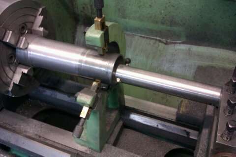

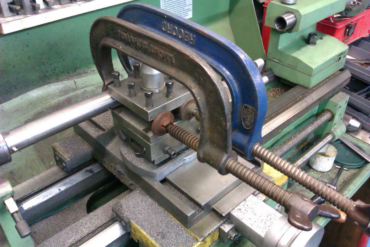

              If I can do that sort of thing on my Imported lathe then a Myford should be able to do it too. However an ML7 could possibly be showing it’s age so a bit of a tapered bor emay result.
              You will certainly need a fixed steady as having that much metal sticking out of a chuck is not practical or safe.
              Drill out a smuch a spossible using “blacksmith” drills which have a reduced diameter shank so can be held in a tailstock chuck or pick up some old MT2 shank bits and sharpen them, doe snot have to be perfect as you will be boring after drilling out to 1″
              As for a boring bar the choice is yours Carbide insert in which case use CCMT 09T302 inserts which are sharper than CCMT. Or make your own from say 22mm bar, drilled at an angle to take a 1/4″ HSS round tool bit and cross drilled & tapped for a grub screw to hold the bit. Clamp bar direct to cross slide or even remove that and use a solid block fixed to te cross slide.
              If you could put the fuse in to the opposite end then the possibilities for between centre boring bars which are likely to give a more parallel bore should be considered.

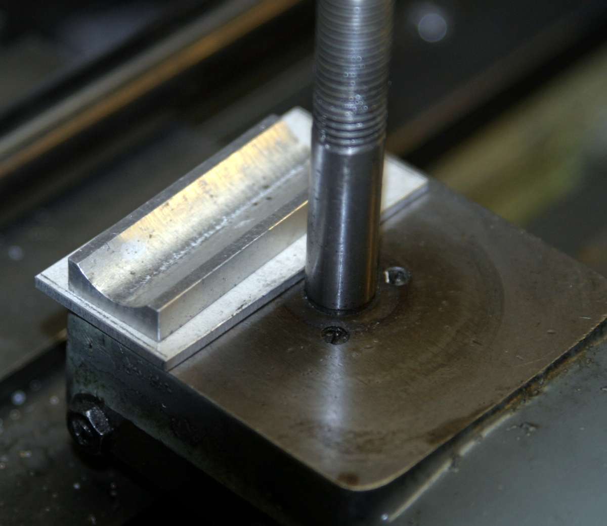

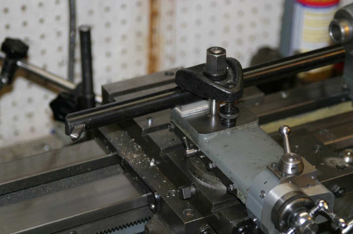

                              John Purdy
                                @johnpurdy78347
                                Here’s what I have used to do similar sized deep holes. The boring bar is held in a piece of aluminum with a semi circular cutout ( a “V” would work just as well) with the cutting edge of the tool bit shimmed up to centre height. This one is a commercial 3/4″ dia bar with a 1/4″ sq. tool bit. I also have a 1″ home made one also with a 1/4″ bit.

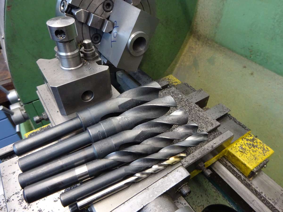

                                  #834713
                                    If you work up through sucessively larger diameter drill bits rather than going straight in with a 1″ that will put considerably less load on the machine and the drill holding arrangement. 1/8″ increments would be OK
