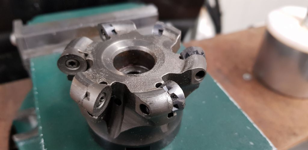

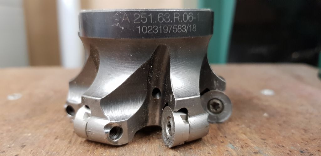

                  I usually mill down the shanks of indexable lathe tools with a 50mm Ceratizit shell mill which has 5 inserts of 12mm diameter. They are economical as they index 8 times, but I would only expect to get one index when milling a 20mm turning tool shank to 17.53mm. This is partly my own fault as the inserts are for stainless, and the steel I use it on is harder. It can be cut with a hacksaw, but it's hard work. The cheap APHT type shell mills would do the job with Chinese inserts. I would not recommend using a solid carbide cutter as the average person cannot sharpen them.

                    If you are talking about one that looks like a Borg's hand with the circular cutters. I think i have one of those. Is this the one.
                    If so that could be good as a friend i spoke to tonight says he may have some 16mm bars from when he was in engineering, so i guess they will be top quality. If i can narrow them down to 14mm or so they will fit my holders.
                    What would the best holding method be. I do not have a collet block to hand to hold them.
                    Steve.

                      Stevie, the bars are unlikely to be any harder than those QCTP holders you cut down so the face mill with the inserts for hardened steel that you used on those should do the job. A lot depends on the quality of the bar, from ones I have modified they seem to get harder as the quality goes up so a cheap far eastern one is more likely to be easier to cut than a name brand one.
                      Hold in your vice supported on parallels and reduce one face than flip it over and do the other. But you may well find that a 16mm bar is already 14mm clamping size.

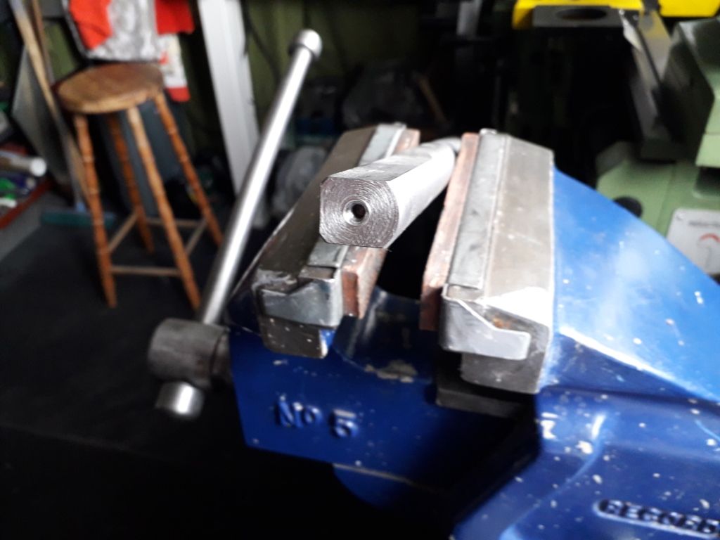

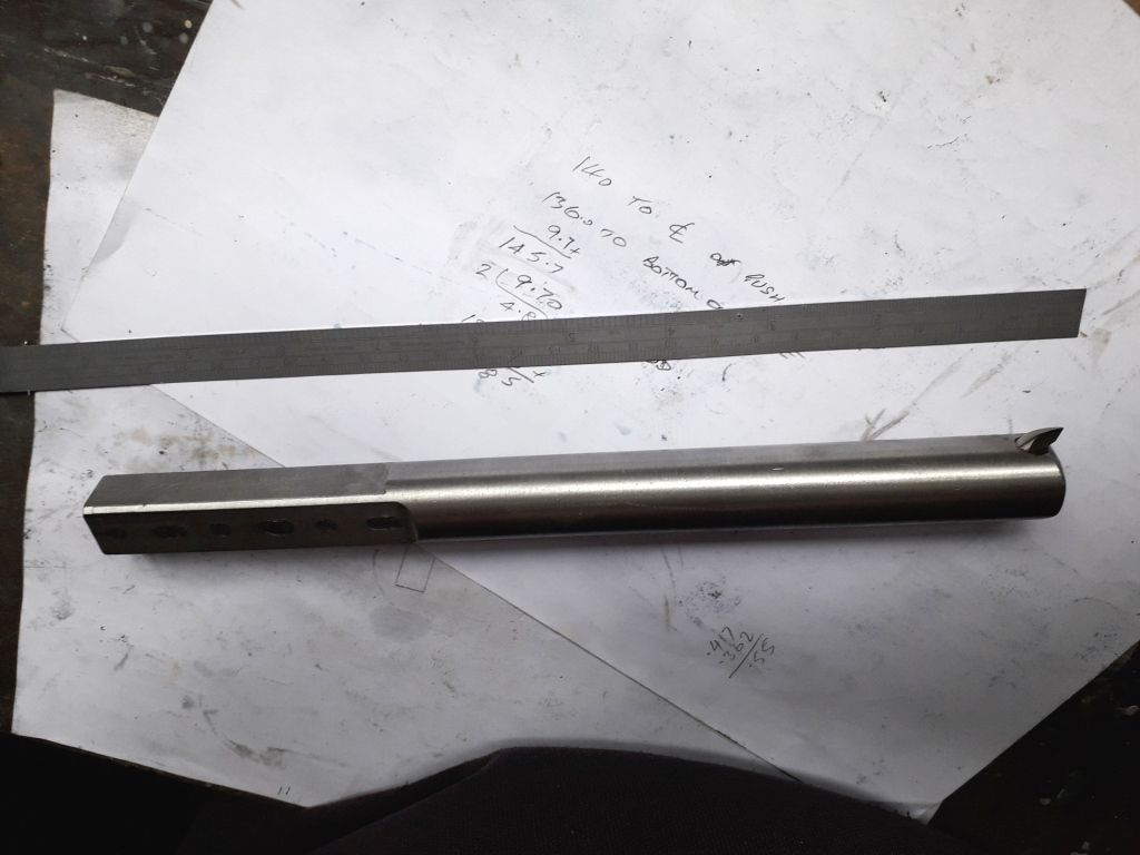

                        I knocked the bar up below to bore the CI cylinder for my economy engine, the round part is about 22mm and my lathe takes 16mm shanks. My finished bore was 42mm dia so I could have gone bigger but that was all the stock I had to hand. Basically the bigger the better provided the swarf can get out and it doesn't rub.
                        I also have a set of tipped bars from the well known international broker from 8 to 10mm that work fine and several other home made bars. The one in the pictures show how I reduced it to fit the lathe but only at the tool post end.

                        #495311

                          I just hold boring bars in a milling vise on parallels making sure the line contact is a safe ammount below the top of the jaws. First you need to measure the height of the tip above the bar base to find out whether your toolpost/ toolholders minimum height call for any modification. Then measure the thickness of the bar relative to the clamping height. When the bar has had its height/thickness adjusted, hold it in the toolholder and check whether the clamping depth allows the screws to hold the bar securely. If the bar looks like it is not held securely, then a little milled off the back will allow it to seat deeper.
                          That 63mm shell mill has exactly the same type of inserts as my Ceratizit, the cutouts on the rear of the inserts are the indexing positions. You have to slacken off all the screws, and then hold each insert in turn while further slackening off the screw until you can turn to the next position. Remember to turn them all the same way. As soon as the insert is re indexed, fully tighten it. When you run out of slack screws, you know you have re indexed and retightened the lot.
                          I have just noticed that the inserts in your shell mill are not a matched set.

                            Yes i see now that they are not all indexed the same. This is how they came to me. Would i be best to remove them all & reinsert them all at 1st pos. Then note any wear. If 1st spot worn then move to 2nd & so on. Making sure i turn them all the same. Hopefully finding a good set. I did use this just once doing the tool holders. It worked well with no sparking , but was quite noisy over the square tipped one i have.

                            #495329
                            old mart
                              @oldmart
                              What I noticed about your shell mill inserts are the inserts are not a matched set. Sone have 8 indexing notches, and others have 4. WNT and Cetatizit both make the particular insertsfor these shell mills, likely RPHX12 if they are 12mm diameter, RPHX10 if 10mm.
                              The advantage of mine is that it takes half a box of inserts to fill it, but yours can run balanced with 2, 3, 4 or the full six inserts.

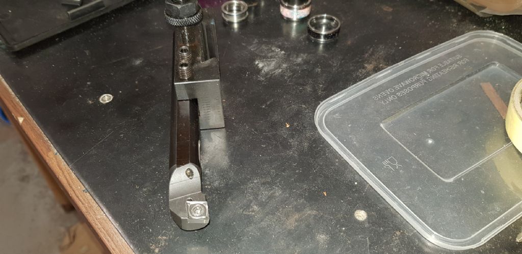

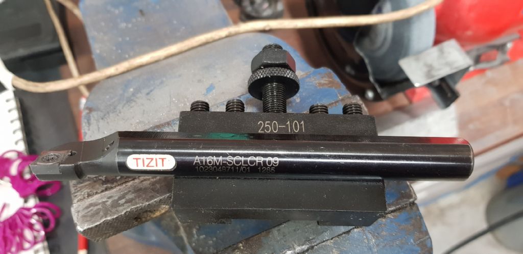

                                Well i ended up buying a used Tizit 16mm round type bar that takes the triangular inserts. I think i may have some inserts that will fit. The bar has a flat on the top, but is still too big for the toolholder. 1st job will be to mill the top down until it fits the holder. I think i may also need to take a cut along the side too, to make sure it is in the holder enough. edit. I know it is a through coolant version , but at the price it was very cheap & a good quality. I have also ordered a cheap 12mm one from a supplier , in case the 16 is too large. Will then have a 8mm – 12mm – 16mm – & a few HSS ones that came with the lathe.
                                Steve.

                                #496377
                                duncan webster 1
                                  @duncanwebster1
                                  I'd take a bit off the bottom, then it will sit on a flat rather than an arc

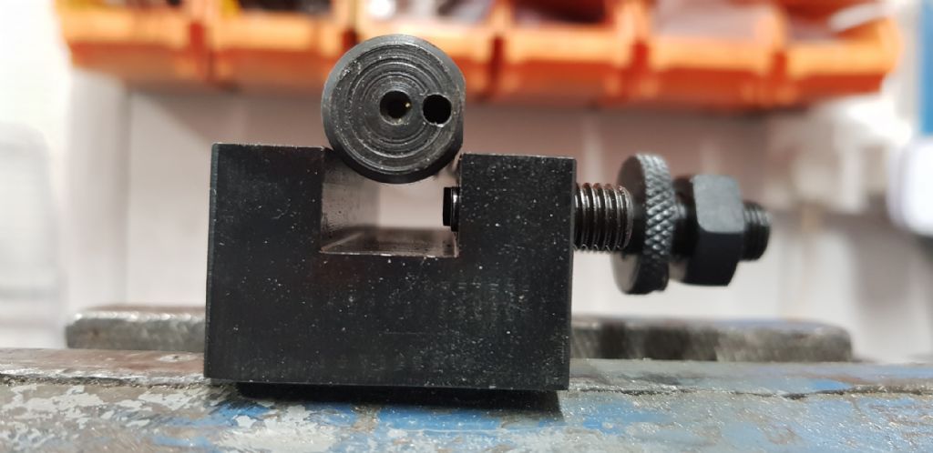

                                    Can you not get or make something like this?
                                    gwAAOSwcjdfV3kT”>https://www.ebay.co.uk/itm/Mecanizados-Huesca-25mm-Boring-Bar-Holder/143726614078?hash=item2176c6163e:ggwAAOSwcjdfV3kT

                                    Steviegtr
                                      @steviegtr
                                      Duncan. I meant to say bottom not top, other than the boring bar holder i have , does have a ridge in the bottom.
                                      Although it might be better to make a new dedicated holder from scratch. I have some steel block over from the last ones i made.
                                      The idea of not cutting it down & having a holder with a hole through probably be the best option.
                                      It will give me chance to get some more experience with the mill. The last ones i made were a little bit large on the dovetails & the handle comes too far round. So more care this time round.

                                      #496512
                                      old mart
                                        @oldmart

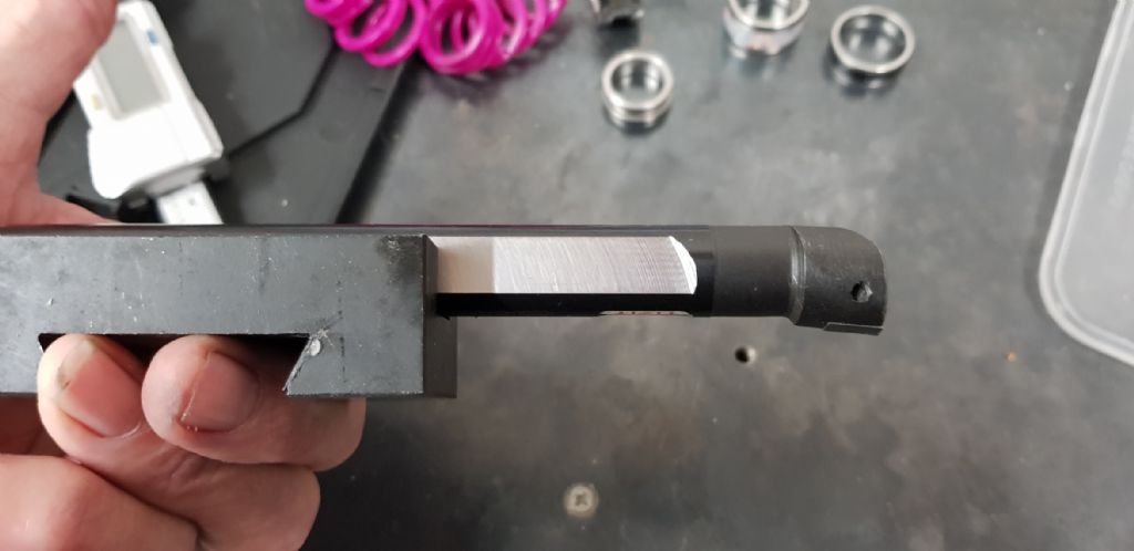

                                        You need to keep the Tizit bar flat horizontal while milling the bottom down to fit in your holders. This is to retain the correct angle of the insert when viewed from the end of the tool. It should dip slightly.
                                        #496622
                                        Steviegtr
                                          @steviegtr
                                          Posted by old mart on 18/09/2020 13:58:43:
                                          Yes i did that. All went well, but i may have to remove a bit from the side as well. It does not sit well in respect of the holding screws.
