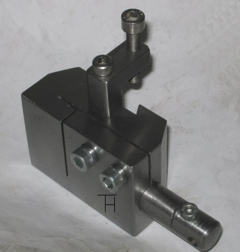

                      #494860
                      Mike Poole
                        @mikepoole82104
                        https://www.model-engineer.co.uk/news/article/a-heavy-duty-boring-bar-holder/23221
                        Steve, one of these may be worth making if you want to do some heavy boring, any quick change toolpost and compound slide will cost rigidity. It’s not so handy for boring a taper though.
                        Mike
