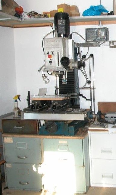

                  If you've not yet ordered the stand this is what I did in BB (Before Bridgeport) days. OK its a Chester Lux type so a bit larger but principle is the same. Turned out perhaps 8 inches lower than usual stand height which had me worried that it might have been too low until I used it. Didn't take long to decide that the standard cabinets are too high!
                  The two cabinets under the machine are bolted together. Hafta do it with wood/mdf/kitchen worktop spacer between. Metal side to metal side doesn't work well. Either rings like heck or refuses to go straight. Or both! I cut one four drawer unit down to get two two drawers.
                  Clive

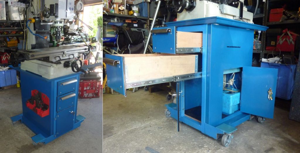

                    I only have a small workshop with not a lot of floor space for a mill, lathe, press, etc. and have mounted my RF-45 mill on casters so it can be moved. The supplied mill stand has been modified with additional shelves for storage. It is very stable, even when the table is extended to one side with a load of an 8" rotary table and chuck. No distortion of the mill base or movement when machining. It weighs more than 300kg and can be moved by hand.
                    Paul.
