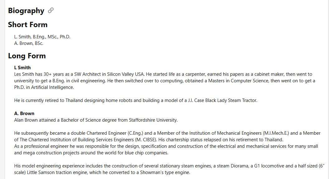

          #800904
            On MEinThailand Said:
            Charles said
            “(I also have a B.Sc.Eng.)”
            And an MSc? And a PhD? And formerly a Chartered Engineer, (C.Eng) a member of the Institution of Mechanical Engineers (MIMechE) and a member of the Chartered Institution of Building Services Engineers (MCIBSE)?
            As I posted earlier
            I’m sure the members would also be interested in past experience in this field not just the calculations but what boilers you have both previously made, were they to published designs/methods and did you find that they distorted and if so by unacceptable amounts.
            maybe I’m a bit sceptical and regulars here will know I’m more a man for practical matters than theories but although you have the letters after your names I wonder how relevant the MSc and PHd are as they do not really relate to engineering or show a background in pressure vessels which several of the respondants here do have.
            This is the Bio that would seem not to have made it into the article.
            bio
            As the G1 Loco is electric and the Case not made that only leaves the Little Samson Boiler as one you may have made or was it done by a third party as most here would do with a steel boiler?
            Original article for anyone following along who is not a subscriber
            https://modelengineeringinthailand.com/forum/index.php?threads/the-yield-point-method-full-original-article.47/
            The thread that Luke R and I have mentioned in this thread
            https://modelengineeringinthailand.com/forum/index.php?threads/thickness-of-copper-boiler-shells.6/

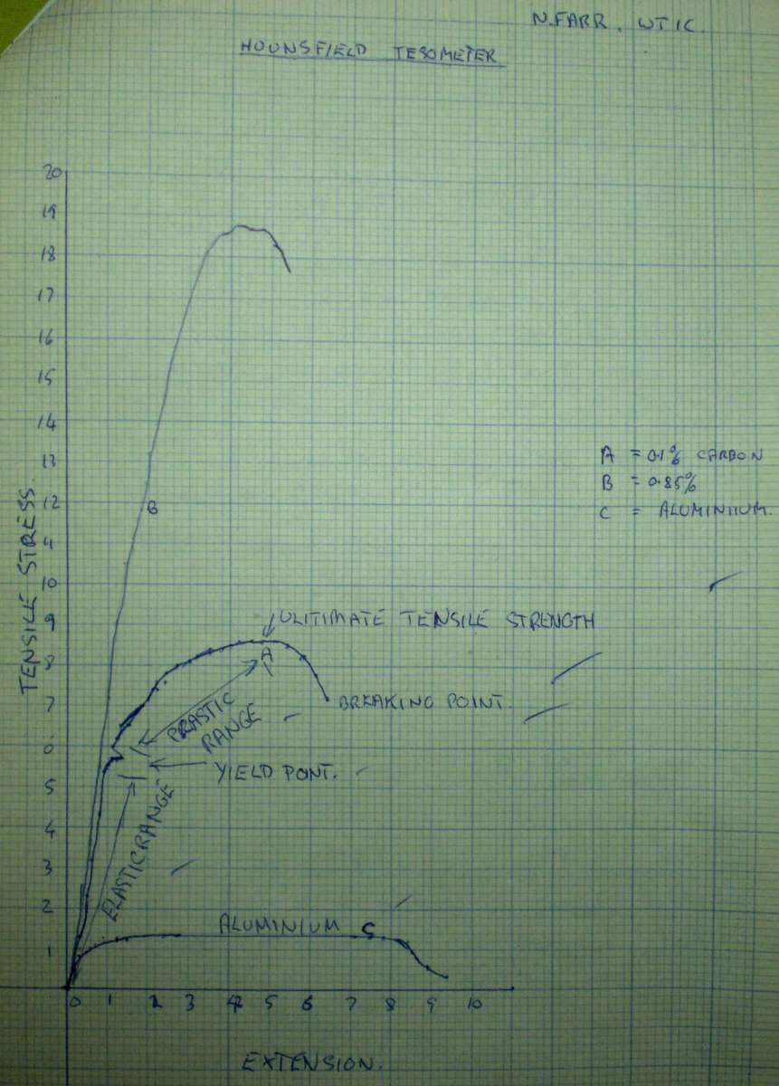

                  Hi, I remember doing tensile testing during my Tech college days, using a Hounsfield Tensometer although we didn’t test copper, the results showed the elastic range, the yield point, the ultimate tensile strength and breaking point. designs were considered to be within the elastic range.
                  CIMG0759
                  Regards Nick.

                    Dear JasonB, the short-form Bios you have posted above were submitted to the Editor at Model Engineering & Workshop magazine as part of the Yield Point Method article.
                    The Editor chose not to include this information and I assume that as Editor he had good reason not to so. And for reasons that you will probably never understand I agree with his editorial decision.
                    You have now usurped the Editor’s editorial decision by posting it yourself, presuming that you know better than the Editor.
                    As I have repeatedly said the scope of the Yield Point Method article ends at the output of a theoretical calculated figure for the minimum safe thickness of a copper boiler and compares that value to one obtained by the traditional (UTS) method.
                    We, the authors of the Yield Point Method article, have not ventured either in the article nor on this forum into the realms of boiler construction beyond the establishment of boiler shell thickness calculations and I will reiterate the statement in our article:-
                    “There may be operational factors acting on the boiler that will increase the shell stress but that cannot be readily determined. A boiler for a model traction engine for example will have additional stresses derived from its own weight when travelling over rough terrain.
                    Due to the wide range of uses and environments a steam boiler can be used in, the authors have not added any allowance for such environmental conditions and leaves it to the boiler designed to account for such factors in the design.”
                    We will respond to technical questions relating to the YPM article but feel that we have no responsibility to go further than the stated limits of the article.
                    By the way, since you have posted our short form Bios on the forum (did you get the Editor’s permission to do that, since he previously decided not to) how about posting your own?
                    PS Spelling mistakes in your post:-
                    PHd should be PhD
                    respondants should be respondents

                                  Hi Dave, my understanding of these replies is about deformation or not in the relative ME&W article. The point being that the yield point of the material is the deciding factor, but of course, that should be of the weakest material in the design. So the design is best if it’s use is in the lowest part of the elastic range in the weakest material. Once a material reaches the yield point, there will be permanent deformation, once that happens, there is no second elastic limit, and deformation will continue to the eventual breaking point, just as the Tensometer graph above shows. I think the science shows why things are wrong.
                                  Regards Nick.

                                        Hi Noel, I understand what you are saying, and I’m not a metallurgist either, but they did go into it in detail in my Welding Institute course. The main thing’s were producing a design, choosing materials that will cope with all the pressures, loads, temperatures etc. and then add on the safety factors required. Testing would be done only up to maximum permissible loading, where upon no permanent distortion or other failures would present themselves. If you need a short unsustained period of overload; that should be included in the design.
                                        Regards Nick.

                                            Charles, surely mild steel DOES work harden ? Thats why after bending it is difficult to straighten where it was bent. Noel.

                                              Just to keep the pot boiling, does copper exhibit the same strength difference as iron when tested along or across the grain? I have never seen this mentioned. Because if using a drawn tube for the barrel then the drawing will, possibly, increase the strength along and not around, exactly the opposite of what is needed.
