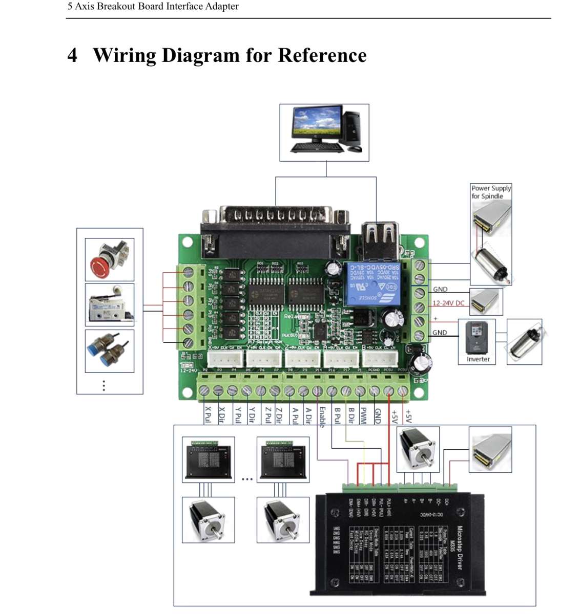

                  #814958
                  John Haine
                    @johnhaine32865
                    Hum being the operative word perhaps…
                    #814961
                    Stuart Smith 5
                      @stuartsmith5
                      Richard
                      This manual may be useful.
                      https://www.vallder.com/images/product_details
                      It may not be for the exact board, but looks the same.
                      Stuart

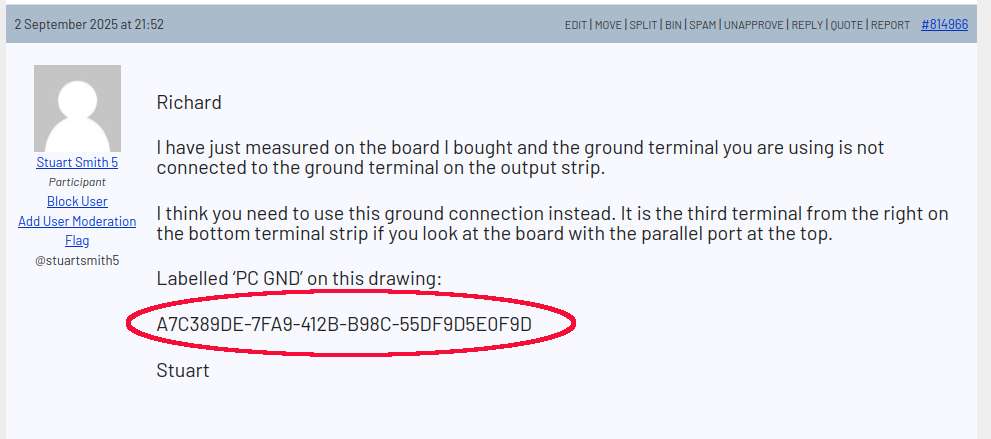

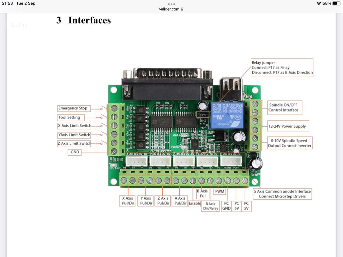

                      #814966
                      Stuart Smith 5
                        @stuartsmith5
                        Richard
                        I have just measured on the board I bought and the ground terminal you are using is not connected to the ground terminal on the output strip.
                        I think you need to use this ground connection instead. It is the third terminal from the right on the bottom terminal strip if you look at the board with the parallel port at the top.
                        Labelled ‘PC GND’ on this drawing:
                        A7C389DE-7FA9-412B-B98C-55DF9D5E0F9D
                        Stuart

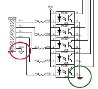

                          On Richard Evans 2 Said:
                          The replacement BoB arrived, but I’m tearing my hair out ….
                          The BoB has no dedicated ground connectors for the axis outputs so I’m using a ground terminal associated with the limit switch inputs- the board has several ground terminals and I’m assuming they are common?
                          Any thoughts please?
                          Assuming the grounds are connected together may the mistake.  The BoB circuit opto-isolates inputs from outputs: they should not be connected electrically in any way.  The diagram uses two different triangle symbols to show the ‘commons’  are different, circled in red and green:
                          Screenshot from 2025-09-02 21-53-24
                          The OUTPUT grounds are all in the DB25 socket, not available on a terminal.  They are in the cable.
                          You may have bypassed the opto-isolation by using the INPUT ground: try disconnecting it.
                          As the BoB is fairly simple and unlikely to go wrong unless over volted , I suspect the original problem is the cable, not the Bob,  Check the cable and the plugs and sockets for continuity. Look for dirt,  corrosion, dry joints and bent pins.  Metal fatigue causes hard to trace intermittent faults – wires broken inside the cable that make contact or not as the machine vibrates.   Replace cable if suspect.
                          Dave.

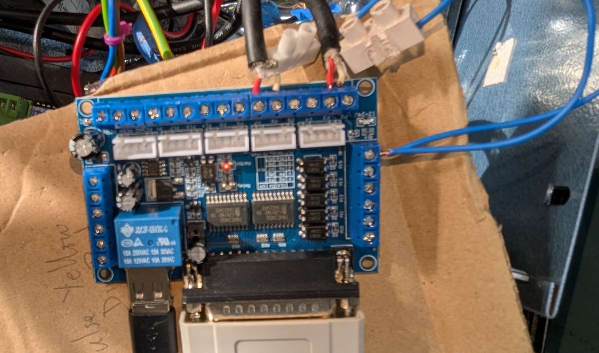

                          #814983
                          Stuart Smith 5
                            @stuartsmith5
                            Have you read my posts?
                            It turns out that this board is not isolated. Just buffered.
                            It is powered by the PC via the USB connection (which is not used for data, just power). It is this connection that removes any isolation. If the USB port is supplied from a separate PSU it would be isolated. But the connection diagram shows it taking power from the PC.
                            What you said in your post would be true for an opto isolated board, but this one isn’t if connected as shown.
                            It seems to have two sections which are isolated from one another, one for the stepper drives and a separate section for the spindle drive. The spindle drive section uses the higher voltage input to convert pulses from the parallel port to a 0 to 10v analogue output for spindle speed and a relay to switch the spindle on/off. This section might or might not be opto isolated from the parallel port but I haven’t checked.
                            Stuart

                                I have taken the liberty of posting a screen-shot, for convenient reference
                                IMG_1040
                                #815003
                                  … But of course the forum-software has downsized the image

                                  Richard Evans 2
                                    @richardevans2
                                    Success! Both axes moving smoothly. Now I have to work through some settings in Mach, and we’ll be back in business.
                                    Sincere thanks for all the help!

                                      #815021
                                      Stuart Smith 5
                                        @stuartsmith5
                                        Sorry, Dave.
                                        The photo was the same as the one that Michael g has posted.
                                        Anyway, I have a similar board, but have not used it.
                                        I did a bit more testing this morning on my board and ( not unexpectedly), the product description is misleading ie wrong!
                                        The pins for the stepper drivers are not opto isolated, they are just buffered via two bus transceivers and are directly powered from the USB port.
                                        There are only 5 opto isolators and these are for estop and limit switches. They share the same gnd connection as the 12 – 24v power input for the spindle drive circuit. The 0 – 10v output for the spindle drive is not opto isolated and shares the same gnd connection as the 12 – 24v power input.
                                        So all round if anyone is using this board they need to be careful!
                                        Stuart
                                        #815049
                                        Stuart Smith 5
                                          @stuartsmith5
                                          Just a correction for my previous post. I should have said that the spindle drive circuit IS opto isolated from the parallel port, but the output is not isolated from the 12/24v power supply (ie they have a common ground connection).
                                          Stuart
