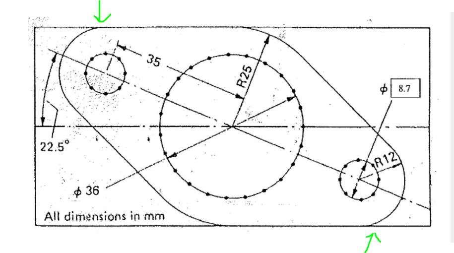

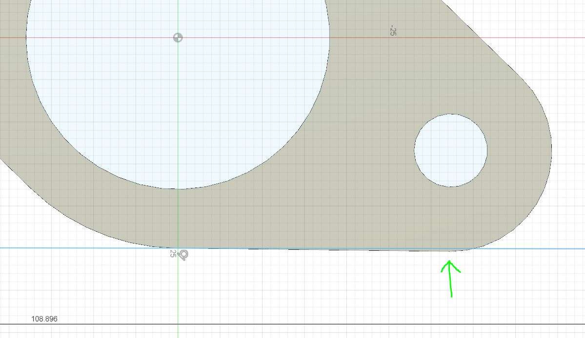

      Hi all,

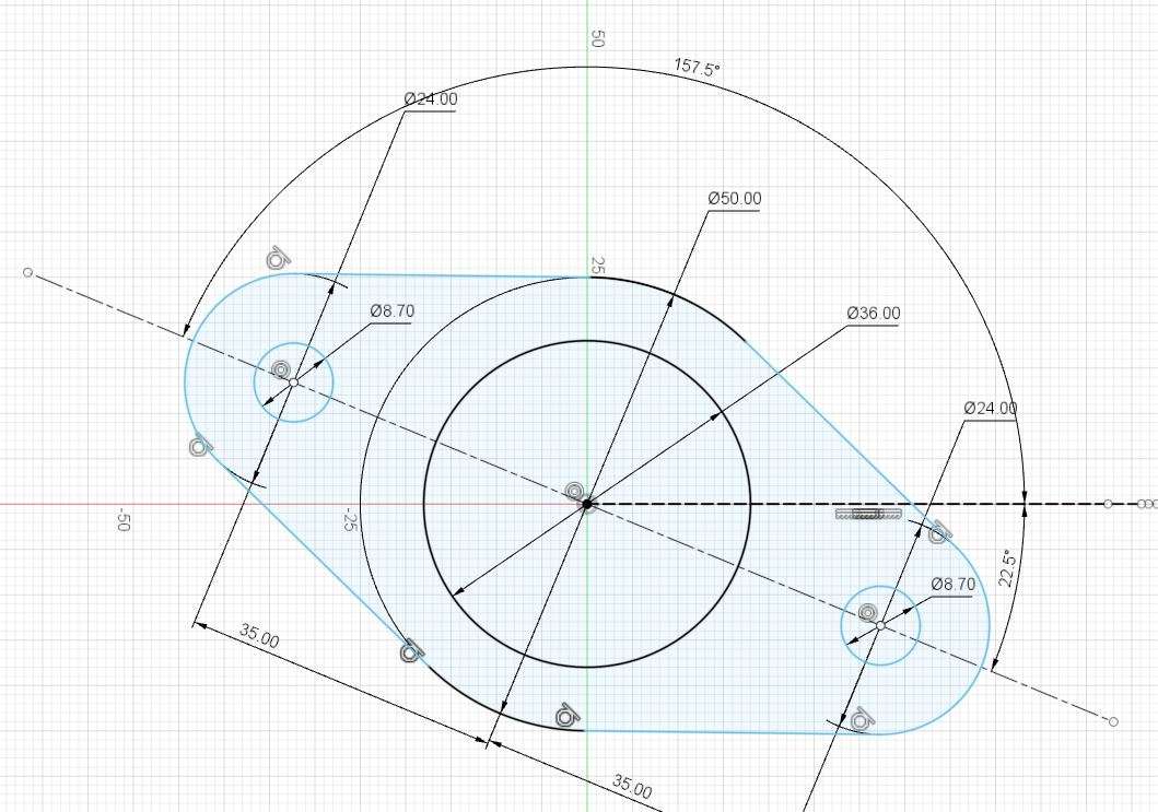

      I’ve been playing about in Fusion 360, trying to redo an old drawing used as teaching material on my course.
      I’ve modelled the part successfully, but I can’t find a way to include a reference line running through the hole centres in the final ‘Drawing’ section. I need this to show the 22.5 degree angle.
      Can anyone shed any light on this, or am I trying to use the wrong program?
      Screenshot 2025-08-15 at 16.56.31Screenshot 2025-08-15 at 22.12.34

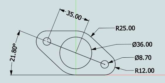

        I don’t have Fusion 360 so I cant help you there, but what does the horizontal centre line reference to on the part, as It doesn’t seem to be parallel with either the upper or lower straight lines of the part as drawn in your second photo?
        I ask because my CAD finds an angle of 21.8 Degrees rather than the expected 22.5.
        Martin.
        22.5 Degree

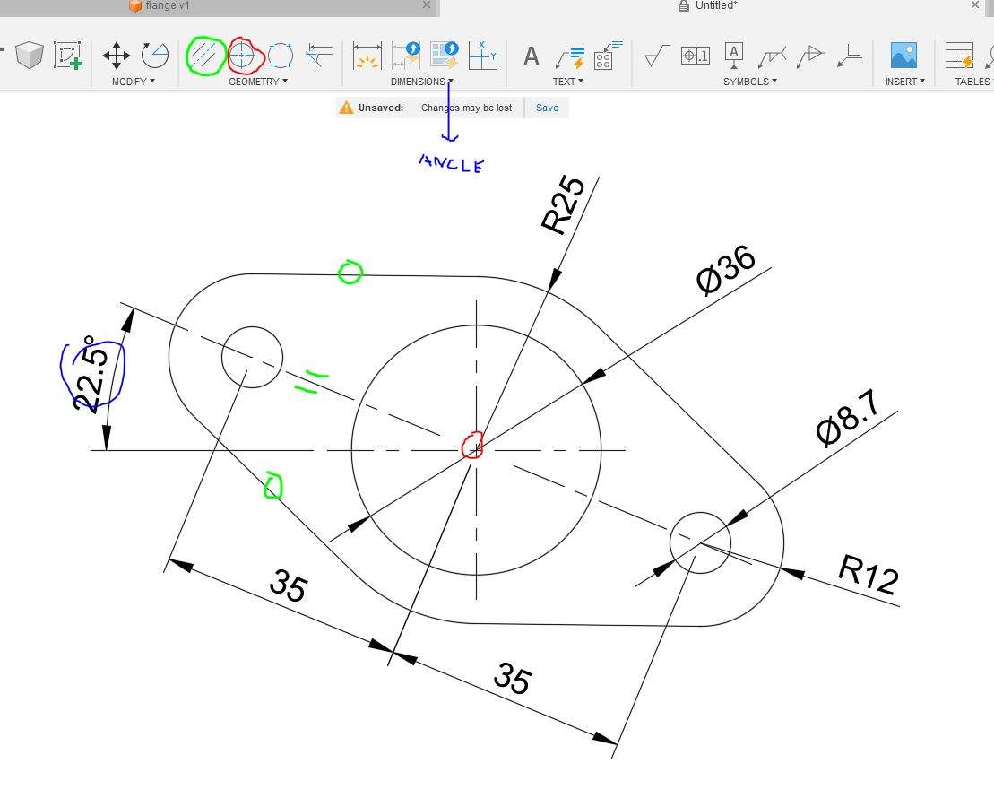

          As a stand alone part it could just be drawn with teh three holes horizontally but that kind of defeats the object of repeating the exercise.
          I hardly ever use 2D in F360 but worked itout fairly quickly.
          1. To get the angled ctr line chose “centre line” from the geometry section and then click the two lines I have ringed in green which will put a ctr line between them
          2. Next select “centre mark” again from geometry and then click the 36mm circle(not the ctr as I have ringed) this will give the vertical and horizontal ctr lines.
          3. From the dimension drop down select “angular” and then click the angles and horizontal ctr lines you have just created and it gives the angle between.
          I drew it from the dimensions given and placed the two 8.7mm holes & 12mm radii at 22.5deg then the four straight edges were done as tangents and not drawn horizontally.

            Here is my initial sketch if that is of interest
            flange sketch

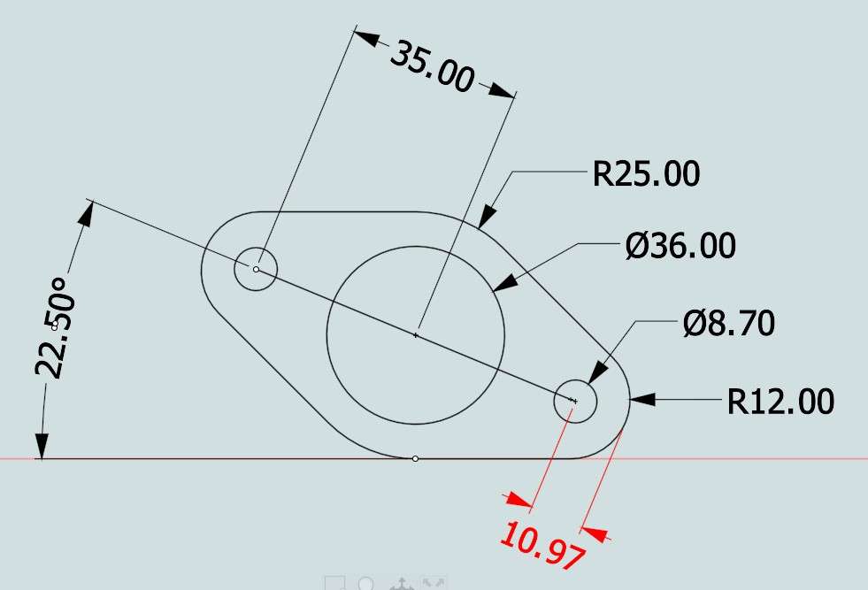

                      This is what I get after correcting the angle to 22.5 Degrees whilst keeping the dimensions as drawn. It results in the 12mm rads having their centres relocated slightly away from the 8.7mm hole centres – as per the dimension in red.
                      Martin.
                      Screenshot 2025-08-16 110558

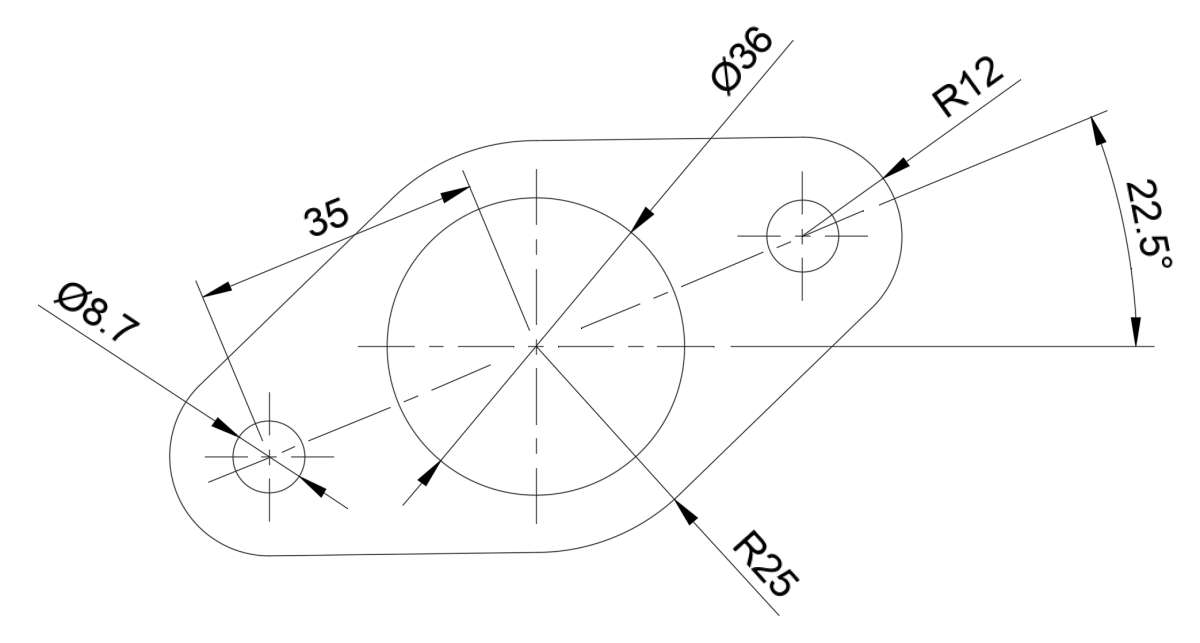

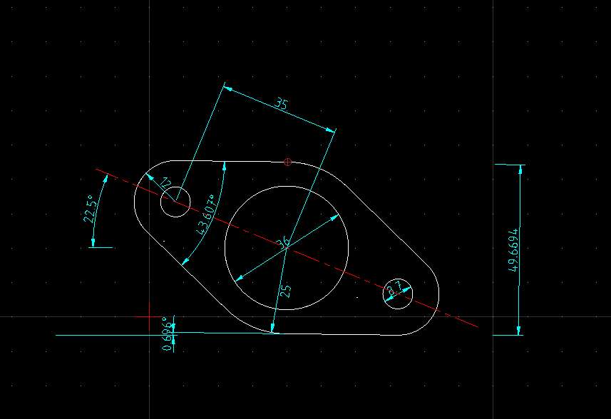

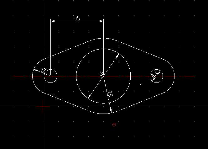

                        In my innocence, I would draw this with the centre line horizontal and do the sums later as necessary to make the item from bar stock.  Martin is smarter than me, spotting the thing is essentially 50mm.  Actually I make the distance between parallels to be 49.6694mm.  Not investigated yet why they aren’t exactly 50mm apart, in accord with the drawings largest diameter:
                        horiz
                        Anyway, to get the tilted version, I simply rotated the whole drawing by 22.5°.  Rotations are trivial in most CAD applications, but hard work on a mechanical drawing board!  But rotating by 22.5° reveals that the lower straight line is off-horizontal by 0.696°:
                        tilted
                        I no longer have F360, discarded in favour of SolidEdge, because AutoCAD altered the licence conditions and are able to enforce  new rules because the product has to phone home periodically.  SolidEdge is harder to learn, but it runs locally.  My examples are QCAD; no problem, Jason has answered John’s original F360 question.
                        Does this drawing being slightly faulty matter?   Not when making a few parts from it in my workshop, where only the hole sizes and coordinates are important, and could be gently bodged if need be.  More serious if the part is mass-produced as an interchangeable spare.  Fireworks if an engine builder orders 100,000 of them, and finds they don’t quite fit into a tight space on his engine…

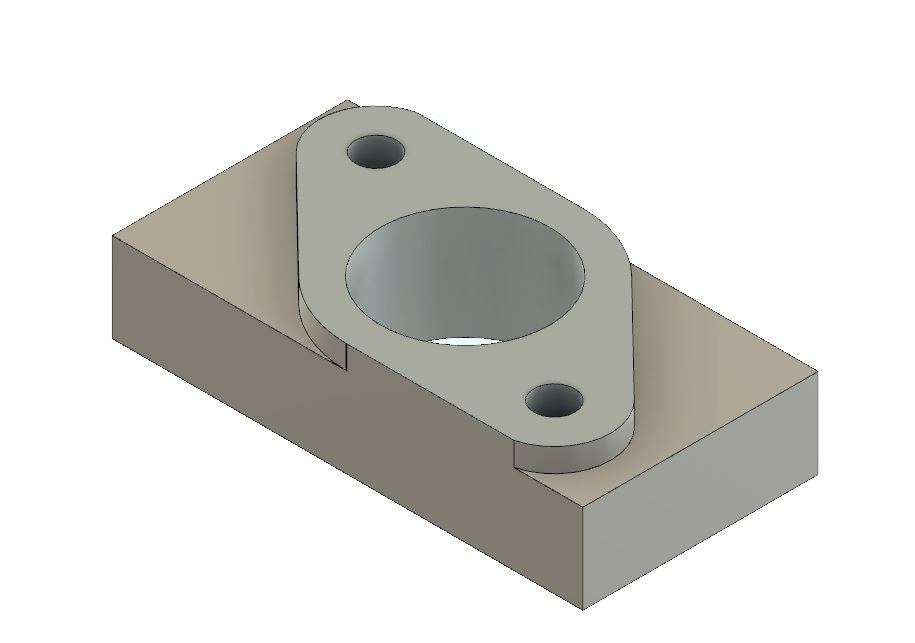

                            If the rectangle in the original drawing is not a border but part of the item then it could be it should look like this cut from 100x 50 material and then the 22.5deg angle is correct if a mating flange needs to fix to it at that angle. If that flange were smaller overall then it would not matter if the drawn part did not have tangent features

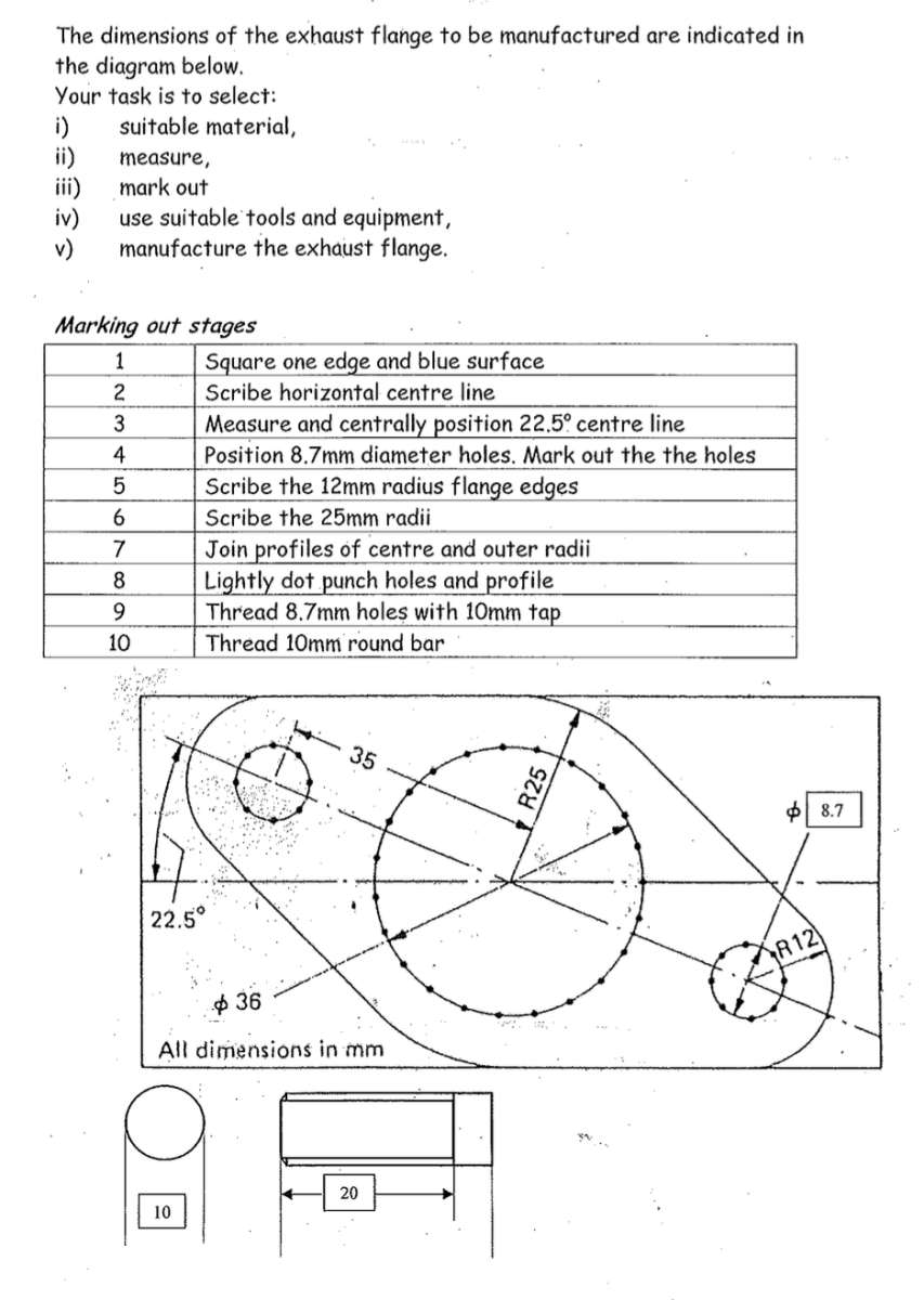

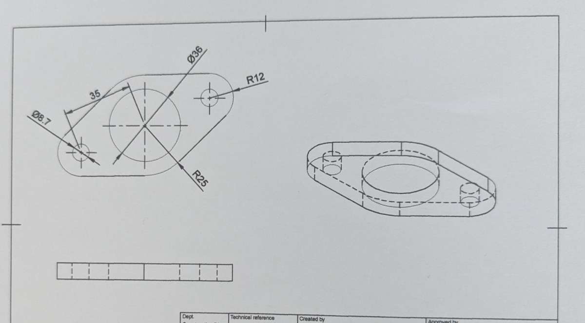

                                Thanks everyone, especially Jason. I’ve uploaded a copy of the successful drawing.
                                I’ve also uploaded a copy of the original document for those who requested it. It’s a simple bench fitting task for 1st year apprentice mechanics to get them used to using hand tools, along with some measuring and tapping. The item in question is an exhaust flange.
                                Screenshot 2025-08-20 at 10.10.55Screenshot 2025-08-20 at 09.57.31

                                  So suitable material is 2″ bar stock or the angle should be reduced. I do feel the 22.5° was chosen because it is half of 45° which is half of 90° and so can be constructed with a straight edge and compasses. The frame around the drawing should be removed (as you have done) or enlarged to allow someone to complete the exercise without worrying about the need to compromise the outline and all that is needed to draw it is paper, pencil, scale rule and some compasses. If you want to go with 50mm stock then the paper drawing would be used as a template and once drawn it could be rotated to whatever angle was needed to fit the 50mm stock. You need to decide exactly what is required of this exercise because I am sure it was never meant to be about the slight error that can be detected easily with CAD. The originator clearly thought it was not a problem but if it is just an exercise then you could reduce the 35mm dimension for the hole position to maybe 34mm or less to get it to fit inside the 50mm stock size and keep the 22.5° of the drawing.
