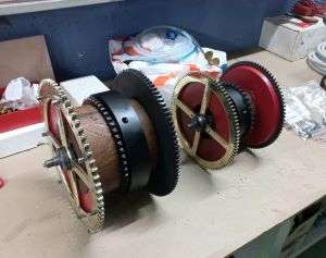

                    The Timer is a good option because it easily adapts to any winding drum diameter and height. The application of the crown around the drum must be more meticulous. I chose to cut it in two parts because it is easier to assemble.
                    20230121_193159 (002)

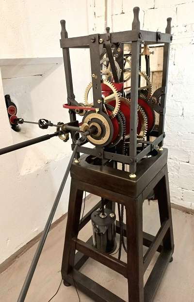

                            An example of automatic winding of the time train and the chime train. This clock was built in 1790 and during the restoration no mechanical alterations were made, everything remains strictly original.
                            20230408X

                                  However these are the advantages of the “Monkey weight” solution :
                                  1- Very simple to fit on the tower clocks without any mechanical modifications, this does not compromise  the originality of the antique clock.
                                  2- Overall weight (mass) variable by removing or adding ballast plates
                                  3- This device maintains a constant charge on the pendulum even during the weight’s ascent phase, this  feature ensures greater precision.
                                  4- The product has been industrialized to make it low cost.
                                  5- Automatic weight is supplied in Kit configuration (mechanical group, 5 meters of roller chain, sprocket wheel, 12V power supply).
