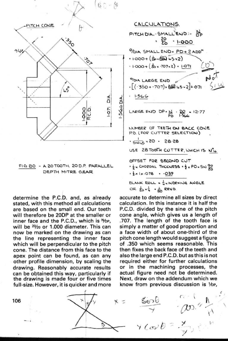

      I am building a MJ ENG 2" scale Fowler compound road loco and I am having trouble cutting the gears for the diff.
      Started with the pinions,less to mess up,and finished up with large gaps and very thin teeth.Tried both parallel and tapered depth.
      DP 8, cutter No.8, 11 teeth.
      I have read Ivan Law's book and various items on the tinter web,and suspect that it needs a No. 7 or 6 cutter. The calculations call for a No.8 cutter.
      Had no problems with the spur gears.

        #390062
          There's an uncorrected error in the book, you have to use cosine not sine in the first two calculations, which can lead to errors. Has this caught you out?
          Otherwise the method is reliable.

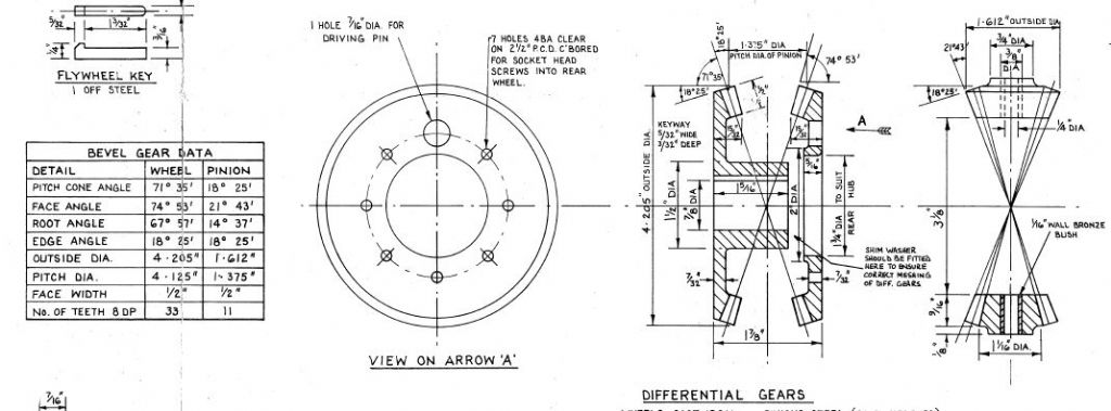

                Can we share details of the gear measurements?
                #390073
                  Should have the details here, click for larger image
                  Andrew's formula gives the 18 deg 25min that I used earlier and that is given in the table.
                  Edited By JasonB on 08/01/2019 19:44:37
                  #390080
                    Ivan Law's formula concurs, it gives 34.6 for No.4 cutter.

                          Anonymous
                            There seems to be some confusion here!
                            The drawing posted by JasonB clearly shows bevel gears with a tapered profile and the pitch diameters specified at the outer edge. So these are desgined as proper bevel gears, not parallel depth bevel gears.
                            The values given on the drawing for the pitch diameters are correct. The pitch cone angles are incorrect; they should be 18° 26' and 71° 34'. For the ODs I get 1.612 and 4.206"; very close to drawing. I haven't checked the other values.
                            For proper bevel gears with the DP specified at the outer edge the equivalent number of teeth used to select the cutter is the actual number of teeth divided by the cosine of the pitch cone angle. The equivalent values are 11.595 and 104.355 for the pinion and gear respectively. So a #8 cutter for the pinion and #2 for the gear. This agrees with the results I used in the design and manufacture of the bevel gears in my traction engine differential, and they mesh very well as shown with these prototype gears in aluminium:
                            Finished Gears
                            The calculations in the Ivan Law book are for parallel depth bevel gears. These are not the same as proper bevel gears and the same calculations for cutters do not apply. Parallel depth bevel gears are designed using a given DP at the inner edge of the tooth, not the outer edge.
                            For parallel depth bevel gears the formula for calculating the equivalent number of teeth is 2 times x times the diametral pitch, where x is half the pitch circle diameter at the inner edge of the teeth divided by the sin of the face angle. For a parallel depth bevel gear the face angle is the same as the pitch cone angle.
                            Andrew

                            #390118
                              Thanks for the insight Andrew.
                              Doing a few quick sums
                              The OD of the inner face of the pinion works out at 1.296" which for 11teeth would work out at 10.03DP and that would go some way to explaining why Dave is getting large gaps and narrow teeth.
                              If we then work with the 10.03DP to get how many teeth would fit around the outside OD that gives 16.13 say 17T so a No6 cutter. This does not agree with law's method of calculation as you get either 12T or 35T depending whether you use Sin or Cos
                              Dave, worth working it out in more detail before buying cutters and making swarf as things will need adjusting if using off the shelf 10DP cutters.
                              Edited By JasonB on 09/01/2019 07:59:18

                                        I'm slightly more, not less confused.
                                        Isn't 2 times half the PCD the same as the PCD?
                                        Also surely it's divided by cosine face angle whether working at the inner or outer end of the teeth? The difference just being that you use a cutter equivalent to a full tooth space at one or other end of tooth.
                                        Ivan uses sin back cone which is = cos face angle as they are complementary for parallel gears. His choice of 45 degrees for the example is unfortunate as not only does it mean face angle = back cone angle, but sin 45 = cos 45 = 0.707.
                                        N.

                                            Anonymous
                                              Posted by Neil Wyatt on 09/01/2019 16:39:09:
                                              Let's see if we can cure that. smile
                                              First, yes the divide by two and multiply by 2 is superfluous, but I thought I'd better quote direct from the source rather than be a smartypants and get it wrong by a factor of 2.
                                              The formula for the equivalent number of teeth for a proper bevel gear uses the pitch cone angle, not the face angle. For gears with axes at 90°, given that sin(x) = cos(pi/2-x), the two methods are equivalent.
                                              We can do a thought experiment to see if sine or cosine is correct for the parallel depth case. Let's assume that sine is correct. Let the face angle increase; when it reaches 90° then the value of sine will be 1. In which case the formula simply gives the number of teeth on the gear, pitch circle times the diametral pitch. But what's a parallel depth bevel gear with a face angle of 90°? A spur gear!
                                              Conversely if we let the face angle decrease to zero then the value of sine also goes to zero. In which case the equivalent number of teeth becomes infinite. But a parallel depth bevel gear with a face angle of zero is a contrate gear; essentially a rack bent into a circle.
                                              Andrew

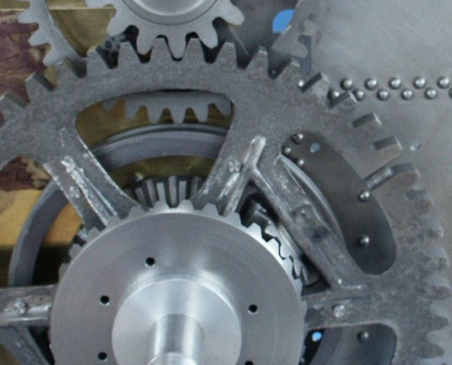

                                                    @daveshield1
                                                    Thank you for all your help. Set every thing up as close as I could and went for it. Here is a pic. of the results, certainly ok. for a traction engine not certain about my car though.
