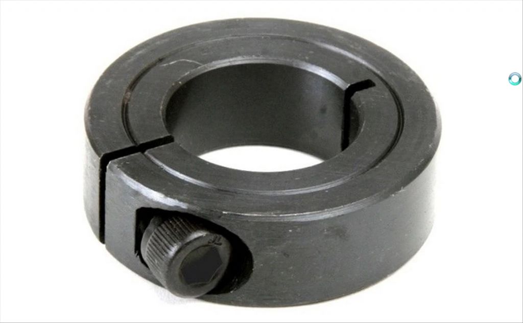

                                              Paul Lousick
                                                @paullousick59116
                                                Make a split clamp nut with a screw that closes the split. Similar to the one below but with a screw thread on the inside Knurl the outer edge for better grip.
                                                Paul
