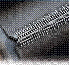

      I am making a governor for my traction engine which uses a 20mm [or 3/4"]  wide x 2mm thick flat belt from a pulley on the crankshaft.
      I need to find a supplier of small quantities of belt lacing clips to join the ends of the belt. Cannot use a continuous belt as it has to be removable.
      Lots for sale on ebay for larger sizes and in USA but in large quantities and exorbitant postage.
      Anyone recommend a supplier ?
      Paul

          Would heavy duty staples do ?
          Roy
          #558057
          Paul Lousick
            @paullousick59116
            Similar to staples but it is a power transmission belt and is stronger and joined together
            #558061
              LSM the model traction engine people do it by the 50mm length along with governor and flywheel belting. Page 44 of cat

                  The Smart & Brown model A uses a 25mm x 3mm thick belt with a join in it sucessfully, I believe the belt and joining parts came from Lathes UK. I'm not sure if a 2mm thick belt can be joined mechanically, though.

                    It is usually called alligator fastener or alligator lacing if you want to search for it. I think the manufacturer is Balata or that may be a trade name.

                      Clipper lacing is another. I have a Clipper lacer which is intended for use in vice jaws. Don't have any clips though.

                          +1 on clipper lacing. It is probably the most compact of all the metallic lacing products. It does require a tool for installation The simplest tool is used with a bench vise.
