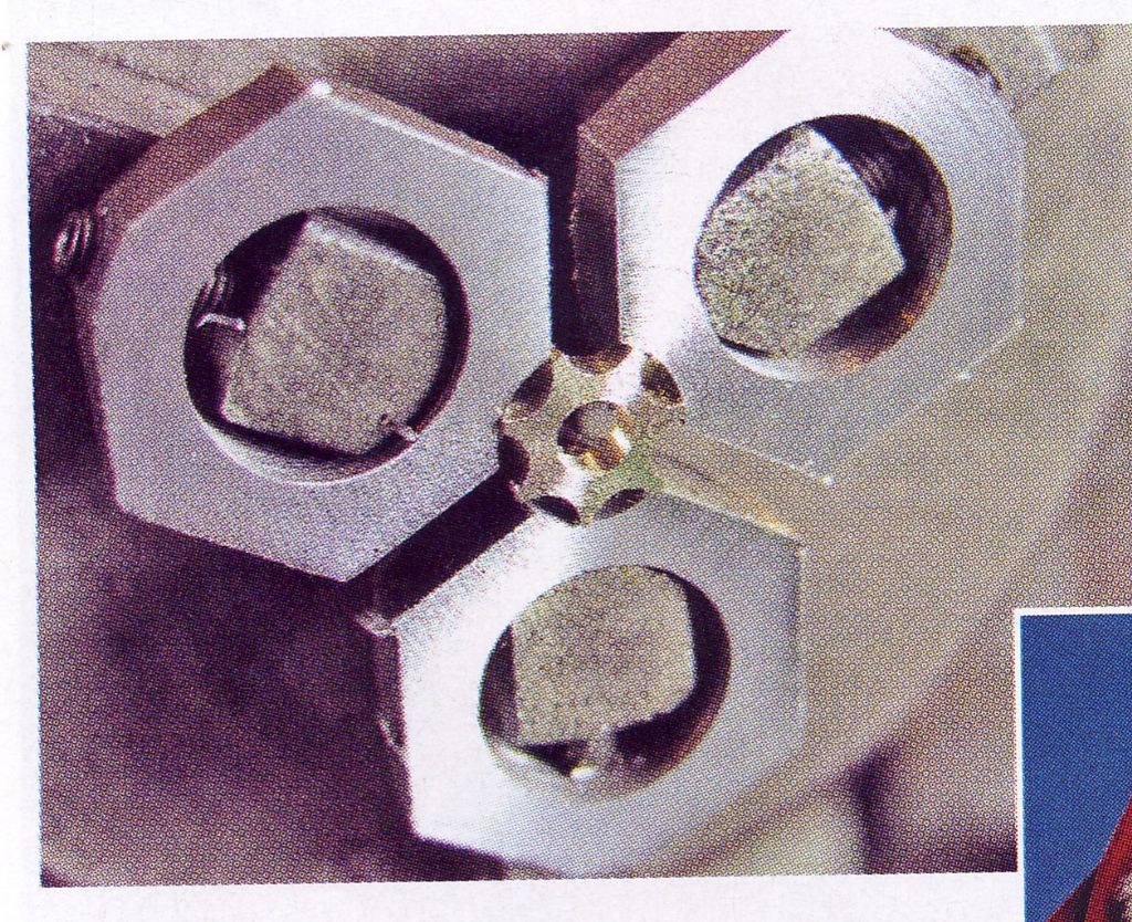

                                  3 slices off some hex ali bored to a snug fit on the ends of the existing chuck jaws work as softjaws. Drill 3 alternate corners for grub screws then use one to hold the new jaw to the old, opposite corner contacts the work. I'm sure they have been in MEW. (Edit 223 has them)
                                  Another safer option than a can is to slit a bit of plastic pipe and slip that over the work,

                                      mechman48
                                        @mechman48
                                        I made a set of soft jaws… bored out to suit job…
                                        George.
                                        #193397
                                        Paul Lousick
                                          @paullousick59116
                                          Hi George,
                                          There may be a problem with your soft jaws. They are clamped at the side and do not press against the location face of the hard jaws and may move when under load.. The soft jaws published in MEW have the screws going thru the peaked corners of the hex nuts. The jaws should be closed tightly to take out any slop before boring the hole. It clamped together the bored hole cannot pass all of the way thru, otherwise an external "spider arrangement" should be used to keep the jaws apart.
                                          Paul.
                                          Edited By Paul Lousick on 14/06/2015 13:36:44
                                          #193406

                                            mechman48
                                              @mechman48
                                              Hi Paul
                                              Thanks for your comment, duly noted; the jaws were clamped together & machined square, the lock screws were then tightened, the small hole was then drilled to size required therefore running true to the axis. Have used these on more than one occasion where I've bored out to suit a couple of pieces & so far all has run concentric, to each their own… & they work just fine for me… thumbs up.
                                              George
