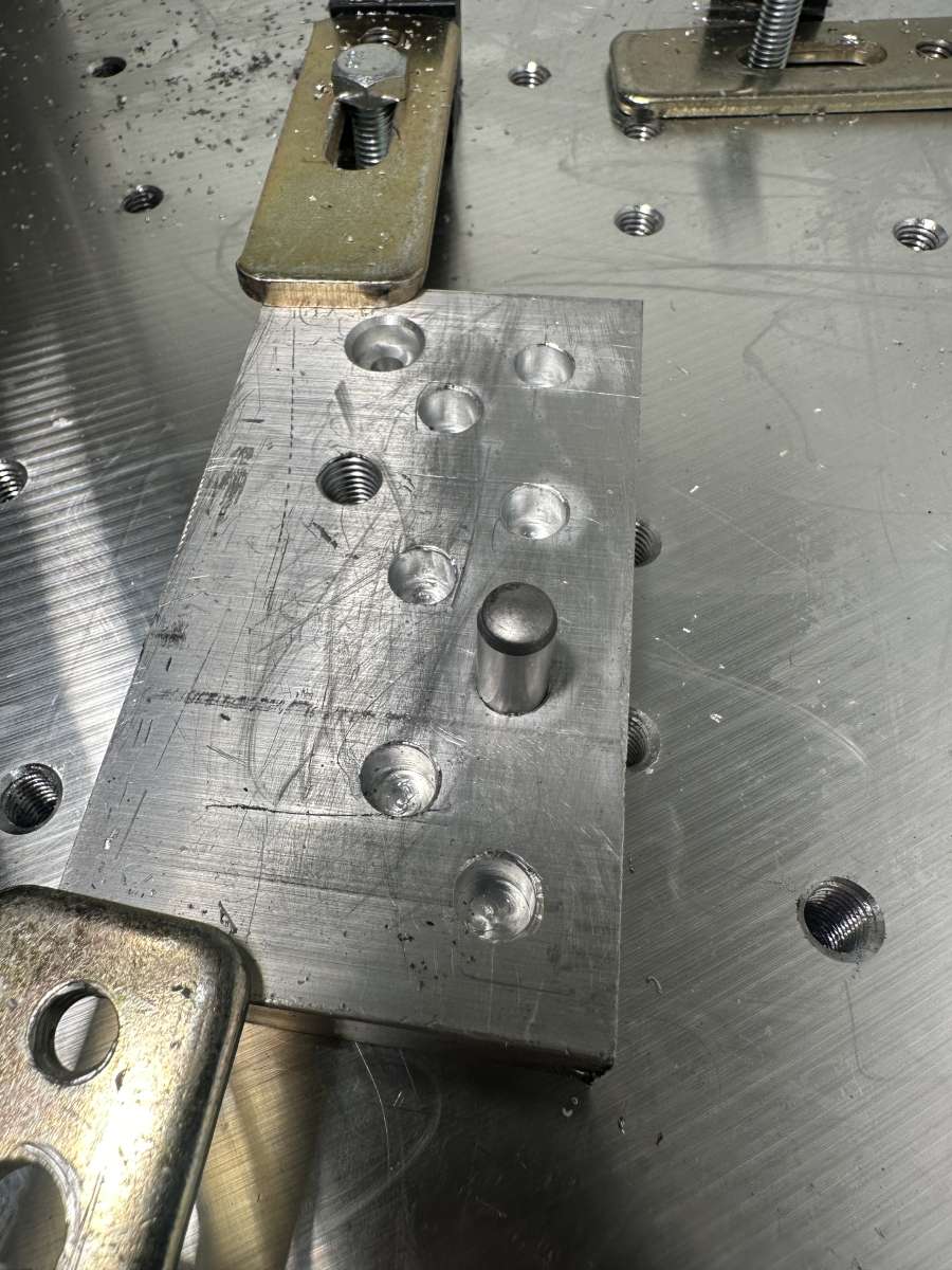

            I’ve been doing some tests on dowel pins and hole sizes. These are 8mm dowel pins. The holes, start at 8mm and increase by 1 thou as the holes go back. At 3 thou I get a tiny bit of play. At 2 thou there’s no discernible play but the dowel pins will be  tricky to get out if and when I want to do that. Any thoughts ? (Apart from about not mixing my units)

            Andy_G
              @andy_g
              2.5 thou? 😀
              (or 0.06mm, say).
              I would err on the side of keeping them ‘snug. You could always warm the bed up to get them out if they’re a bit tight.
              #756592
                Closing a drill chuck or ER collet onto them should make them easier to pull out if they are a bit tight. You can also file/grind a small flat so there is no suction to hold them in.
                #756594
                Peter Cook 6
                  @petercook6
                  Or drill a small hole all the way through the plate to let air in underneath.

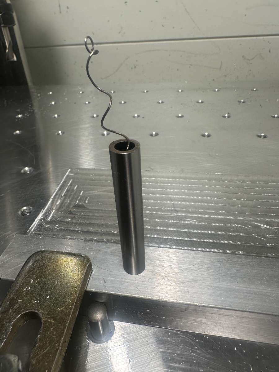

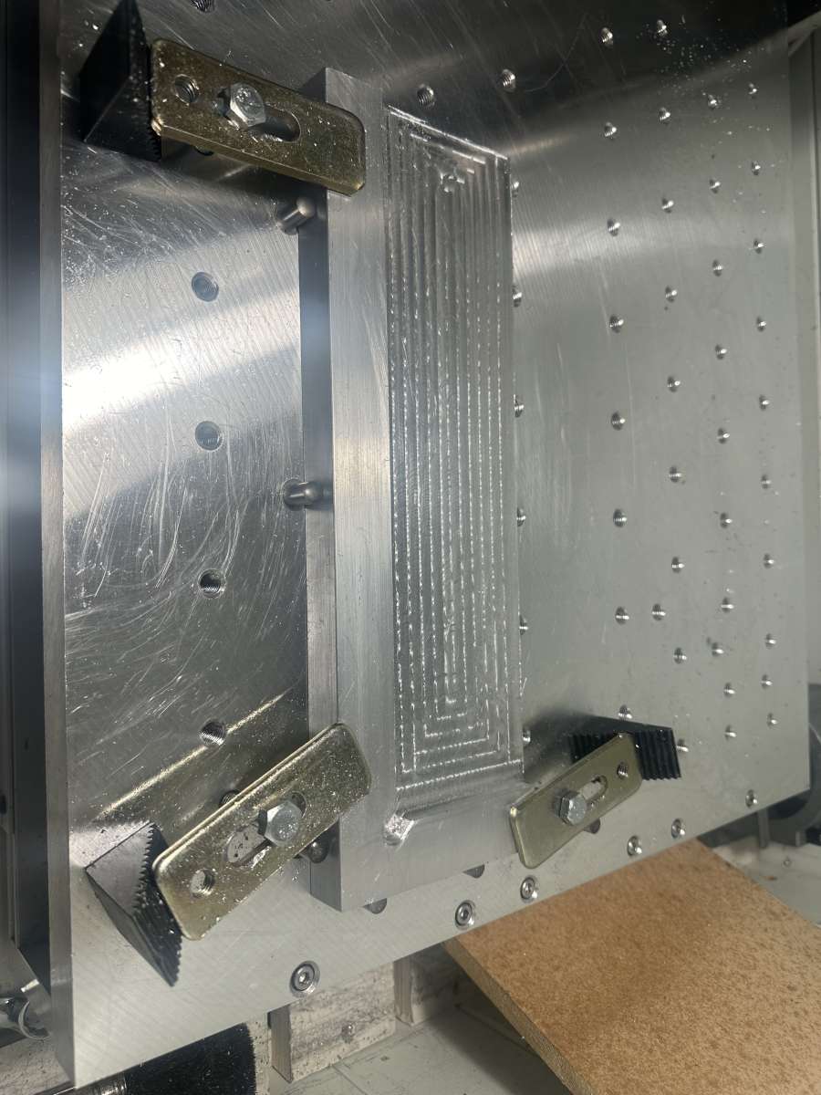

                    So I used my new locator pins to align a lump of aluminium which will be a fixture as discussed previously. However, on inspection afterwards it’s 50 thou out or so in X and Y directions. I think I have an edge locating problem.
                    I tried to use a traditional rotating edge finder. However, I discovered that when my spindle says it is running at 1200 rpm, in fact it is running at several thousand rpm. My edge finder experienced a RUD. There’s no way to slow the spindle down to suitable rpms.
                    I looked online for an electronic edge finder but they all seem to require a 20mm collet and the biggest I have is 12 mm.
                    I improvised using a Z axis electronic probe, but it’s far from ideal.
                    Does anyone have any thoughts?
                    #756851
                      What collets are you using? can you get a 1/2″ as that is what I use for my electronic one.
                      #756858
                      Steve355
                        @steve355
                        It’s ER20, and I think I have a 1/2” collet. I certainly have a 13mm one. Which edge finder do you have?
                        Pic of dead one below. They don’t like going at 8000rpm.
                        Plus also jig, now accurate to a couple of thou, which is as good I think I’ll get it without a decent edge finder.
                        IMG_5148IMG_5149

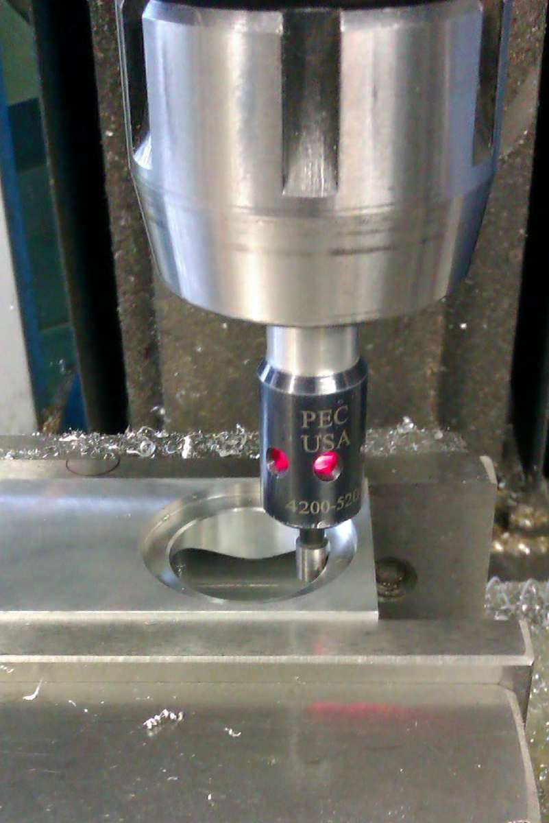

                        #756861
                          I’ve a similar one to your first photo, only needs 5000rpm to do that!
                          This is the electronic one I use. Just enter 2.54mm when you touch the edge.
                          IMAG0445
                          #756863
                          Steve355
                            @steve355
                            Looks great , and reduced price too –  4” long is quite a lot – but some bits I’m using are surely 3”. I’ll measure up in the morning and check I have the Z for it.
                            Thanks Jason.
                            #756864
                              Just be aware that there is no give if you overdo the jogging unlike the spring or probe types.
                              #756869
                              Steve355
                                @steve355
                                I have an MPG handheld jog dial thing set to 1 thou per division. I’m getting used to being careful!
                                #758139
                                Steve355
                                  @steve355
                                  Update…
                                  I got the led edge finder and it is working very well. Naturally the first thing I did with it was hit go to zero and immediately crash it. But it still seems to work pretty accurately. Great product.
