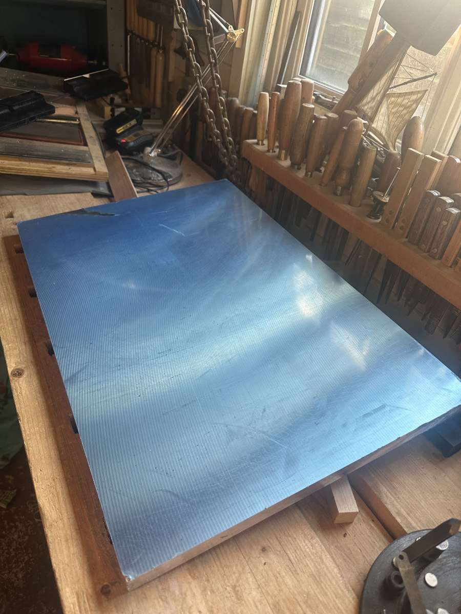

            Steve355
              @steve355
              Thanks to everyone who posted drilling videos, or sent them to me.
              My tooling plate has now arrived 😎

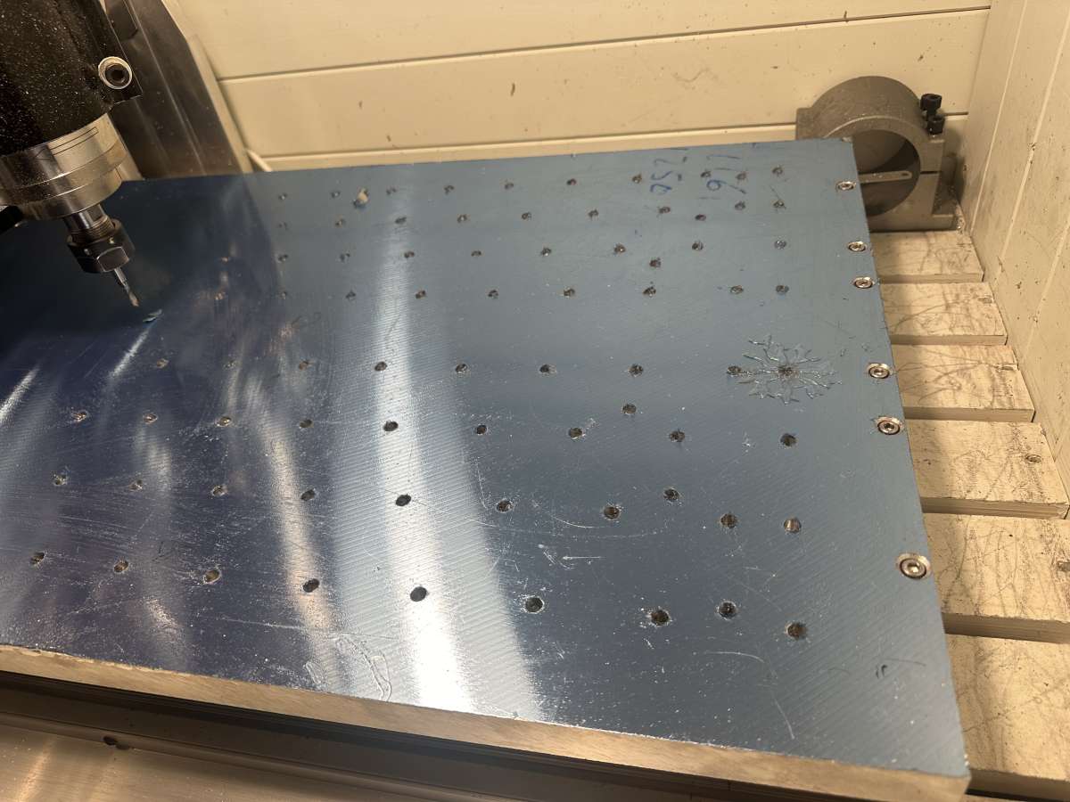

              First job is to attach it to the frame, which is much easier said than done. As I see it I have two options.
              1) use the existing flimsy bed as a template for new holes in the new plate. (hint – the existing bed is in 4 pieces which would need to be secured together very firmly. centre punch the holes and drill them on the pillar drill.)
              2) use the CNC. Unbelievably, the spindle of the CNC will actually reach all of the holes at one end. I can locate a drill bit or slot drill in one of the existing holes, and then knowing the exact dimensions of the frame, I can just have the CNC drill the 8 x 5 mm holes for me.
              Then I can turn the plate around, secure it to the frame, and run the program again. With luck (Famous Last Words) everything should be okay.
              Any thoughts? Or better ideas?!

              #753896
                let the CNC do it.

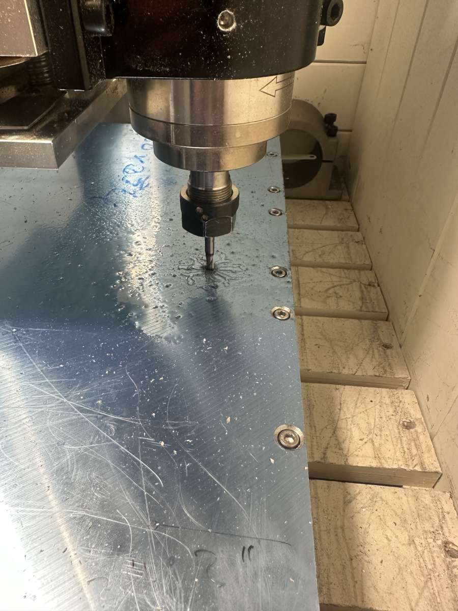

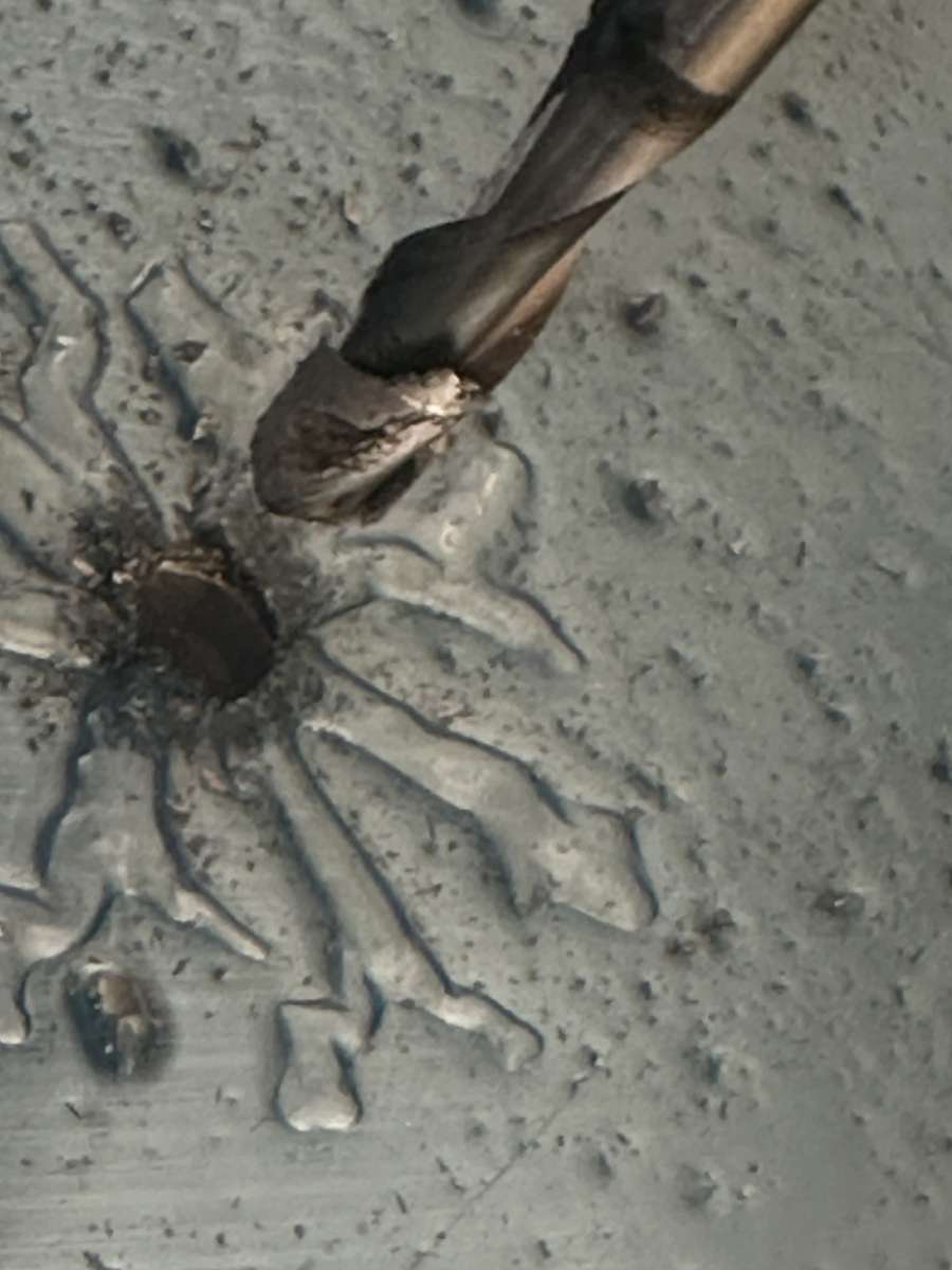

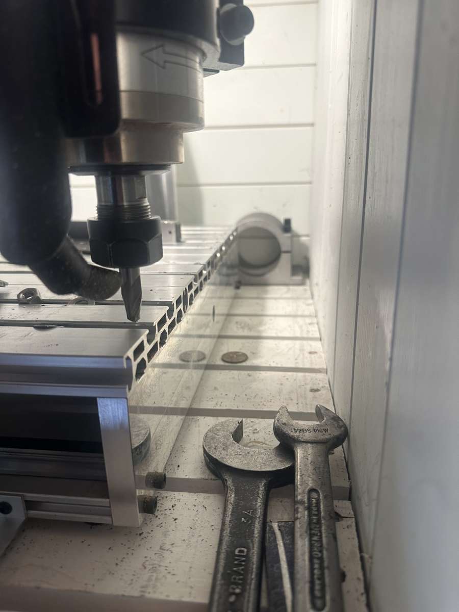

                  It was all going so well …..

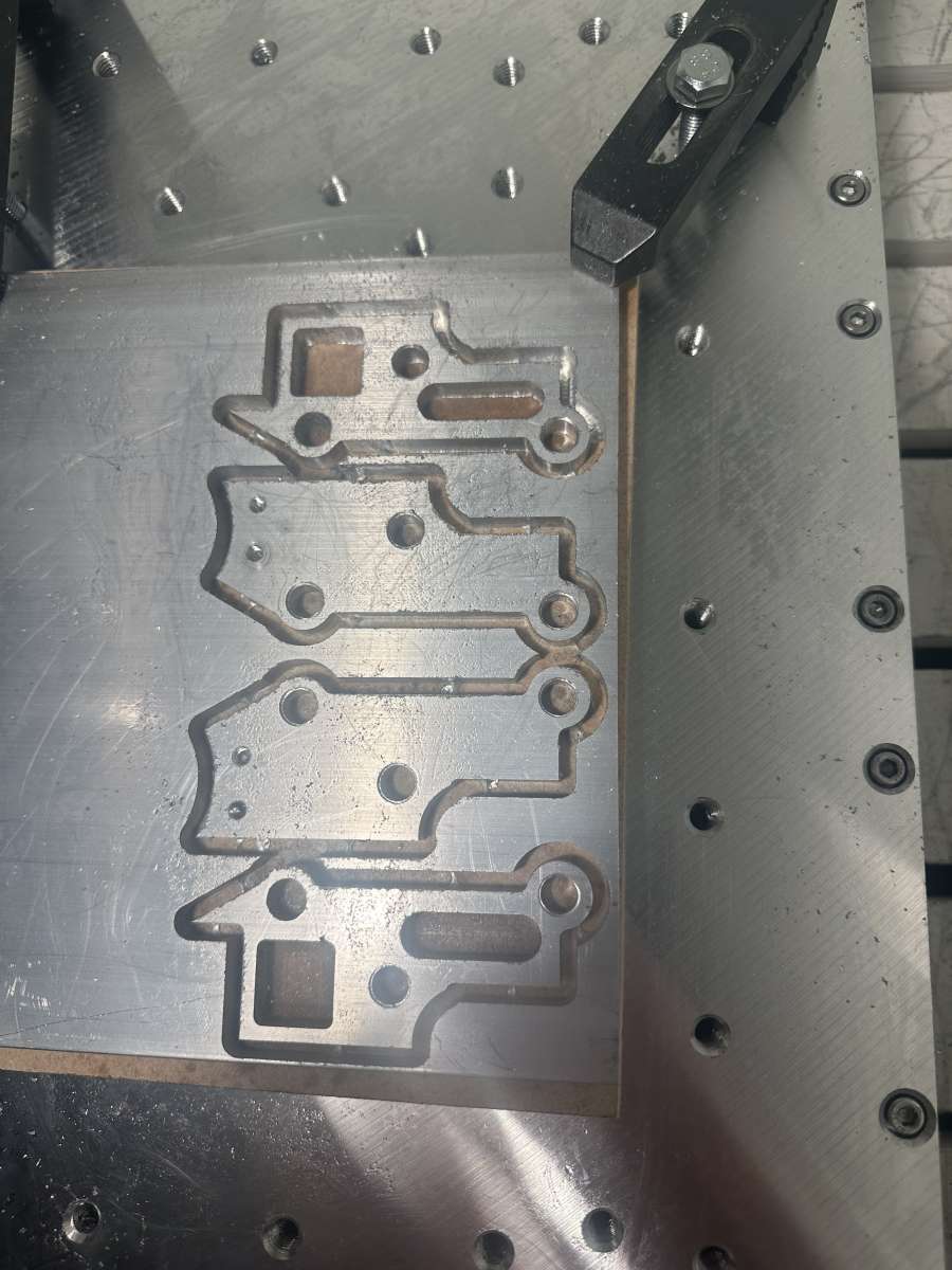

                  I have attached the new bed, went pretty well. CNC drilled pilot holes and I finished them on the pillar drill – mainly because my 4mm end mill (for 5 mm holes) was only 11mm long and the plate is 25mm thick.
                  CNC chamfered the holes and the bed is now attached and I’ve levelled it to c. 0.001”.
                  I did the CAM program for the fixing holes. However, when I ran it it went very wrong. The end mill jammed and the shed lights flickered as the VFD did its best. Either I don’t have a suitable end mill, or there isn’t enough clearance to evacuate any chips 20 mm down. Or perhaps it’s cooling.
                  Hopefully I haven’t knackered the machine. It flexed a bit but it’s done that before and seemed ok.
                  Perhaps my best bet is to get the CNC to drill a bunch of say 8mm deep pilot holes and finish it off on the pillar drill.

                  #754377
                    So you have opted for M6 fixings hence the mention of 5mm holes or are you going for M10 as you mention 8mm?
                    There is really no need to go to full depth if you are using M6, 2D would be more than adequate, even M10 you would only need go 20mm deep. the advantage of a blind hole is you won’t drive a stud or screw too deep and jack the plate up off the bed.
                    A good air blast will help get the swarf out the hole, if you can pump cutting fluid into the flow even better as that will help stop material sticking to the tool, look at “fog Busters” Slowing things down will also give the swarf a chance to get out the way. Uncoated cutter specifically for aluminium with more helix angle will also help.
                    And don’t forget that when using a milling cutter to bore at just over it’s diameter the feed rate is far greater as you G-code is based on the axis of the tool not what the edge of it is doing.

                      #754390
                        You don’t really need a lot with the fog busters, 10-25mls per hours running will all stick to the swarf. Have a look at This thread on MEM
                        What you have squirted at that one hole will be more than that over an hours use.

                        Steve355
                          @steve355
                          Thanks Jason, I will take a look
                          Holes all milled now to 10mm, I think in the morning I will extend to 20mm using a hand drill, tap, then use the CNC to chamfer.
                          Then the really exciting bit which is peeling the blue plastic off.

                          Andy_G
                            @andy_g
                            You need to get the chips away from the cutter. A small jet of compressed air helps enormously – 3 or 4 PSI is enough. (The brass tube in the photo.)
                            I use a small amount of isopropyl alcohol (IPA) entrained in the air stream as a lubricant for aluminium as it dries to nothing (be aware of the potential fire risk though).

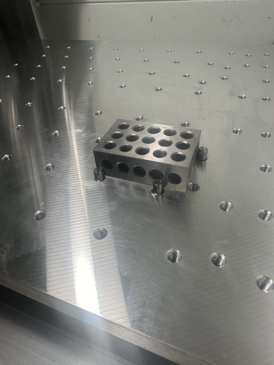

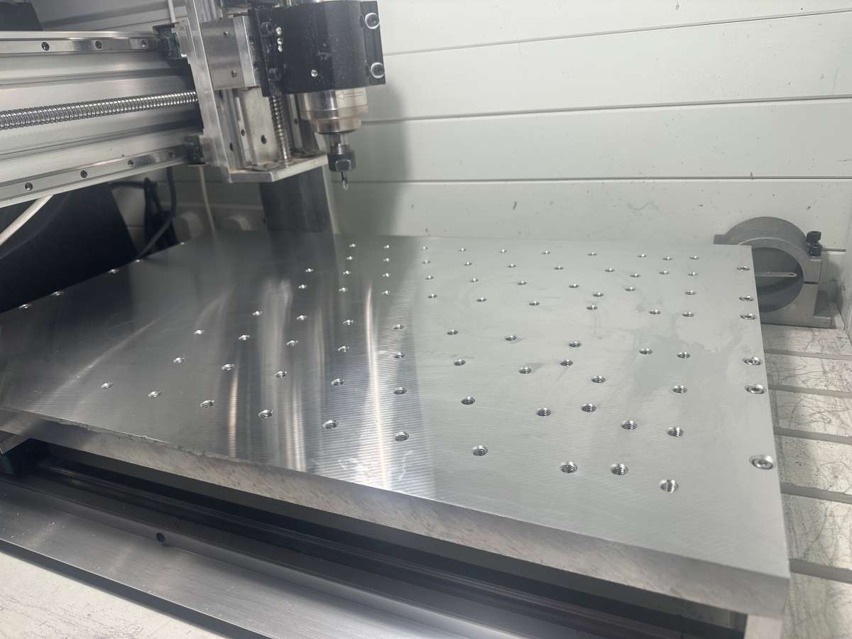

                                  Anyway, I’ve done it, drilled, tapped, chamfered. Overall it seems pretty good
                                  IMG_5123
                                  my only concern is that the threads, which were tapped using a drill, may not necessarily be straight. I was really hoping to use these as reference points. Looks like I’ll have to do some experiments with a DTI to see how much I can rely on it. I expect that’s why thread milling is a good idea. But I don’t have the knowhow for that.
                                  IMG_5124

                                    A few plain dowel pin holes would be better which I think I suggested earlier, you need a bit of wobble room for the thread if it is not to gall so there will be some minor movement.
                                    Datron use IPA on their machines to good effect, probably have extraction on the cabinet, would only really need a vent as the compressed air going in would carry any fumes with it as it vents out.
                                    Don’t know what CAM you use but thread milling is fairly easy with F360
                                    Edit, just had a thought if you make your pins with a slack thread an dunder cut it to join a short 45deg chamfer then they should find their position against the milled chamfer in the plate and pull themselves true. Bit like the bolts that hold the wheel onto your car, the holes are slack but the chamfers pull the wheel into position.

                                      You could machine a shallow counterbore in some/all of the holes to take a hollow dowel that’s secured with a screw through the middle into the remaining threads.
                                      No matter how you cut the threads they won’t provide accurate location on their own – it always needs another feature.

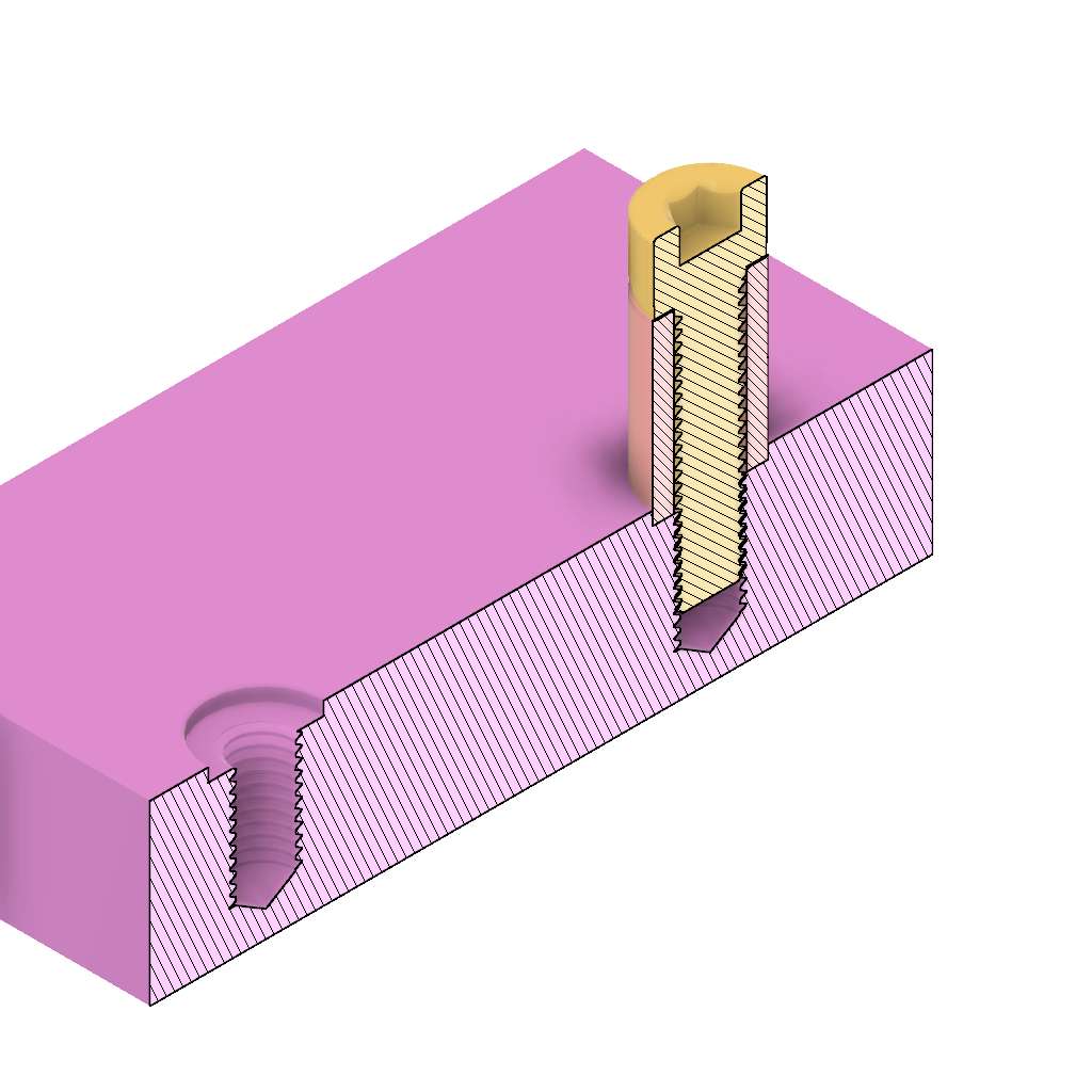

                                                  This is the arrangement I was thinking of:
                                                  Dowel2
                                                  The ‘dowel’ has been increased to 13mm dia so that the M8 fastener head doesn’t overhang it.
                                                  Not sure that it would help with your specific situation though.

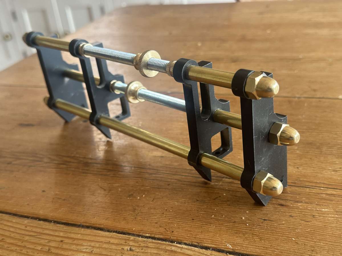

                                                    Project report… a bunch of dowel pins and lump of aluminium turned up yesterday for making a jig and creating some location positions on the table. So that will be the weekend’s project 🙂
                                                    The new bed I made has so far proved to be highly effective, I’m getting excellent finish on milled aluminium. It’s difficult to see from the picture below that the finish is good, but trust me there is very little or no chatter. So far my bed seems to be a good investment.
                                                    one thing I do need to work out, is how to paint aluminium to a professional standard. I have some etch primer and some spray paint which claims to be  “strong”. It’s not good enough so far.
