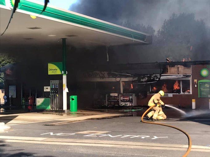

                                                Mike Poole
                                                  @mikepoole82104
                                                  This was our local filling station when an aircon unit in the shop caught fire and gutted the shop. I take my hat off to the firefighter in the picture and the shop staff who kept their heads and implemented the shutdown in event of fire procedure, I would have been the guy showing Usain Bolt a clean pair of heals.
                                                  Mike
