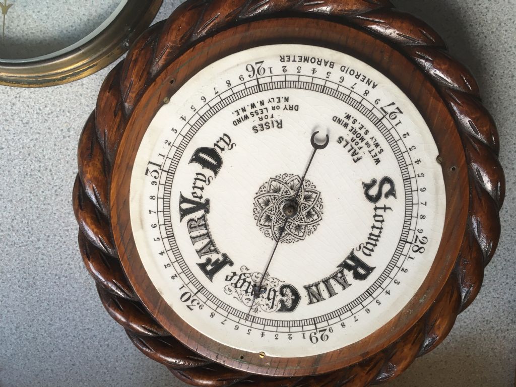

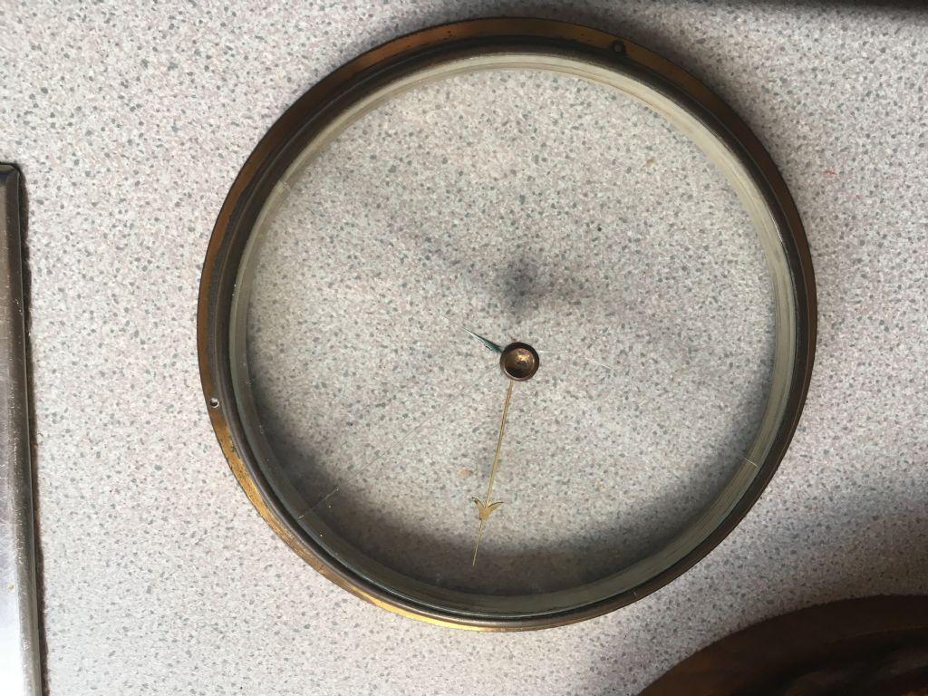

        Hi All, I have been tasked with assisting to replace the glass in an old aneroid barometer. The glass itself is not a real problem its flat plate with a bevelled edge.
        However removing it from the metal bezel is a problem so wondering is anyone knows how to do this ?
        It appears that the outer metal rim is rolled over the glass or the inner is pressed onto the outer thus holding the glass in place ???

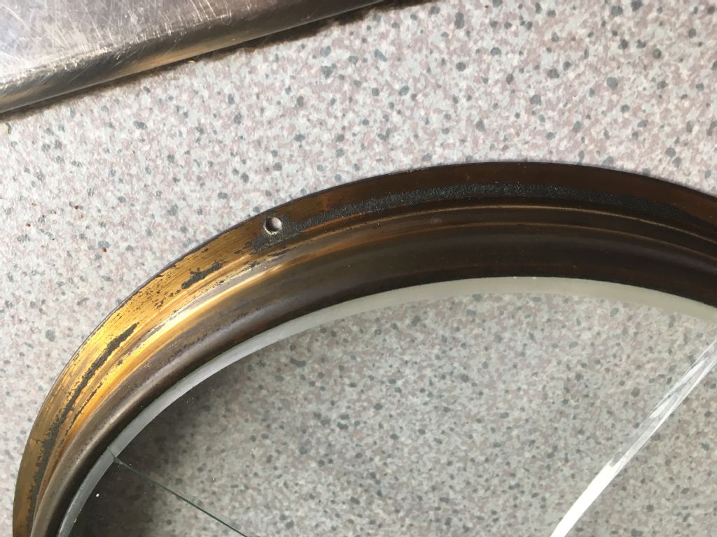

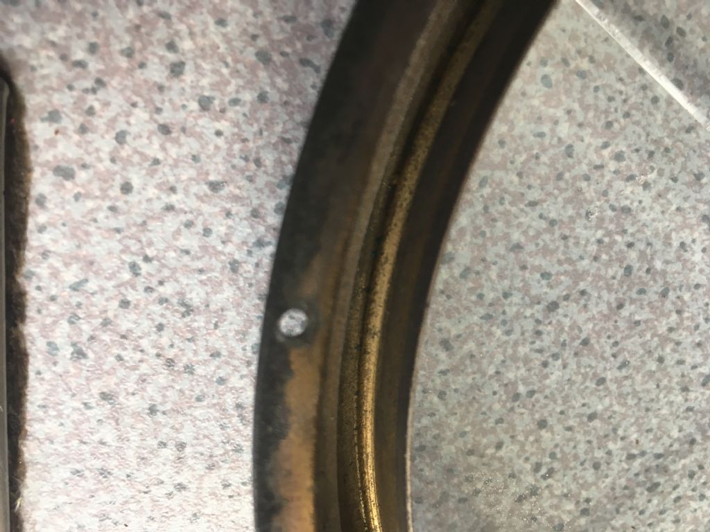

        The photos are of the complete glass and mount plus a closeup of the outside where you can see the rolled over edge and the inside where it seems the inner ring is pressed onto maybe an upstanding on the outer?
        Any info gratefully received before I/we attempt to remove the broken glass.
        Cracked glass
        Outside of rim
        Inside of  mount
        Barometer face

          In picture 3 is that round looking brass a circlip type ring holding the glass In ?
          #344228
          Scrumpy
            @scrumpy
            Some 20+ years ago I used to work part time for a barometer restoration company their were many ways that the glass was held in place some had a brass circlip some just putty and some small clips that were fixed to the bezel and bent we used to remove glass and replace with metal putty be very careful that you Don't buckle the bezel as they are a pig to make ( I had to machine 4 in a day )

                Thanks for the reply's — Brian its not a circlip but not easy to see that in the photo, it is a rolled edge or that's what it looks like.
                Scrumpy your spot on with the putty, I have now removed the broken glass — nice flat surface for the bezel and firm pressure on the glass using suitable hand protection — a thick wad of paper !! the glass popped out.
                When I looked at it I guess I was over thinking it and imagined the glass under the top rolled edge and the inner ring holding it in place — close examination and Scrumpy's advice – the rest is history — Thanks gentlemen!
