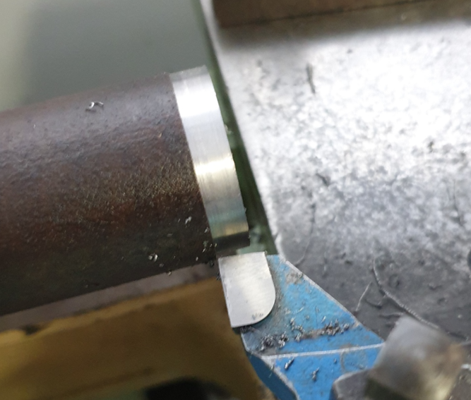

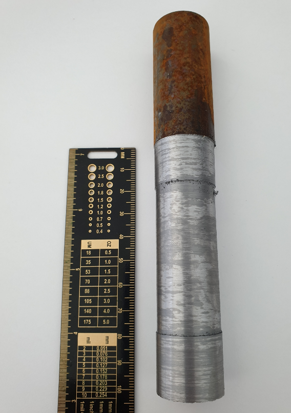

          Today I tried to turn something for the first time. I used a 20x200mm stainless steel bar. I started with a carbide brazed tool. I cut 20 microns each pass. Three in total. The feed was manual and very slow. The result was an uneven surface. There is a pattern in the diameter variation. Especially in the left half. You can also feel it when you touch the surface. The speed was 200rpm maybe. It took some 2 minutes each pass. The metal chips were very long, some were more than half a meter.
          I switched then to a HSS tool. I made two passes removing 20 and then 10 microns. That strange pattern didn't appeared again this time. Also I used auto feed. I figured out how it is working. There are two ways to enable it, using the lead screw or one of the additional rods, but this is another story. Each pass took 2-3 min.
          Now the surface finish is much better. The difference in diameter between the ends is 30 microns.
          Why I had such bad results with the brazed tool? The tool was sharp.
          #638245
          Hopper
            @hopper
            Carbide tooling does not have as sharp an edge as HSS, so it requires more force to cut, which puts more pressure on the job. This causes the job to deflect and give poor cutting and poor finish. Your test piece is a bit too long and too thin at 20 x 200mm. Usual standard is 25mm x 100mm, or maybe 150mm maximum. Also stainless steel is often problematic to machine nicely because of work hardening on light cuts where the tool rubs.
            It looks like you have achieved a good result in the end. Good stuff!

                    This morning I went to the local Sunday flea market and I found exactly what I needed, a few short pieces of 25mm steel bars. I made the dumbbell test with one of them:
                    I cut the bar up to 7mm close to the chuck. The last cut to the two wider sections was 20 microns deep. The difference in diameter between the two parts is 10 microns. I made repeated measurements. Is this good enough? Does it make sense to try to make it perfect since anyway the lathe stands on 3cm wood boards?
                    This time the surface feels like a very fine thread, even if the feed rate was very slow. I think that the HSS tool is no longer sharp. And it has spots, maybe from the oil? It wasn't hot and there was no smoke.

                      Or maybe not! The problem is you have no idea what the specification of the steel is, and it matters. Not all steels, perhaps the majority of them, don't machine well. Unidentified scrap might well be difficult to cut, or to get a decent finish. And some of them are vile, best avoided!
                      For that reason I recommend beginners start by buying some suitable metal. In the specification look for 'Good' or 'Excellent' Machinability, or 'Free Cutting'. Of the mild-steels, EN1A-Pb (aka Leaded EN1A), is the best. EN3A is OK, but prone to tear and smear.
                      Exploring a new-to-you lathe three factors can confuse the hell out of a newcomer. They are:
                      1. Difficult materials (plenty of them about)
                      2. Tool faults, from blunt cutters, to malfunctioning machine
                      3. Operator error. There's a lot to learn, including how to recognise trouble caused by the first two!
                      At the outset, best to eliminate as many unknowns as possible because doing so makes it much easier to work out what's going wrong. Almost the worst case is a totally inexperienced enthusiast buying a lathe in unknown condition, sticking a bar of flea market metal in it, putting a random second-hand cutter in the toolpost, and ploughing into the metal without understanding the need to get the tool-height right, or that feed-rate, depth of cut and cutting fluid all make a big difference. This means reading books (I recommend Sparey), asking on the forum, getting hold of some decent metal and sharp cutters, and then experimenting for best results. You have to get a combination of things right – parting-off is great fun. Much easier with a mentor because they instantly spot baffling mistakes, otherwise set too and try different exercises to find out what works or not! Quite difficult at first. but gets easier once the eye, ear and brain know how to recognise trouble.
                      There's much to be said for starting to learn on Brass. Most Brasses machine well, which can't be said of steels, aluminium alloys, Bronzes or Copper. Magnesium alloys machine well, but a bit too exciting if the swarf catches fire…
                      Your dumb bell accuracy isn''t too bad, and the poor finish may be because the metal doesn't machine well, especially if the tool is blunt or the wrong shape. No need to worry yet, unless the same thing happens to a practised machinist with known metal, and everything set up optimally.

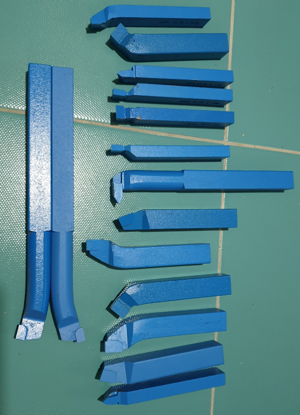

                        Actually last week I ordered The Amateur's Lathe by H. Sparey from Ebay smiley And a few more.
                        So far I avoided buying steel from suppliers. All companies are selling only 6m long bars. And most of them don't cut it to shorter lengths. So I have to pay a big truck to bring one single bar… The local hardware stores in my city can cut the bars to any length but the diameter is less than 10mm usually. Plus they have no clue what type of steel they are selling.
                        A few weeks ago I bought a 5m long bar of stainless steel (20mm). The one that I turned yesterday. That one was from a private person and he was willing to cut it in 3. That material is much better that the steel bar that I bought today. But I think it is much harder.
                        I was surprised how expensive is brass. Almost 8 times more than steel. Brass is available in smaller lengths but it make sense to buy it only when I'll have a project in mind, not for random play. I think the best choice just for tests is aluminium. It comes in 3m long bars and many choices of diameters for 6082 type alloy. This is a "highly machinable grade of aluminium".

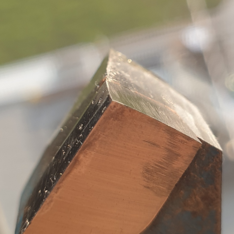

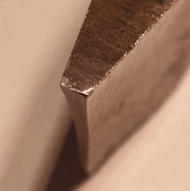

                        The stainless steel bar from yesterday "killed" the HSS tool:

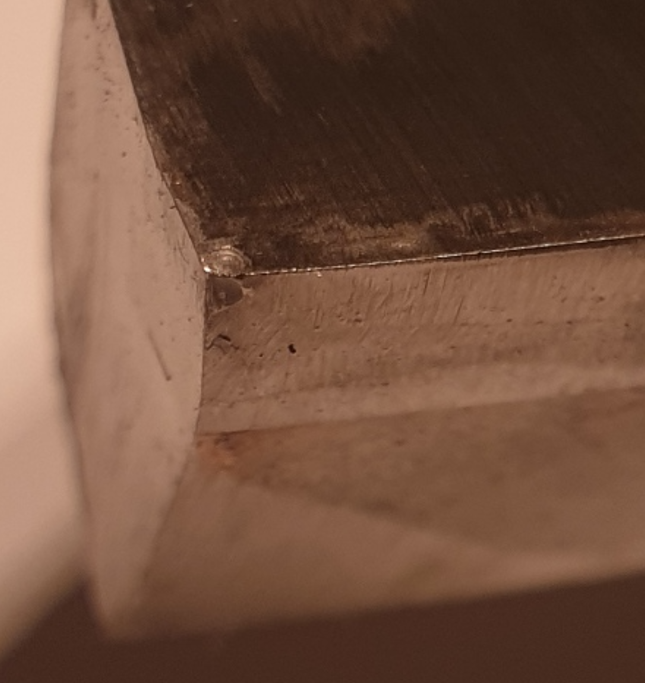

                        And the brazed tool is missing a tiny spot also:

                            Stick with HSS tools.
                            Youir pictures show that the tools are not correctly ground and have suffered damage as a result.
                            If in doubt, tun at too low a surface speed, rather than too high.
                            As already said, moulded carbide tips are not as sharp as a properly ground a HSS tool and chip more easily.

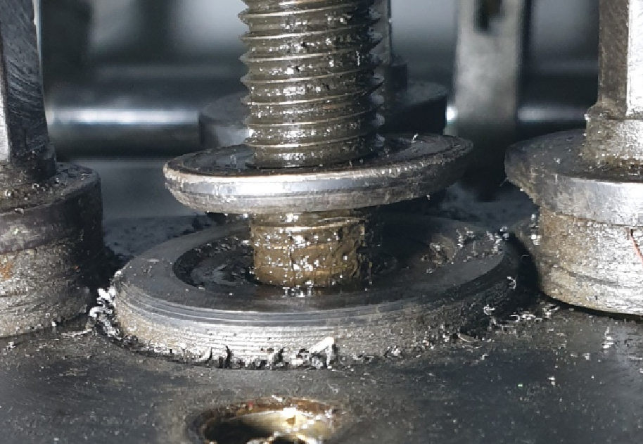

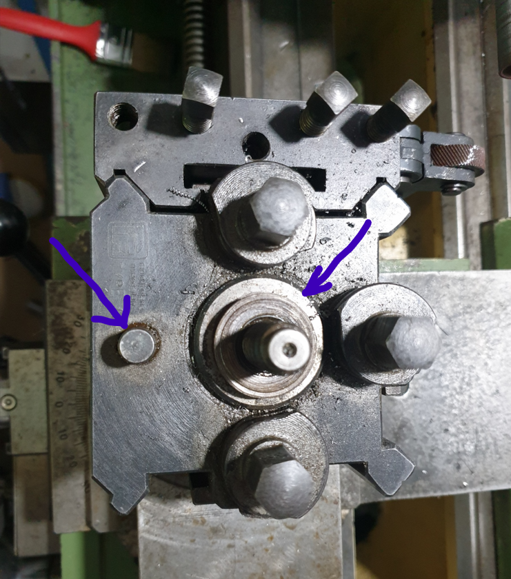

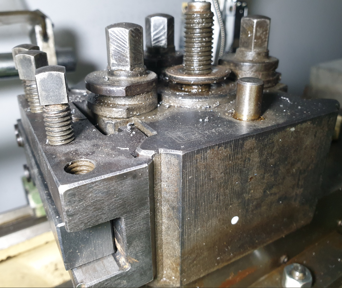

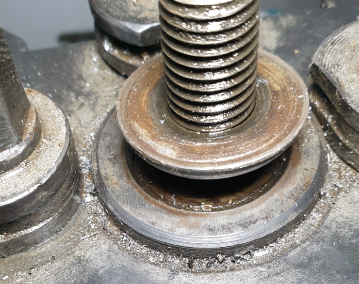

                                I paid more attention to the tool height this time. There is no need to add shims, the QCTP of this lathe allows you to lock the tool at any height. I measured the diameter of the bar with the caliper. Then I used the calipers depth measurement rod to set the tool to the half value of diameter.
                                Also I fixed the tools. My grinder has a slow speed wet grinding wheel. It was very easy to repair the HSS tool. For the brazed one I bought a special grinding wheel. I tried to keep the original angles for all faces. Now both tools are very sharp. I turned again the same piece of metal and the difference in surface finish is significant! With both HSS and brazed carbide tool the surface feels smooth. The third tool, the one with carbide indexable insert produces a horrible surface.
                                While grinding the tools I noticed the significant hardness difference between HSS and carbide. It took almost ten times more to grind the brazed tool. Even if the wheel was spinning faster. But in the end I think you can make the carbide brazed tool as sharp as the HSS ones.

                                      Posted by Jelly on 21/03/2023 17:18:01:
                                      Posted by Sonic Escape on 21/03/2023 15:57:44:
                                      I wouldn't be too discouraged, there's a whole world of complexity when it comes to insertable tools, and selecting the correct insert for the job is a whole other skill-set to learn, generally inserts for Stainless are a different grade and chip-breaker design to those for normal steels.
                                      Thank you for the info about the inserts. Those types look like a good starting point. I'm not discouraged, actually I found interesting the complexity of so many variables when it comes to inserts. But I'll dig into it later. So far I got some 20mm brazed tools. I picked P30 carbide type since I understood that this is less prone to break. But even so one tool was poorly packed and is missing a small piece.
                                      I couldn't help myself and bought another 2m/40mm unknown steel bar. And a 0.5m/60mm one. To my excuse, they were only 1km away. I wanted to quickly cut one slice to try it just before going to sleep. But it took me at least 15 min to cut the 40mm one with a miter saw! There were 2m of sparks, my ears were ringing and I almost set the garage on fire in the process with a nearby plastic bag. And I supposed I woke up everybody again. But this metal is not so bad.

                                          You mention a wet wheel to grind your tools, for the carbide tipped tools you need a Green grit wheel and/or a diamond wheel, both of these are normally used dry.
                                          Emgee
                                          #639224
                                          Sonic Escape
                                            @sonicescape38234
                                            I have a green wheel. Is interesting that to grind carbide you need actually a softer material that regular grinding wheels. I used it to fix a brazed tool that had a small dent. There is a picture in a previous post in this tread. I was looking also for a diamond wheel but I couldn't find any reason to justify the price. The green wheel was enough to make the tool sharp again.
                                            #639226
                                            not done it yet
                                              @notdoneityet
                                              There is sharp and there is properly sharp! What may look like it is sharp (would cut you) might need a very much finer finish to the cutting edge. Look up ‘honing’.

                                                Today I tried a knurling tool and I noticed that the tool post is rotating. I didn't pushed the knurling tool to much. But there is something wrong with this QCTP. There is no locking mechanism. That central screw has a big nut (removed in the picture) and that's it. There is a large pin marked by the arrow in the left. I can pull it out. But there is no corresponding hole in the compound where that pin to enter to stop the QCTP from spinning.
                                                What is even more strange is that I can't lift the tool post. I remove the nut but the washer (right arrow) can't pass over the threaded part of the screw! How was this tool post mounted in the first place?!
                                                #640169
                                                Sonic Escape
                                                  @sonicescape38234
                                                  Now I noticed that I don't have the original QCTP:
                                                  #640171
                                                  DiogenesII
                                                    @diogenesii
                                                    What is that under the nut – it doesn't look like a plain washer?
                                                    #640178
                                                    Sonic Escape
                                                      @sonicescape38234
                                                      It is a thicker washer and it fits exactly in the tool post. It clearly is part of the tool post. I was able to lift it a few mm by rotating it like a nut. But now it is stuck. I would have to use a plier to rotate it further. But it doesn't look right.
