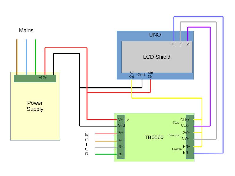

                Another one having ago at the mew249 arduino project to run my rotary table.
                I have looked at all the usual suspects blogs and forums but I cant get the stepper motor shaft to rotate.
                makes all the right sounds but no shaft movement. Tried 3 different sketch stepper motor programs but all the same result.
                Checked motor wires and researched that…tried another controller board but still no joy.
                The only difference I can see is i am powering the UNO and LCD shield via the USB cable.
                photo below.
                Thanks Matt

                              Matt, I agree with Dave it looks like there is no ground connection. This is my version of wiring up the bits…
                              Hope it helps, also double check the motor windings are correctly paired. It doesn't matter whether connected to A or B provided it is the right pairing they should also be in the same direction. Look at the motor specs for the colours.

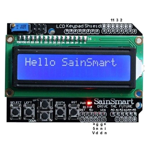

                                Thanks John…where is the ground connection on the Shield.
                                looking at other peoples images I can see they have connected it just under the VIN lettering along with the 12v cable. Thought I might not need this been as power etc is coming from the USB lead for now.
                                PS have been following your diagram since I looked at your website again recently.

                                  Managed to find something on the connector pin out…might be useful…Thanks Matt

                                    You will still need to ground the Arduino and driver so that the signals to the driver are referenced to a common point.
                                    You can solder your ground directly to the Arduino on any of the ground pins or directly to the 0 volt pin of the power socket.

                                      Matt, I connected my power direct to the UNO there is a group of four pins [5v out],[Gnd],[Gnd],[Vin] in one group. If you go down the page on my website there is a link to the UNO pinout diagram. I am not sure it's a good idea to use two seperate power sources in normal use. I use the USB if re-programming (without the motor connected) but use just the 12v supply to run and test.

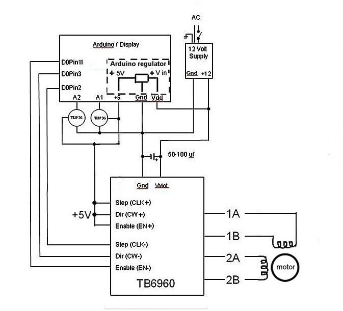

                                          Hi Matt
                                          your wiring looks OK but you can do away with the USB cable by connecting the stepper drivers 12V supply to the ground and Vin terminals on the arduino
                                          ( the 5V regulator on the Arduino will drop the +12V down to +5V )
                                          did you get the arduino to respond to the buttons correctly ?
                                          from what I can see is the various manufactures don't stick to a single design for the boards they manufacture
                                          and for the LCD / button shield the variations in resistor values in the button ladder results in changes being needed to the sketch
                                          ( note not all LCD + button shields can use PWM brightness control for the backlight !! )
                                          see this posted by sillyoldDuffer
                                          http://www.model-engineer.co.uk/forums/postings.asp?th=122792&p=4

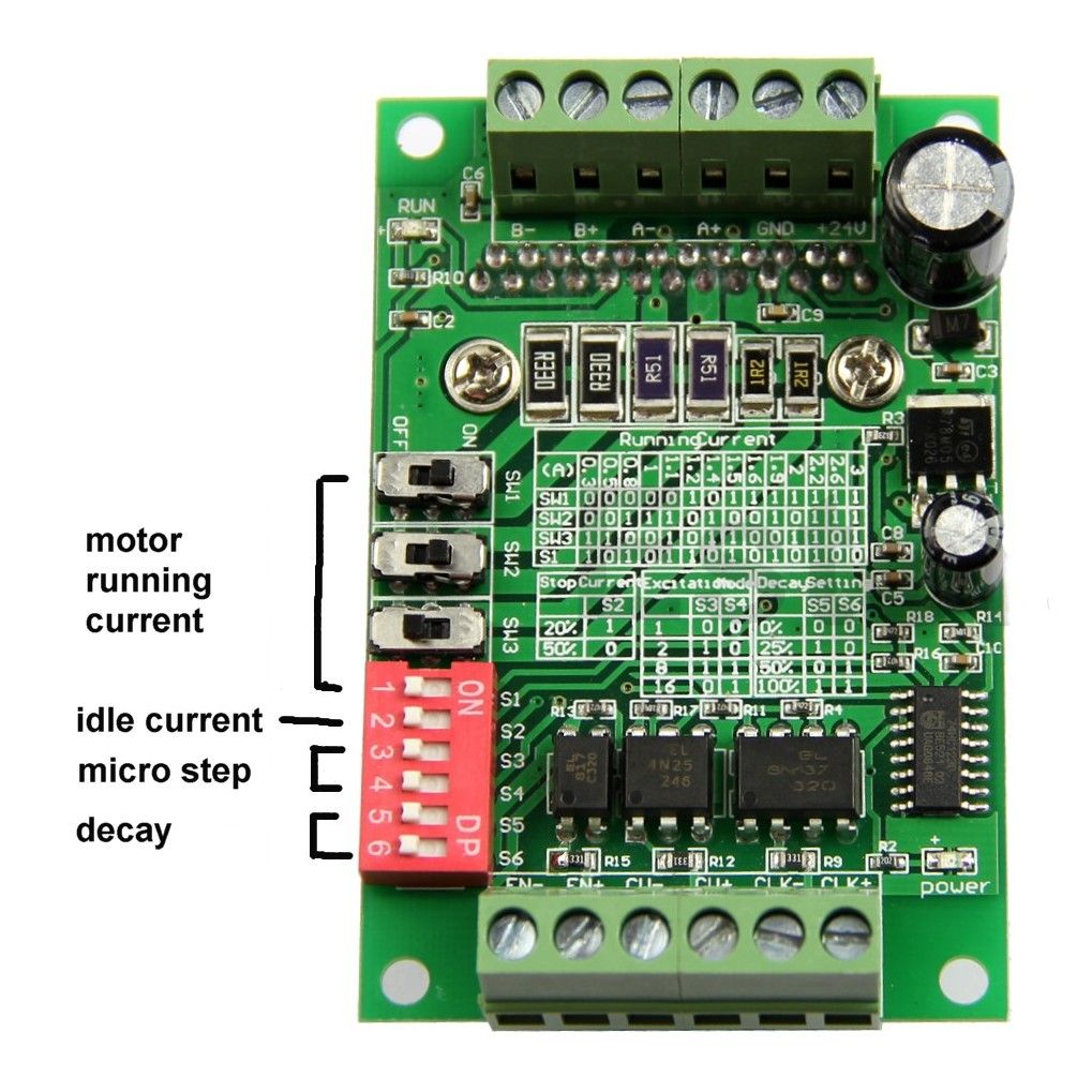

                                          the 4 switches that control  the motor current (SW1 to SW3 & S1) will need setting up fpr your motor
