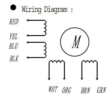

                      Carl Wilson 4
                        @carlwilson4
                        Fortunately for all of you Neil Wyatt was smart enough not to use my author photograph.
                        How apposite that you should talk about what motor I used because I was just about to post on that very subject.
                        You'll notice in some of the pictures in the article that the stepper I have used has eight wires. You can find it here:-
                        **LINK**
                        This was down to it being the only one I could find with a double ended shaft that I have signally failed to make a manual operating handle for. It is very simple to wire this motor. The coils must be connected in series to ensure the motor draws 2A. In all other respects the motor will then behave as 4 wire, i.e. 12V 1.89Nm holding torque.
                        This diagram comes from the motor data sheet:-
                        So to make this 4 wire and 2A connect yellow to blue and orange to brown. Then red, black, white and green are connected to the stepper driver board.
                        Zapp Automation (and other vendors) also do a 4 wire 2A motor with a single shaft. I made the connections and then heat shrank them inside the protective braiding.
                        Carl.

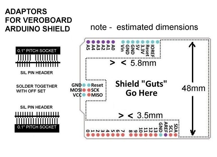

                                  john swift 1
                                    @johnswift1
                                    Hi Zebethyal
                                    reading your comment about non standard spacing that perpetuates the use of shields,
                                    has me thinking about a DIY solution
                                    I've no found all the information I need
                                    Probably need to obtain an Arduino and a variety of connectors and a piece of veroboard (perf board) and have a go
                                    this is just my initial thought :–

                                          Zebethyal
                                            @zebethyal
                                            @John Swift 1 – the non standard spacing is not with the pin headers themselves, these are a standard 0.1" pitch, the issue is with the spacing between the headers on each side.
                                            If the pins on one side are inserted into holes on some strip/vero board, then the pins on the other side fall half way between two rows holes, thereby preventing the use of cheap veroboard.
                                            Yes, it is possible to cobble something together to generate the correct offset, and I believe you can even buy stepped adapters, however I found it sufficiently annoying that I simply gave up on the boards and went to using the chips directly on breadboards and veroboard, programming via the ICSP interface.
                                            The only occasions I use the arduino boards is if I want say a capacitive touch screen LCD shield, or the protoneer style stepper shield, where it is simply quicker and cheaper to just buy the shield than fabricate it myself.
                                            All of my prototyping for additions to my 3D printer are done using an ATmega1284p on a breadboard, this includes my own panelolu alternative using I2C for the LCD (using 4 less pins than panelolu) and bluetooth connectivity (here).
