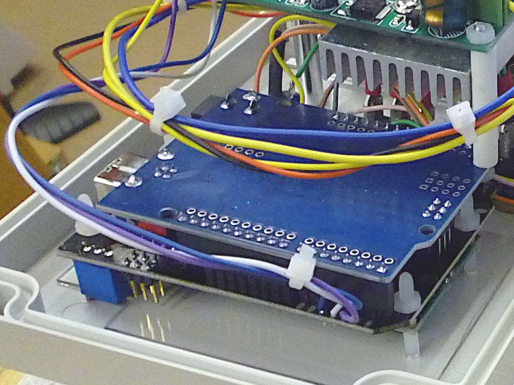

        Journeyman – I have sent you a PM
        #551802
        Journeyman
          @journeyman
          Greensands, replied to PM. This image might help.
