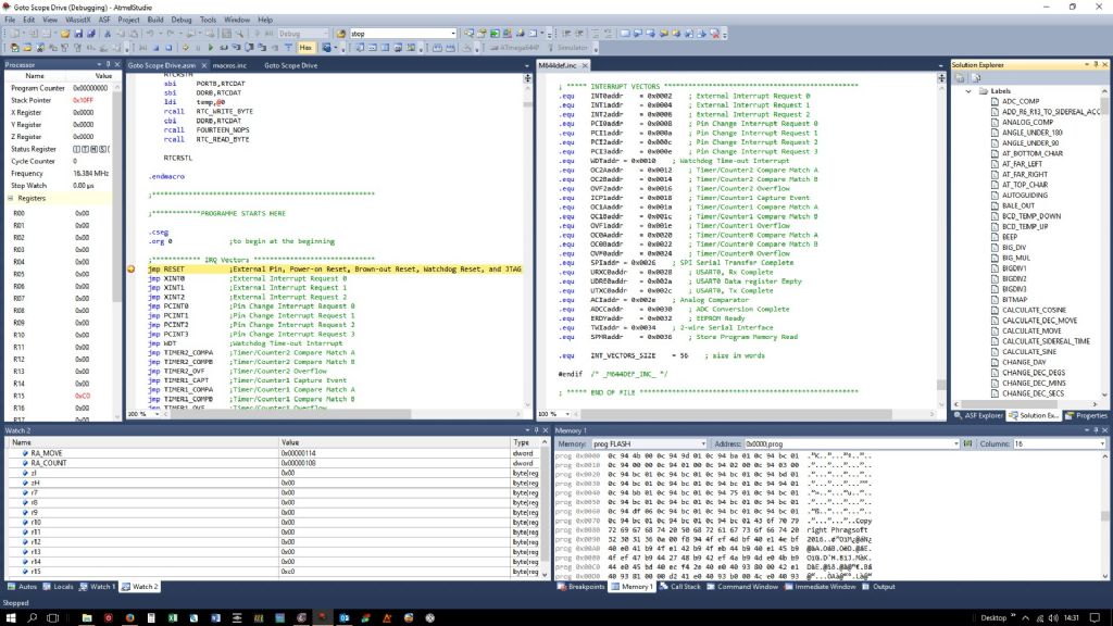

                                      Not for the faint-hearted, this is what Studio 6 looks like, a bit more complex than the Arduino sketch tool, but it does make sense in the end…

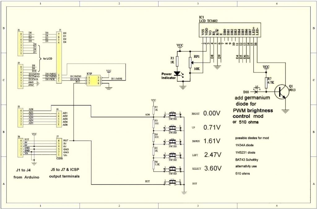

                                                    I already had an Arduino uno and thought I would by the LCD shield to convince myself it works before getting the motor and driver. I am not up to speed with the programming.
                                                    I have uploaded the sketch and fitted the shield but it's not working quite right, unless this is because the other parts are not installed.
                                                    On power up I get the version number displayed and then SELECT MODE and MODE = STEP which is correct.
                                                    When I press the SELECT button nothing happens. Pressing LEFT, UP or DOWN scrolls between STEP,TEMP,RUN and JOG. RIGHT does not do anything.
                                                    Is it possible the LCD shield is faulty?
                                                    I would appreciate any suggestions anyone can offer.

                                                      Hi
                                                      I don't have an arduino uno and LCD + switch sheild but
                                                      pre empting buying them to experiment with I have found conflicting notes about the LCD sheild
                                                      it seems that some boards you can only use D10 to switch the display LED backlight on & off
                                                      others you can use PWM to contol the brightness
                                                      this is what I have so far
                                                      PS
                                                      routine to read keys
                                                      int read_LCD_button()     // routine to read the LCD's buttons
                                                        int key_in;
                                                        key_in = analogRead(0);      // read ADC
                                                        // average values for my board were: 0, 144, 324, 505, 742
                                                        // add approx 100 to those values to set range
                                                        if (key_in > 1000) return NO_KEY;
                                                        if (key_in < 50)   return RIGHT_KEY;
                                                        if (key_in < 250)  return UP_KEY;
                                                        if (key_in < 450)  return DOWN_KEY;
                                                        if (key_in < 650)  return LEFT_KEY;
                                                        if (key_in < 850)  return SELECT_KEY;
                                                      hope you can now check your keys
