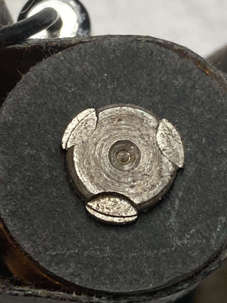

  • #841874
    kilmolymock
      @kilmolymock
      looking for tooling / punch /jig to form these indents  in low carbon bright IMG_4662
      #841878
      Robert Atkinson 2
        @robertatkinson2
        Looks like it’s just 3 round punches on a PCD slightly larger tha the shft diameter. It would be fairly simple to make up a guide to slip over the shaft with 3 guide holes. The outside of the guide holes would have to be relived outside the shaft PCD to allow the metal to be displaced.
        If not worried about exact postioning just use a flat ended round punch freehand.
        Robert.

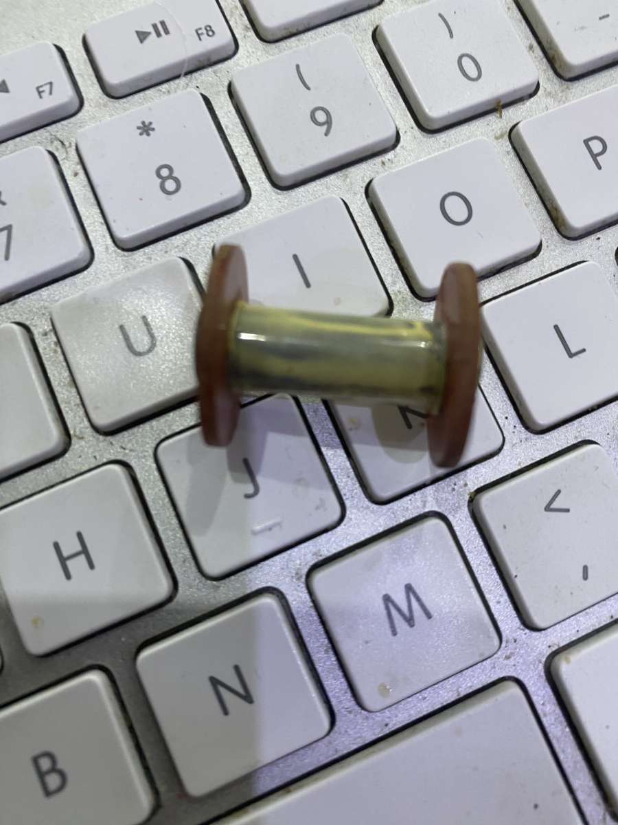

          kilmolymock
            @kilmolymock
            IMG_4664Yeh I would be looking for repeating over and over the same depth each time, keeping the washers parallel and square
            ,I was thinking about boring or drilling a sleeve out and coming in from the side with 3 pieces of silver steel to form the indents as the top and bottom of the core needs to stick out about 1.5mm above the washers each end
            that pic shows one knurled both ends and the washers just pessed on

              #841892
              kilmolymock
                @kilmolymock
                Sorry about that ,was getting earache at the time about cooking a chicken! 8mm shaft, soft bright steel ,32mm long ,washers 1-2mm thichness held at 1.5 mm either end of shaft, washers only need stopped on the outer faces

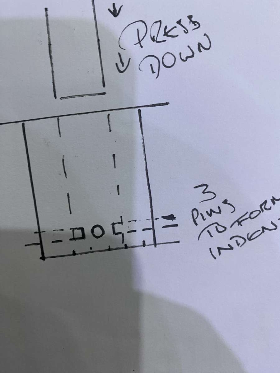

                                        #841973
                                        kilmolymock
                                          @kilmolymock
                                          l8rxxsqlj8lej8f0wn2quq1tlip73mzc
                                          #841974
                                          cedric 1
                                            @cedric
                                            I can’t see how that is going to work. The indents will be in the wrong plane from your original picture. And the displaced metal would make it impossible to pull the part out of the tool afterwards.
                                            It looks to me like your 3 round punches need their axes parallel to the axis of the job.
                                            #841980
                                            kilmolymock
                                              @kilmolymock
                                              it is only  sketch and an idea, not a good one right enough
                                              but yeh u are right ,brain fog set in ,probably end up with a 2 or 3
                                              part fixture

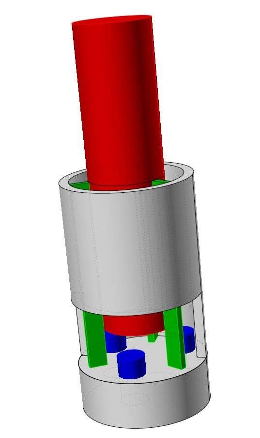

                                                #842044
                                                Peter Cook 6
                                                  @petercook6
                                                  I envisaged something like this
                                                  Punch tool
                                                  Red is the spindle, Green three guides, Blue the three punches, Grey the support tube – without the cut out at the bottom. The guides may be a bit thin, but he design gives room for the extruded metal to expand and still come out of the tool.
