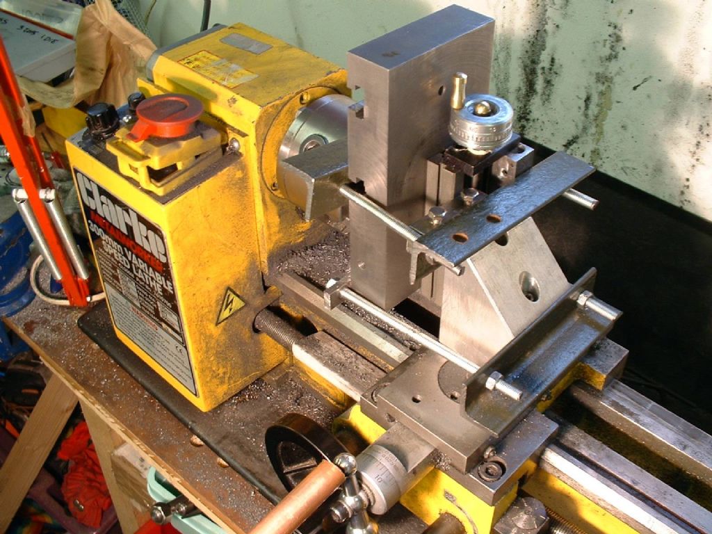

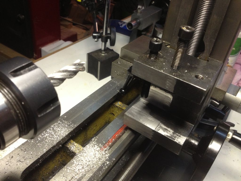

      Morning all
      I've dug out the raraley/never (?) used milling slide for my inherited mini lathe and oh deary me!!! The main body of the thing seems to be reasonably well made and ground all over but the slide/carrier/whatever-you'd-call-it is appalling! Apart from the ugly voids in the casting that won't affect its operation it looks like it has been finished on a linisher. There isn't one flat face on it and not one face is 90 deg to any other. What I would consider to be the most useful reference face is like a banana.
      I figure there's not much to lose with the thing and I really need to get an engineering company to mill it all square (I don't have a mill) but I can't find one locally in sticksville, France at the moment so I'd like to try to do something with it myself in the meantime until I can get back to UK.
      I ran a milling cutter across it but the cross slide travel is insufficient to traverse the thing completely (see photo). I consdered drilling extra holes in the cross slide to mount the milling slide further over but the cross slide leadscrew nut is in the way. I tried turning the cross slide round but again, not enough travel to get a full pass over the casting.
      Have any of you experienced bods any ideas for how I might square this up with the limited facilities I have because I'm a bit stumped?
      Thanks
      Scott

          Hi Scott,
          Maybe a few more pics of the mounting would help as there may be a few options .
          It seens as it is mounted to one side and not utilizing the full travel of the cros slide or maybe not designed for this machine .
          I would think that you would want it to center up at about half way of your cross slide travel so you have equal travel on both sides .
          You could maybe make a spreader plate to mount it up so the mounting bolts arer away from the cross feed nut etc .

            H Scott ,
            You could with difficulty hand file it all true but probably not worth the effort .
            This is what I would do :
            (1) Saw off the top and bottom shelf parts and face the remaining plain rectangular surface true .
            (2) Depending on thickness of remaining material either bolt on a plain rectangular plate with an arrangement of tapped holes in it which would allow a standard small machine vice to be fitted or tap the holes directly in the parent block .
            Regards ,
            Michael Williams .

              Hi Scott,
              I agree with Ian and Michael's advice. If you have – or can make – a flycutter you will be able to face a larger area.

                  Quick'n dirty flycutter is a short holder sticking straight out of the faceplate carrying a short length of round tool steel. Slightly longer solid piece opposite for balance. Tool holds better if you double bore the hole by putting a small hole parallel to the main bore offset by the main bore radius. This gives two line contact opposite the clamp screw instead of the single line you get with a simple round bore. Small hole around 1/4 of main bore diameter seems to be the rule.
                  If you haven't got the faceplate use a stout bar in he four jaw to carry the tool holder. Flywheel mass is always helpful for getting a good finish on clunk, clunk, clunk interrupted cut jobs. Especially on a mini lathe or anything else which is lightly built.

                    If you round the end of the cross-slide feed nut and recess the end of the cross slide so it can 'overlap' the back of the index dial you can get 1/2" extra travel.
                    If the mounting point is too far out from the centre line, you can always fit the cross slide on back to front (I upset Mike Chrisp by suggesting this, but it worked for me).

                        The inward travel of the cross-slide can be extended by fitting it with a longer feedscrew. Mike (another contributor on here) did it the proper way, by making an entirely new feedscrew.
                        I did it the quick and dirty way by threading a bit of rod M10 x 1 LH, and bolting it on the end of the existing feedscrew like this. Not for purists, perhaps, but it seems to work fine. There's no reason why it shouldn't, really.
                        Of course, you need to check how much overlap will be left between the slide and its base when the slide is as far in as you want it to go, and that you aren’t left with all the gib screws except one in the overhanging part of the slide.
                        Andy

                          …or make a custom table for the lathe:
                          Table 1

                                I milled the table in the lathe, by clamping it to a 'Peatol' vertical slide which is a lot smaller than yours!
                                I had to cut the dovetails in two sections, usinga bit of kitchen worktop as a jig to keep the setting. The first one came out perfect, I just couldn't get the second one not to have a detectable join – fortunately that was the gib side where it doesn't matter.
                                I squared the blank up on the faceplate – this was before I understood the limitations of my lathe!
                                Full capacity
                                Milling t-slots

                                    Scott, Appreciate I may have got the wrong end of the stick here, but my understanding is that you need to generate some long flat and parallel faces here. How feasable is it therefore to use a sharp tool in a very substantial bar mounted similar to say a boring bar, but with the chuck prevented from rotating. The offending milling slide is then mounted securely on the cross slide, with small cuts being applied to one face at a time as the saddle is wound back and forth, so in effect using the lathe as an old fashioned hand planer. In this way length of cut will not be a problem and , assuming the lathe is already set up correctly, the results should be reasonable enough for your purposes. Trevor.

                                        Hello Trevor. Interesting thought. I might try that to see if it's feasible before I saw the lugs off. The lathe is a tad "flexible" though so I'm not sure if it'll like being used as a shaper smiley
