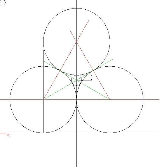

      I’ve sometime said I find TurboCAD Deluxe in 2D mode useful for geometrical constructions: most recently for designing a disc valve giveing constant flow over a range of rotation angles, for a combined vacuum- and mechanical- brake control on a loco driving truck. From that I drew the actual parts in Alibre Atom.
      This is an oddity though.
      I’ve a friend who lards his Christmas cards with mathematical puzzles, giving the answer next Christmas. A keen runner, most have been about runners racing up and down hills. I thought solving them requires deriving simultaneous equations far too hard for me; but he shows some other method simpler but not at all obvious.
      Then this last Christmas: “Runners have to vault over three identical logs, in a cross-country race” – see diagram,, showing the logs, of 32.26cm dia, stacked horizontally and parallel.
      Now forget the athletes….
      Calculate:
      1) the cross-sectional area of the central cavity, and
      2) the maximum diameter of a cylinder that will fit the cavity, touching each log without displacing it.
      A rough sketch showed me the geometry hence how to calculate it, but as well as other errors I needed several attempts to calculate the area of the triangle that it gives, with its apices on the log centres. It height as in (half-base X height) stubbornly resisted several methods but eventually yielded to Pythagoras.
      The area wanted is the triangle’s area minus the total area of the three sectors it delineates.
      So that was Question 1) done.
      Next, how the heck can you work out that inscribed diameter? Only by a CAD drawing, from which I found I had guessed correctly the pipe’s axis is on the triangle’s bisectors. The dimension tool gave the radius and I proved it by drawing the circle.
      Trevor wanted the answer only to whole numbers. Here is the solution: 1) 41cm^2, and 2) 5cm.

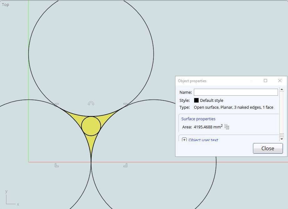

          Nigel.
          I find the cross sectional area to be closer to 42cm2.
          Martin.

            Saw this as I sat down to lunch. 2nd question doesn’t need millions of transistors beavering away, driving CAD, just basic trig and Pythagoras. The key is to consider the triangle formed by the centres of the two lower logs and the centre point of the inscribed circle. Its ‘height’ is found by log radius X tan 30. Plug that into Pythag to find hypotenuse, then subtract the log’s radius, and double the result. OK, I admit I had to employ quite a lot of transistors in a scientific calculator… No doubt there’s a quicker way – I’ll leave that to proper mathemagicians to reveal.

                    No, he’s not a dress-maker or Blue Peter presenter, but I think he was an IT specialist when working, and amateur geologist as retirement hobby. Indeed he gained his PhD in just that! Another friend – builder by trade so accustomed professionally to metres and millimetres – was telling me this afternoon about his frustration when his daughter (now adult) keep using measurements like “7.3cm” instead of “73mm”. It is because schools will insist on teaching centimetres.
                    Since I was so close I must have used the (or ‘a’) correct method but either mis-typed one of several 7-digit numbers into the calculator, or rounded the answer the wrong way.
                    KiwiBloke –
                    I’d assumed using trig to solve the triangle linking the centres, and that kept going wrong. Then realised I already had the values enabling me to use Pythagoras instead.
                    That cracked Q.1 (the area).
                    Q.2 was far harder. I could not see any possible way to solve it numerically – not the arithmetic itself, but which arithmetic to use.
                    I think that is the key to being able to use mathematics. It’s not just knowing standard formulae and rules; but being able to examine the problem and see which of them to apply when no method is obvious.
