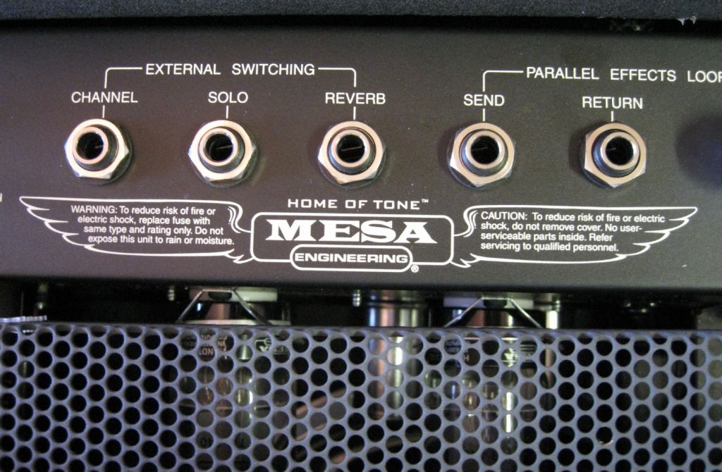

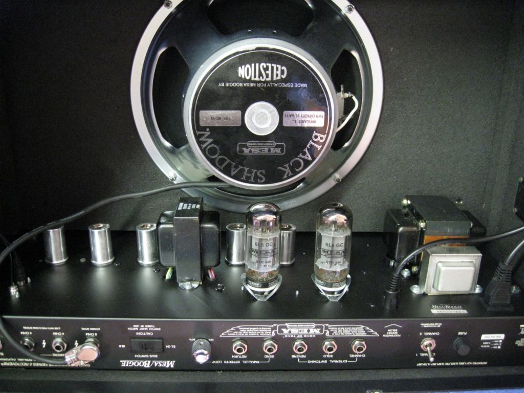

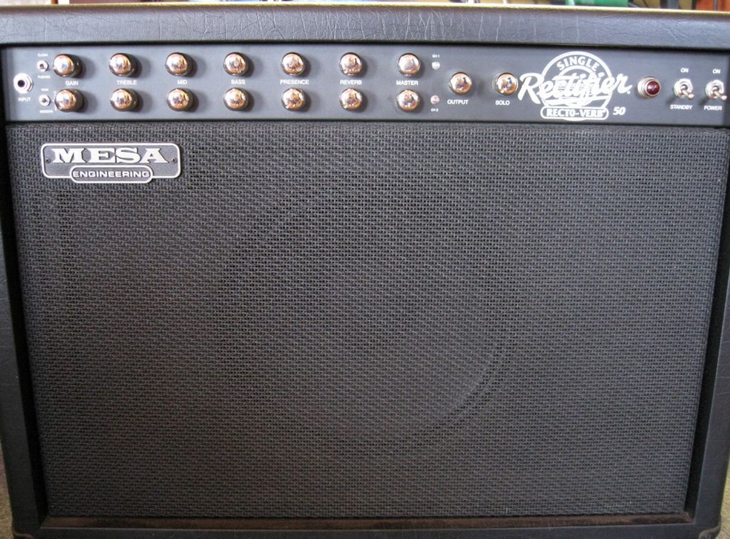

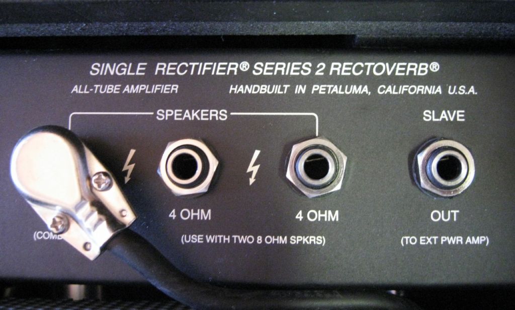

        For Brain Food I repair musical equipment for our local Music Shop – A nice one came in yesterday. Very nicely made by Mesa Engineering, Hand Assembled in California! Was a pleasure to work on. A simple repair – a large 3.3uf 600v polypro capacitor had broken one leg – it was the only cap not bonded to the PCB, and being a good combo/base amp, the vibration took its toll.
        A really nice sound, hard to distinguish from really good Fender and Marshall bits of old..2 x 6L6's in the output, a nice 50watts.
        The metal chassis has every open seem tig welded, every edge and corner de-burred and smooth. Every wire nicely laced and tied.
        Thought this did not happen anymore in the real world.

          Looks a beautifully made unit, well respected for its sound as well. Having looked in a few hifi audio amps they often seem to just birds nest the wiring, the justification seems to be that it reduces crosstalk pickup however Quad must be immune from this as they have beautiful neat wiring. Could it really be a cost saving measure or design shortcut?

            It is well made, and no doubt reassuringly expensive, but Mesa's sales-talk rings alarm bells!
            I looked them up in hope of finding out exactly what "Single Rectifier® – Series 2 Rectoverb®" might be. I did find:
            "We keep saying it, but it’s hard to overstate the value, effectiveness and stylistic “power” of the Multi-Watt™ Channel Assignable Power switches. These dedicated wattage range choices unveil different power characteristics and colors – so they are really power “voicing” switches as well.
            In this Recto®, the choice of EL-84 power tubes with their amazing clip characteristics, prompted us to explore the different wiring schemes possible. This experimentation led to the 10-Watt Power Mode being wired for Triode operation. This “more vintage” wiring scheme sweetens and rounds out the sound, turning what might otherwise be a lower volume version of the same voice, into more “soulful” Recto experience.
            The 25-Watt setting delivers a bold attack, tight tracking low end, increased definition and all out headroom. This setting works great with all the sounds and certainly showcases the mightiness in this little Rectifier®, shocking unsuspecting players and bystanders alike with power and sonic size. But any time you need to tame this little beast and put a vintage patina of warmth and silkiness around things… kick down to 10-Watts and enjoy a whole new and different world of Recto expression."
            I apply the "need to tame this little beast" every time I use my lathe, which also has a "vintage wiring scheme". Turning too fast, the cutter is unlikely to achieve the "silkiness" I want in the finish, and run for maximum chatter my lathe is also able to shock unsuspecting bystanders with its 'sonic size'. The lathe works much better when I manage speed with the hand-fitted Polybutylene Succinate isolated and carefully matched Carbon Track Potentiometer.  Ignoramuses only see an ordinary speed control knob.
            The presence, or not, of a wiring loom, is no indicator of quality or cost. In a car, for example, it's much cheaper to make up looms on a board and fit them as a whole than it is to individually run wires through a finished car. Lots of other advantages, the loom can be routed to avoid damage and firmly fixed to resist vibration.
            In electronics, looms are often avoided like the plague. At higher frequencies, looms have significant inductance and capacitance and they are highly prone to cross-talk. A 1940's valve radio will typically have looms and parallel tags for power and audio, but short direct wiring in all the high frequency circuits.
            Frequency-wise, audio amplifiers are in border territory. A cynic might suggest this accident of physics allows makers to cater for customers who believe neat tidy looms produce the best sound, and customers who believe short direct wiring must be the bees-knees.
            Engineers like to wire stuff up to avoid cross-talk, distortion and parasitic oscillations… They also know that amplifiers are imperfect compromises, that most people don't notice 5 to 10% distortion, and that audiophiles perform badly in double-blind sound tests. In engineering, functionality is all that matters. Or is it?
            Rather a lot of engineering is devoted to status, everything from Smart Phones to Space Travel. It pays the bills and fuels development. Audio-mania isn't completely bonkers – it meets our social need for togetherness and hierarchy. The need to be a member of the group stops me going to funerals dressed as a clown even though the suit keeps the weather off perfectly well! And the same group rules expect the Vicar to wear a dress…

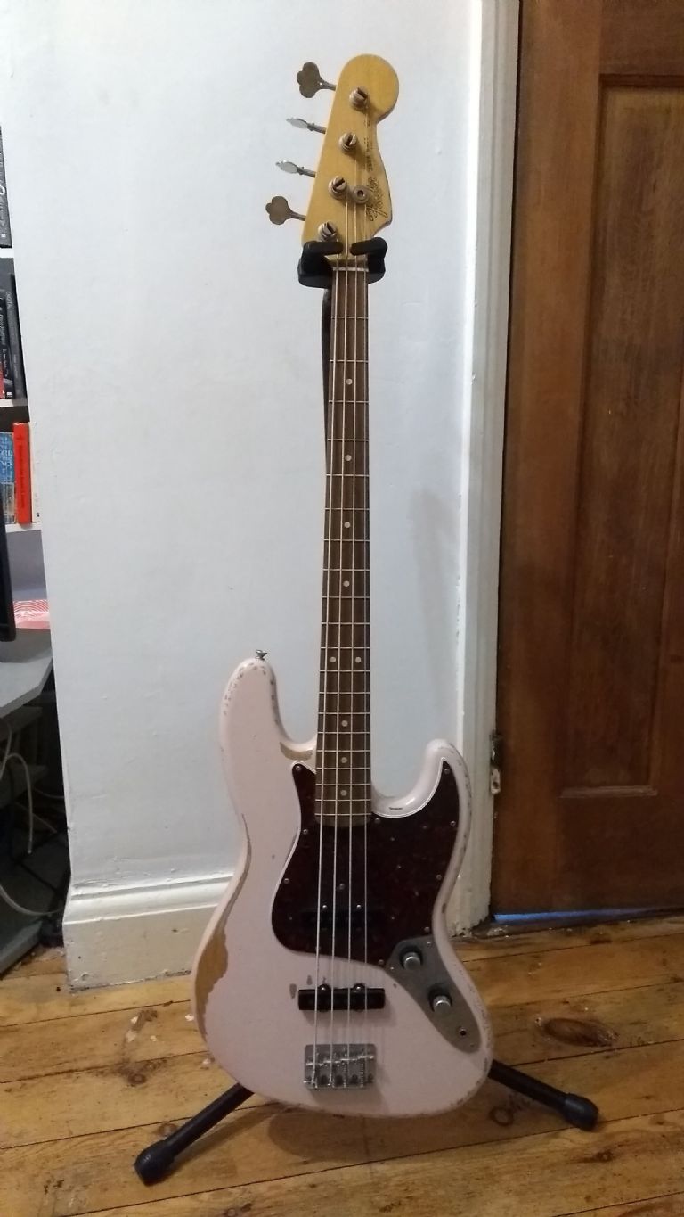

                      Anotehr example I tried out a very nice bass last week – on a Markbass Amp (clean, bright slappy oriented) its bridge pickup sounded rather poorly, swapped to a Fender Rumble with a more 'vintage' tone and it sounded excellent, back home and it sounds great on my Orange Crush practice amp. Note that I kept the tone settings pretty neutral on all three (transistor) amps.

                          Nice Guitar Neil!

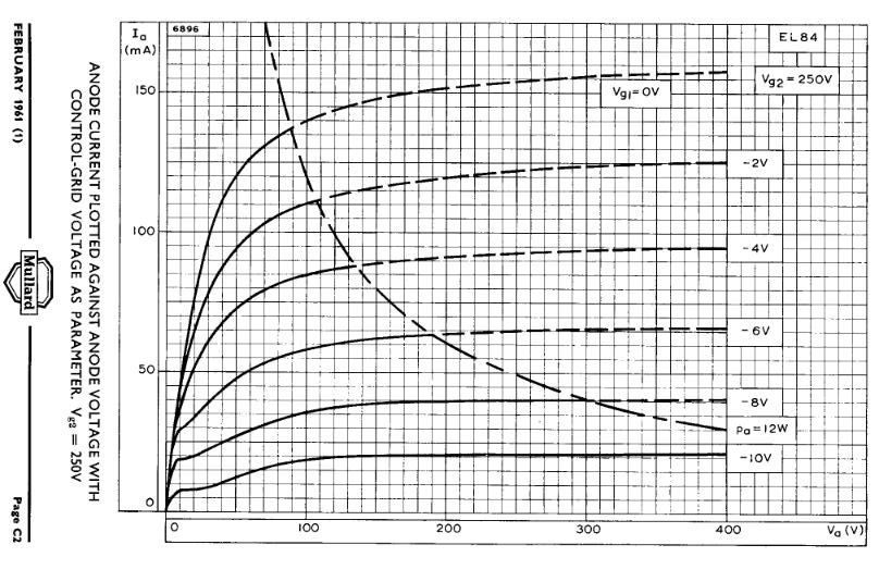

                            Valves, like transistors, are imperfect devices. Ideally the characteristic curve would be a straight line; they aren't. Curves and kinks are what the designer has to work with:
                            In the EL84 example above, the curve is drawn for a range of anode voltages. This is important: while the designer can design the amplifier to operate more-or-less linearly under ideal conditions, his efforts will be undermined if the power supply sags under load. As stiff power supplies for valves are expensive, this aspect is often compromised. If the listener finds the effect pleasing, the audiophile isn't enjoying the original, he's being pleased by a cheap power supply! This is only one of many examples where an amplifier can fail to meet specification.

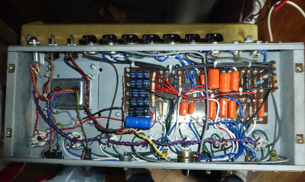

                                        Inside my amp ,a real amp with no pcb`s.

                                                    Nice example of a real amplifier with a mix of best-practice and compromises!
                                                    Good news:
                                                    • The output valve is positioned next to the PSU and, being a power output stage, is relatively immune to picking up hum from the mains transformer.
                                                    • Laying out the valves with the hot power supply and output stage well away from the input stages is good practice – less heat.
                                                    • The transformers are angled on the chassis to discourage mutual coupling and are shielded from most of the sensitive wiring by the chassis.
                                                    • The rectifier valve is a double diode producing 100Hz half-cycles. 100Hz is easier to smooth than 50Hz.
                                                    • One of those transformers may be a power supply choke, which is good, but its size means it's a only a 'swinging choke'. These work well at low currents but their inductance and ability to filter drops when the power supply is heavily loaded. They cause distortion at full volume, where it's less likely to be noticed, the first compromise! Chokes that don't swing are heavy and expensive.
                                                    • The heater wires are tightly twisted to reduce radiation.
                                                    • The output valve is a 6V6 Beam Tetrode. Invented in 1936 the beam improves the valve's characteristic curves for low frequency applications – it distorts less than triodes, tetrodes, and pentodes. Impressive, I think, that 6V6's are still valued today.
                                                    Compromises:
                                                    • Most of the components are laid out on a tag board. This is easy to maintain, but increases the length of the wiring, which introduces a shoal of negative effects. High-end frequency response is reduced, there's more chance of hum pick-up and cross-talk, and a risk of parasitic oscillation. However, as audio amplifiers are low-frequency devices the impact on frequency response is trivial, and accidental pickup may be unnoticeable.
                                                    • Valves (and semiconductors) produce more power and less distortion in push-pull configuration. Unfortunately push-pull is more expensive and complicated. This amp has a single 6V6. It's good but it can't be very good!
                                                    • Two of the ECC83's (also good audio valves, circa 1945) are 'Made in Russia'. When transistors removed the mass-market for vacuum tubes, people stopped making ECC83s in the West. Russia produced valves for rather longer, but doubt was cast on their quality. I've no idea if modern Russian valves are inferior to older Western-made valves or not.  Audiophiles say they can tell the difference.
                                                    • Perhaps the most serious compromise is the way the amp is mounted upside-down in the cabinet. A disadvantage of valves is they run hot, each containing an electric heater burning a couple of watts each, or more. This is before power is applied to do anything useful. Usually valves are mounted on top and ventilated to convect the heat away. Being valves down, this one dumps heat into the chassis, and, adding to the problem, the amp is positioned at the hottest part of the speaker cabinet. This may be why the aluminium shielding cans are missing. Ideally present to keep stray fields out of the valve, they keep heat in too! On average shielded valves don't last as long in service as unshielded valves.
                                                    It's possible to pick almost any technical solution apart in this way. Actually, I think Marks' amp is a thoroughly  acceptable compromise. I've not spotted anything careless or ill-considered, and it should do a good job. But it's not the end of the story, nor is Joes' Mesa. If a designer were called on to build an amplifier linear at 10MHz, most of the construction style used in Mark's amp is asking for trouble, and at 30MHz it's unacceptable. The need to do better than needed in audio amps has pushed electronics into entirely different technologies: 5G runs at 26GHz.
                                                    Returning to my theme about the psychology of technology, I find it interesting that people have strong opinions about low-tech stuff like hi-fi amplifiers, hand-tools and manual lathes, but have nothing to say about high-tech products. I suppose when ordinary domestic gizmos like mobile phones are beyond the understanding of any individual, all you can do is criticise their colour, size, lack of signal, battery life, instructions (in 17 languages) and useless support service!  Modern technology is a right spoil-sport.

                                                      Hi Dave, you obviously know alot more than me about amp circuits etc.. The valves do have cans on them by the way but the amp cabinet is open backed, so i havent noticed any heat problems. It has a strip of wood to stop the valves getting knocked though.
                                                      These amps were designed by Barry Vyse and mine was probably built in kit form on one of his amp building courses. Hes a very knowledgable guy and worked for Marconi Osram i believe. Wrote a book on the subject.
                                                      Do you happen to know which is the cathode bias resistor in the photo of the inside ??
