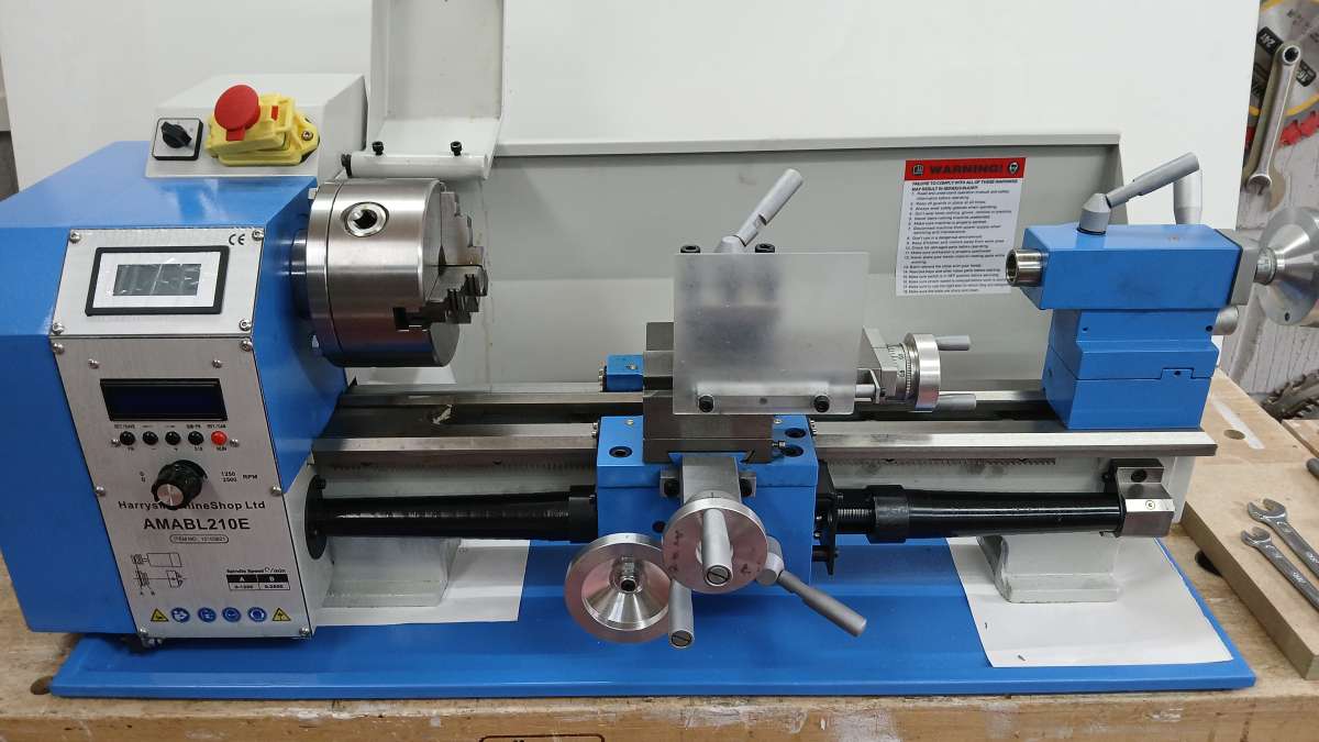

      With the latest Digital issue now available, I’ll add some additional images that did not make it to the printed review.
      #816418

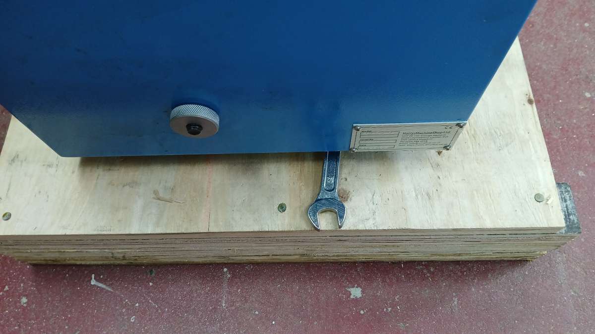

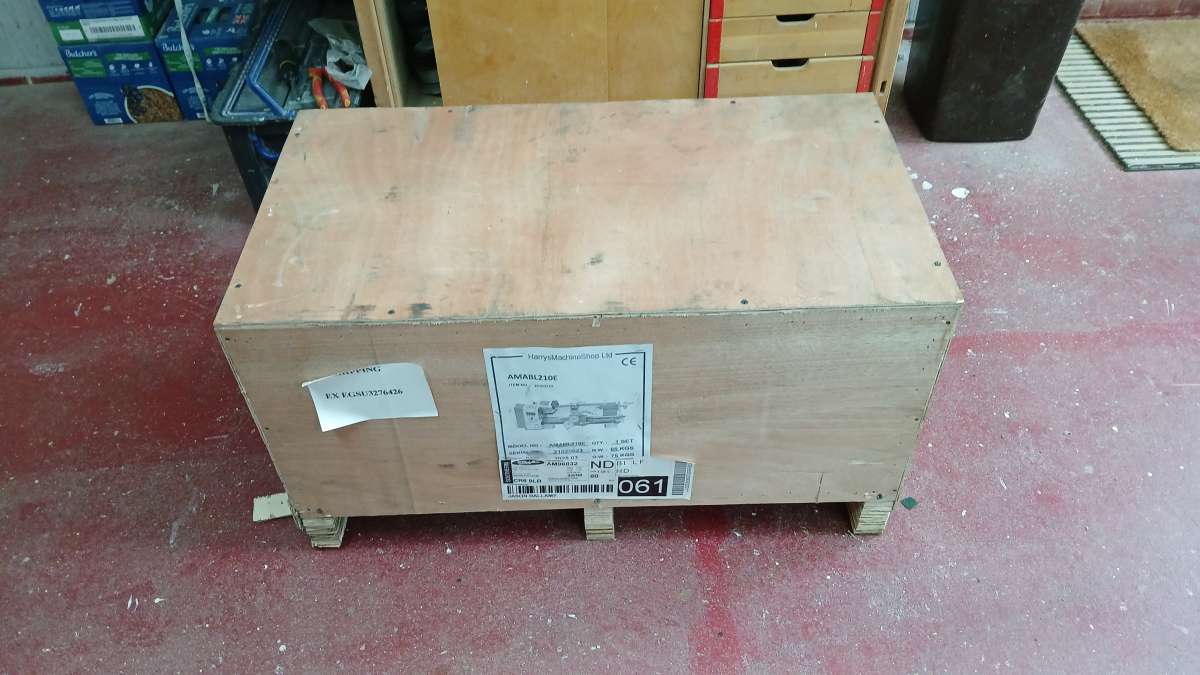

        Don’t worry if the box says Amadeal or Harry’s, as the latter is Amadeals e-bay shop name.
        20250624_135759
        The hidden fixing holding the lathe to the pallet
        20250624_140633
        What’s in the box

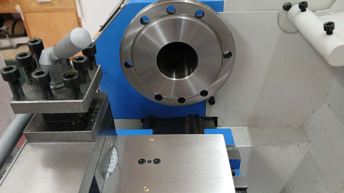

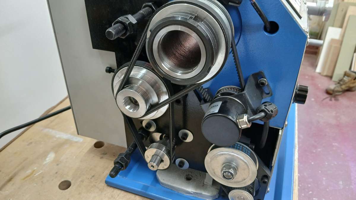

        This shows the motor driving the layshaft,two ratio drive from the layshaft motor to the spindle, spindle drive to the encoder and tucked down bottom right is the stepper motor which drives the leadscrew via another toothed belt.
        The big 38mm bore spindle (just takes 1.5″) as does the supplied 125mm 3-jaw

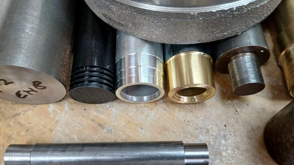

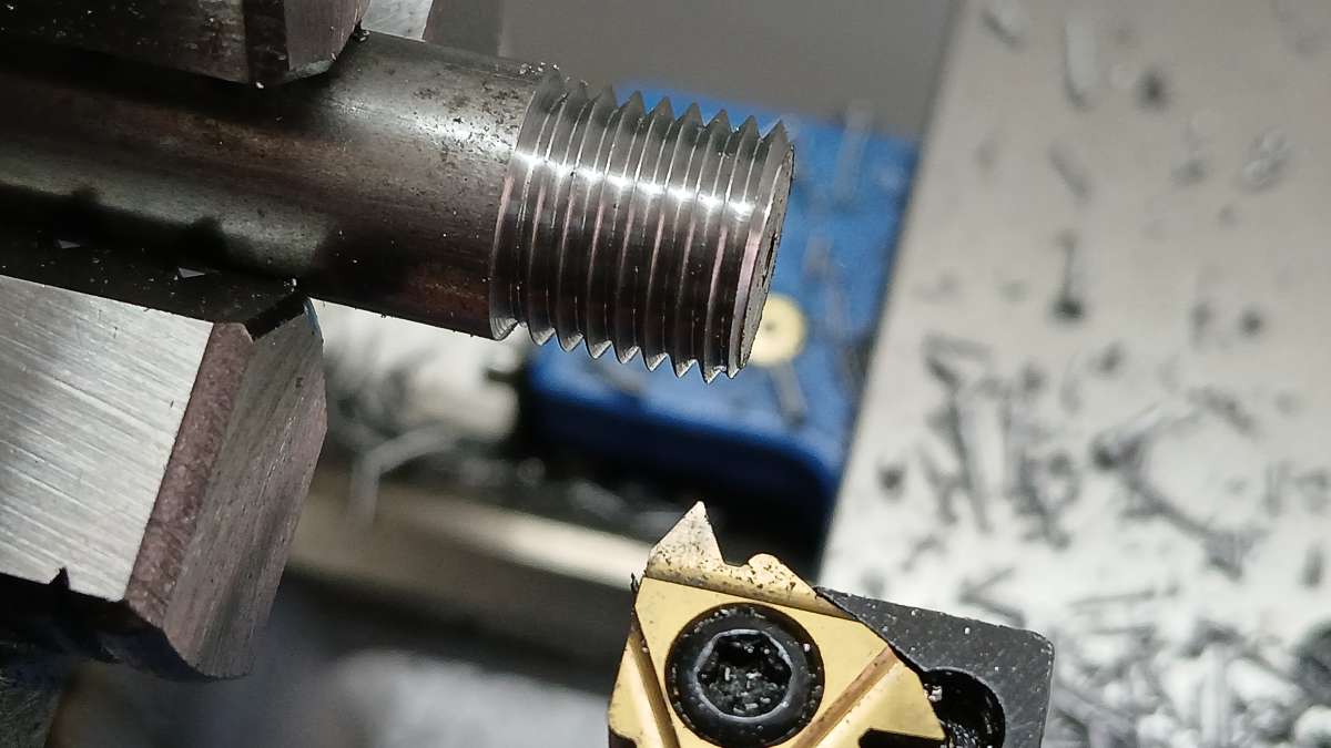

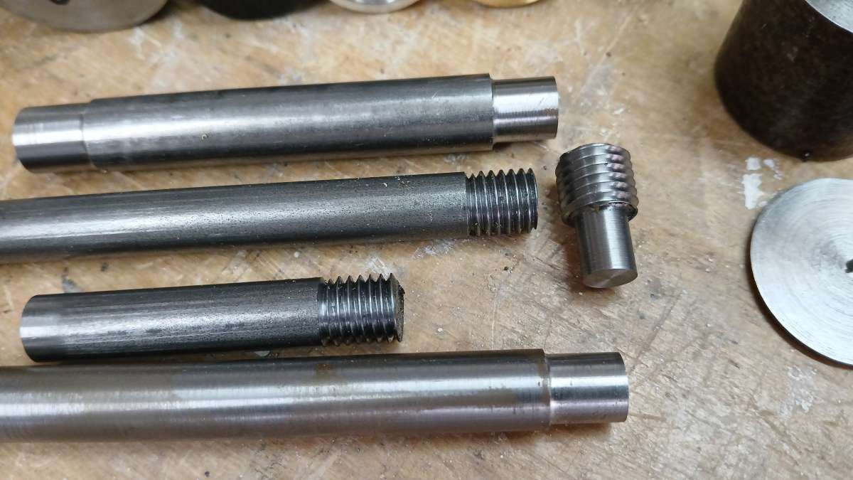

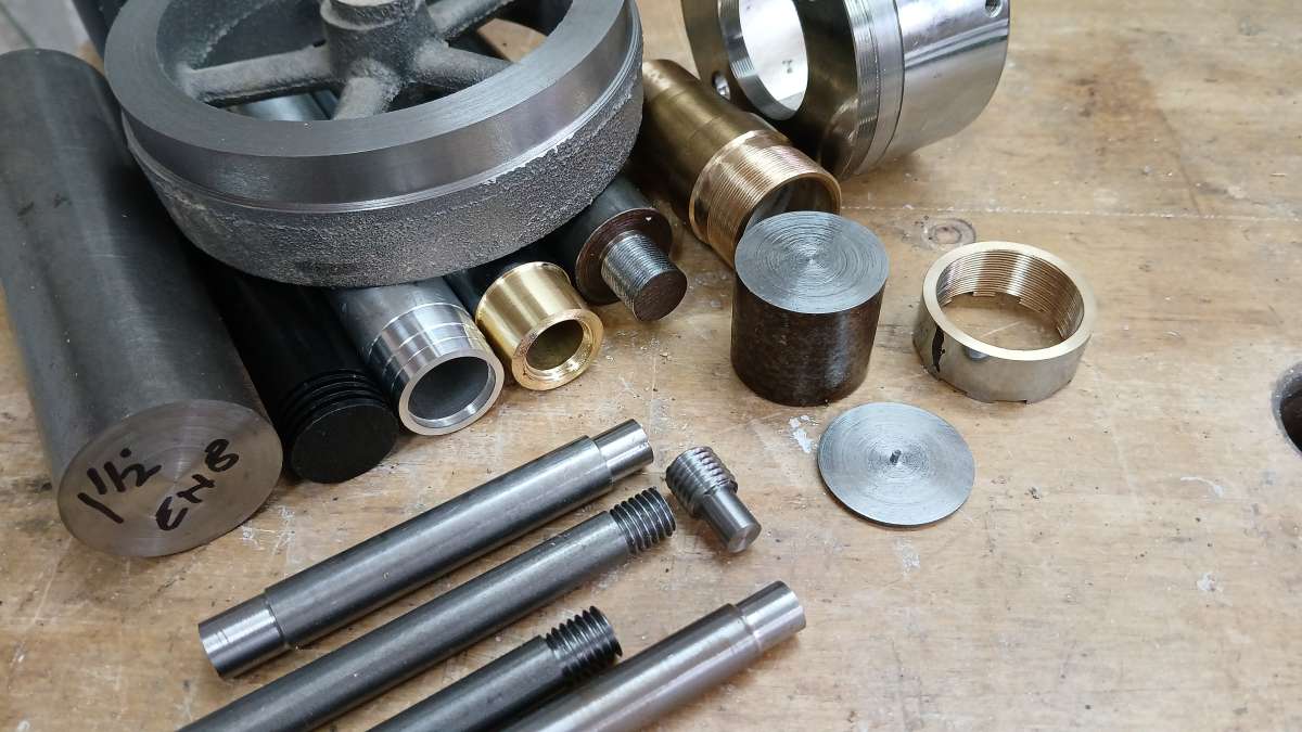

          Some larger images of various cuts made and screwcutting examples, click any to get even larger.
          20250704_110316
          20250704_110334
          20250704_110341
          20250704_110347

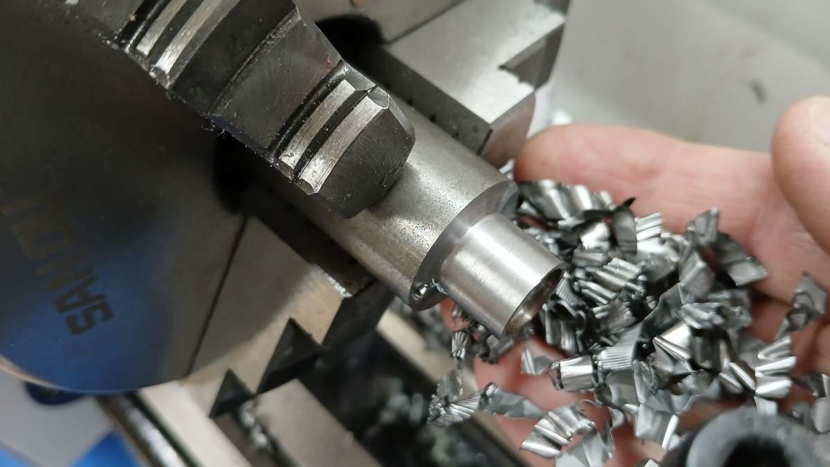

          5mm depth of cut in 30mm dia steel. Using metric feed rates (for those that need them) of 0.03 and 0.05mm/rev
          M12 x 1.75 thread again in steel. Cut to preset length.

              is the stepper closed loop? (sorry, I’ve not actually looked at the spec for it yet) If not did you ever notice any losses, especially threading etc?
              It looked like it was pretty straight forward to use.
              #816427
                I’m not sure of the exact setup but did not notice any problems with it going out of sync. Seems to be quite accurate when checked with a plunger type indicator.

                            Hi Jason, re-reading your review of this lathe with greater interest, a couple of queries arose.
                            Did you turn a length of stock down and measure along its length to determine accuracy of turning, that it turned true?
                            I also noted that you did not bolt the lathe down.  It is unclear to me how many bolt holes and their disposition there are, although there appears to be one under the array of pulleys in your photo – could you enlighten me please?  Had you bolted it down, do you think there would have been a likelihood of pulling the lathe out of true – do you see this as a potential issue?

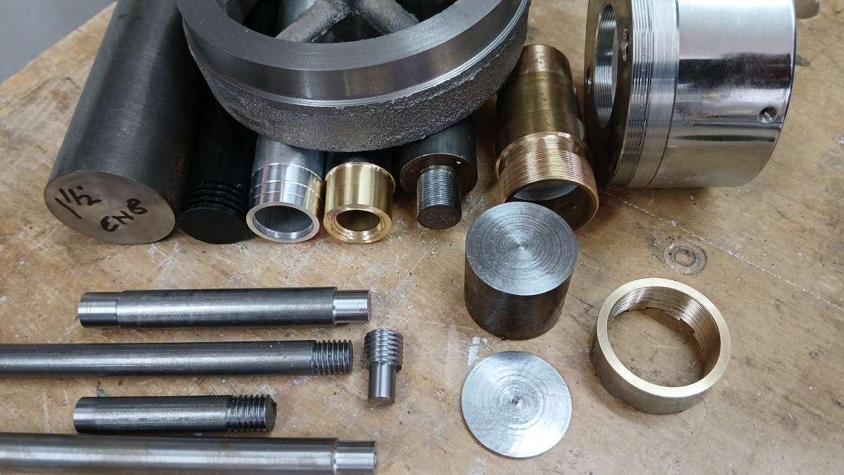

                              Hi Chris
                              From the article
                              Subsequently I made a very slight adjustment to the tailstock set over as turning a long piece of steel showed a slight taper of 0.015mm in 170mm. I quickly got this down to just under 0.005mm but did not spend too long as the lathe was just sat on a bench and not staying there.
                              I used a piece of 12mm EN1a (230M07) and took a 0.5mm depth of cut along a 170mm length using tailstock support, the cutter was a CCGT 060208. On initial measuring, there was 0.015mm (0.0006″) or just over half a thou difference one end to the other.
                              A quick adjustment of the tailstock offset got that down to 0.005mm (0.0002″) or 2 tenths of a thou over 7″. I probably could have got it better but did not spend more time chasing down such a small difference as the lathe was not staying long term and I only wanted to spend a certain amount of time on the review.
                              It does not look like I kept a photo but will take one of the test piece tomorrow, quite a good finish over the long length and no signs of chatter or deflection in the middle considering it was quite a large insert radius. The test piece is in the lathe in Photo 5 but almost totally obscured by the Dti I was using to check how much I moved the tailstock over.
                              There are two fixing holes, the one you mention and another centrally in the foot at the tailstock end.
                              So much will depend on what the end user bolts their machine down to if they do decide to bolt it down. To be able to twist a lathe you really need to bolt it to something more rigid that the actual casting, the usual thin metal stands or wooden worktops are more likely to conform to the lathe bed that make the bed conform to them. You have no doubt seen all the engines I have made, my lathe is just bolted to the stand but the stand is just sat on a wooden shed floor, no more leveling than a Stabila builders level on the floor so I’m not really of the school of thought that lathe needs be boted down and fancy machinists levels needed to “level” the bed to make typical engineering models.
