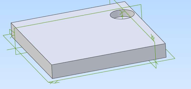

          #828689
          Nigel Graham 2
            @nigelgraham2
            Thakyou Jason – given my familiarity with three-dimensional co-ordinates I ought not have all this confusion with their CAD brethren! So I tried a quick test as I think I understood what you mean. I drew a square on that Xz plane, and extruded it, added that hollow to give a defined “way-up” and “which-way-round”; and the results are as below.
            It’s just not intuitive. If I try using the other planes to start it still ends up all weird! My milling-machine doesn’t work like that – its “X” is upwards and downwards, not off to one side, the knee moves up and down and the top of the table faces upwards. Similarly with any conventional co-ordinate geometry.
            Screenshot 2025-12-13 205852Screenshot 2025-12-13 205826Screenshot 2025-12-13 205845
            At least I have enough information in that assembly to start modifying those parts already physically made where necessary, and to design the further components.
            The eccentric sheaves and straps are made but not the rods, so seeing that mistake has at least meant I can get those right before some hours of metalwork. That error was not a CAD-driving one. I’d miscalculated the dimensions.
            The one big part I definitely want to be certain of before cutting any metal is the cylinders: machined out of a solid billet of cast-iron stock bar.

                  #828707
                    Just turn the Cube off, Alibre managed without it for many years.
                    I don’t know why you managed to draw your square and circle the “right” way up as I explaind and then failed to use the same simple logic to draw it on other planes. The other planes you would need to start with a flatter rectangle as you would be looking at a side or end.
                    Question For you Nigel. When machining a simple block of metal to clean up all sides square and to dimension how many times does the Z axis of the block change? You mill may keep the same Z axis of the Knee but you are not drawing your mill you are drawing a part.

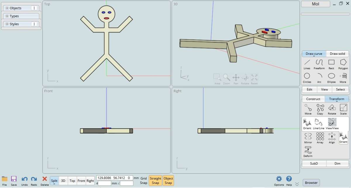

                    #828710
                      Here you go Nigel. Drawing a 1-2-3 block three times. First looking down on it, then looking at the front and then looking at the side. All end up in the same orientation but you need to sketch what the part looks like from each of those view points. Click the full screen icon bottom left once the video starts.
                      Those parts will then display the “right way” up and be inserted into an assembly the “right way” up.
                      Don’t over think it as David, Julie and I have said once you put a part into an assembly or start machining it you are quite likely to have it orientated in more than one “way up” Hopefully you would not draw two wheel, just assemble using one wheel file and fit to the assembly so each faces the right way.

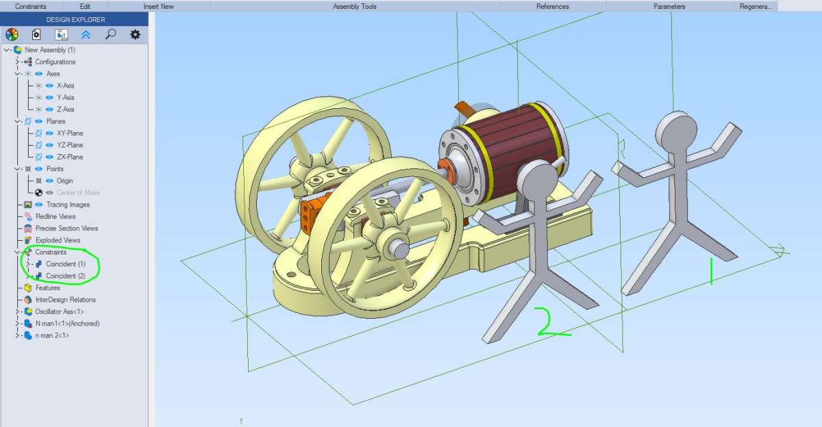

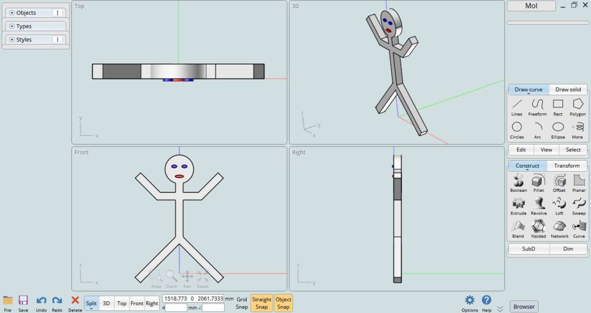

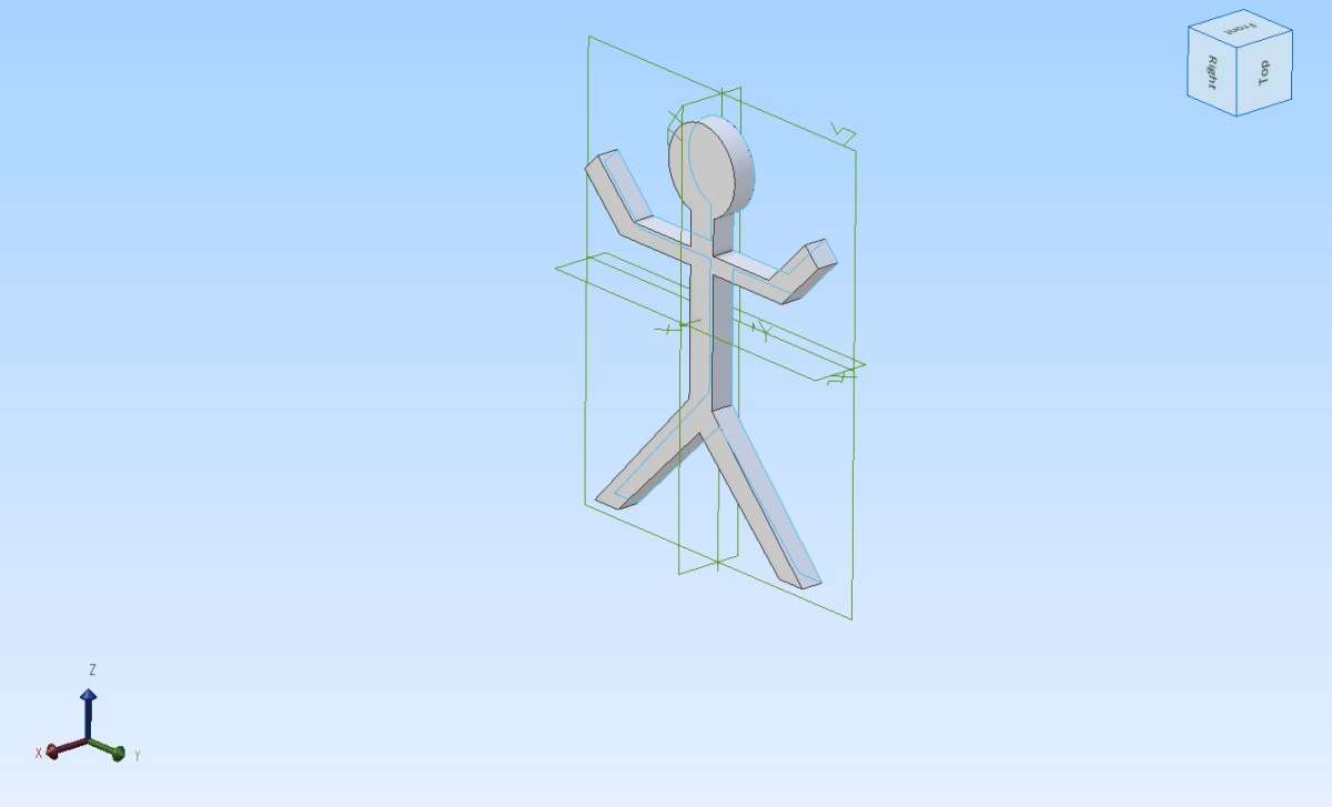

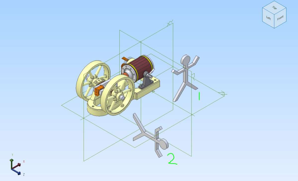

                                    Martin. In Alibre both the View cube and the X-Y-Z arrows are not orientated as they would be if using a mill.
                                    What Nigel wants is to orientate the part so it looks the right way up in it’s intended final position and for that to match both the cube and arrows. Quite simply it Won’t.
                                    Drawn to look the right way up on the screen with his head at the top, face towards the front and side at the side. But his head is pointing in the Y axis not upwards towards Z
                                    N 1
                                    Now you can draw it so that his head faces up towards Z but then that throws off the faces of the cube.
                                    n2
                                    If I wanted to insert the two versions into an assembly, they would appear like this when I went looking for the file.
                                    N 3
                                    And when inserted into the assembly look like this, as Nigel has difficulty arranging parts within an assembly the suggested man that is the right way up should make it simpler for him if he uses the first method shown
                                    N 4
                                    Like Julie I have no problem constraining the men so they both look right.
                                    N5
                                    As I have said up until a few years ago Alibre did not have  aview cube and I seldom use it now. I also just drew the parts as option ! so they looked right on my screen. It was not until I got the CNC that I found that when imported into F360 my man would be laying on his side rather than flat on his back ready to be profiled to shape. Not a problem as it is easy to orient the stock.
                                    Even with F360 having what people here say is the Norm eg Z up. If I drew that man standing with his head Up I would still have to alter the orientation if I wanted to profile the shape so he was laying on his back. If I also wanted some screw holes in the underside of his feet so he would not fall over I would need to do a second setup so his feet faced to +ve Z so which of those three is the Norm.
                                    Just like if you draw a part in MOI, Solidworks, etc. Which way is up if you need to machine from all six sides of a cube?

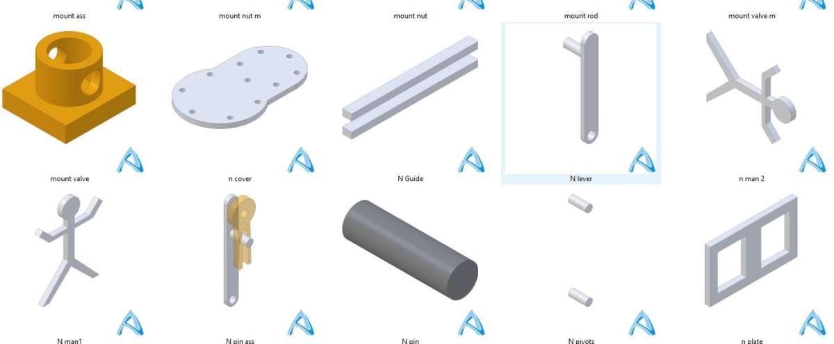

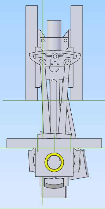

                                      I am sort of used to Parts entering the Assembly screen in all sorts of odd ways, sometimes twirling gracefully like falling Autumn leaves, and settling any old where in any old orientation.
                                      I now use that “Componement Placement” tool’s “Free” mode to grab them by the scruff of the neck and twist them into near alignment and near their locations. I’d prefer a more definite approach but can never align them in their own Part starting-sketch so that happens.
                                      I’ve also mentioned that Cosntraints are on this Earth to baffle me. When I first created the image below I accidentally crossed the eccentric rods. Correcting that took several attempts and many red-lit constraints, and at one point almost the entire list of well over twenty of them lit up!
                                      From this I will create partial drawings to gauge the overall size of the machine, so I can design the casing etc. It has to occupy a definite envelope in the chassis.
                                      Screenshot 2025-12-15 101812
                                      Oh…. I thought I would be unable to enter said image (screen-shot thereof). The “Insert image” symbol has been replaced by a little square.

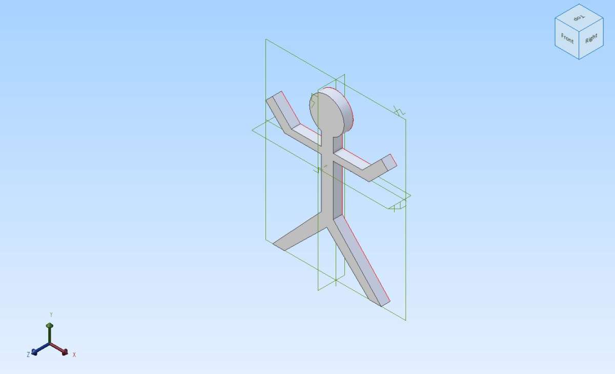

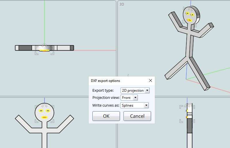

                                        I tend to view the X,Y plane as the ground or floor plane which means the Z axis is up from it. I suppose that is how many others might see it as well.
                                        I drew your stick man accordingly in Front view and it seems clear enough to me:
                                        Capture

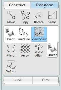

                                        However, he’s not in the correct orientation for milling, so it’s easy to put him in the right orientation by using one of the Orient tools:
                                        orient
                                        Like so:
                                        Capture
                                        Having said that, if it’s just DXF curves that need outputting then I don’t have to reorientate him as I can export the Front view, which automatically writes the curves on the X,Y plane for milling etc.
                                        As here:
                                        DXF
                                        Martin.

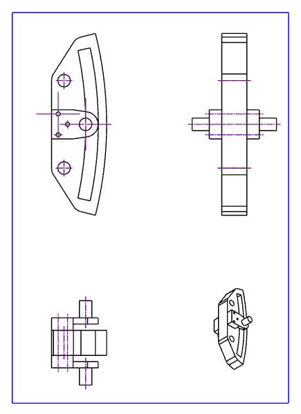

                                          So when I made the drawing version of that engine’s end view above, I explored the Drawing menu more carefully. This connects dynamically to the source Assembly and that in turn to its own source Parts, so modifying a Part carries automatically to the Assembly hence Drawing – very valuable. (Provided you use it with care, especially avoiding a change that may plot, but is absurd physically!)
                                          I don’t know if your CAD system has similar but I realised that when deriving the elevation drawings the orientation of the Assembly is less vital.
                                          This because you can rotate a thumbnail control version of the Assembly by 90º steps and choose any of the resulting orthogonal views as the “Front”. So although that above shows one end of the engine, I flipped it upright, made it the “Front” in the menu, switched off the other elevations as they’d not fit the A4 paper, and transferred it to the paper layout. It’s easy to add a note that this is actually the Off-side End Elevation.
                                          I saw many of the professional, (SolidWorks ?) drawings at work had a small isometric image in a quiet corner to help in understanding the main elevations. The Hemingway Kits drawings use the same convention. Alibre Atom also offers this service, though I’m not familar with how to use it so it doesn’t hog the whole page!
                                          (The various CAD makes can be very different, of course. TurboCAD, which I started with, offers “World” and “User Defined” co-ordinates, but its default XY base for both 2D and 3D is the “World Plane” as the floor, and in 3D mode growing the extrusions or moving objects vertically is by plus or minus (Z). It puts each item in a little “cage” with its own axis-indicators. However, the main assembly-construction method places each new part’s base-sketch on a “workplane” usually but not necessarily an existing surface of the assembly, so feasibly at an angle to the world plane. Its elevation / isometric view tools are similar to those on Alibre’s tool-bar, with isometric SE as a home orientation, but it has no equivalent “View Cube”. )
                                          #828830
                                              To avoid taking up the whole page, just set a smaller scale for the isometric view – unlike the orthogonal projections, it is not tied to the same scale as the primary view.
