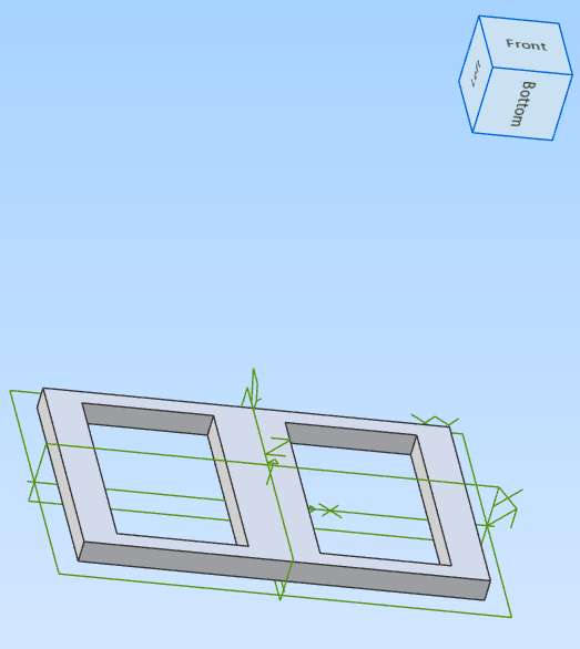

      Is there any way I can predict where things are going to face, and for the view-cube to agree with the model, please?
      I had to re-draw this plate from scratch because the first attempt was totally away from the default XY, Xz and XY planes, was on its side, the view-cube bore no relation to sense;  and it all prevented any attempt to build on it. It’s not quite finished: it needs some other features adding.
      I need everything symmetrical and consistent with all three main planes, the right way up and all views indicated logically if I am to have any chance of assembling other bits to it!
      Those have to be symmetrical with the plate by the ends or the sides as appropriate, and might need redrawing too if they confuse things by importing all sorts of XYZ planes not matching the primary ones.
      I managed to make the new plate the right way up and sitting on the XY plane, the vertical plane along the centre and Z pointing upwards, but the view-cube is wrong so is very confusing. The manual tells how you use it but not as far as I can see, how to set it to the drawing.
      In this image we are looking down on the top of the plate with its front and left faces visible, but the view-cube calls the intended top, the front. In other words the cube’s left side is correct but the cube is tipped backwards by 90º, and should show Top and Front.
      I could just turn the thing off but there may be times when I need it to help me, and it won’t if the wrong way up!
      So how can I make all three sets of information consistent, please?

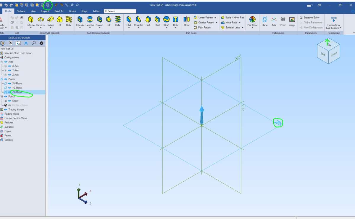

        Maybe David can help but the XY plane in alibre is more like a graph on a piece of paper where X goes along the bottom and Y up the side.
        This does not match what a machinest tends to think of a X & Y which are the the two horizontal axis of a mill.
        So basically if you plate is intended to lay flat you should draw it on the ZX plane.
        Your Icons are laid out different to mine but when you open a new part click the “isometric view” icon top left. Then if you want to draw looking from above click the ZX plane either down the right sid eor the lines on the screen and then activate 2D sketch.
        view

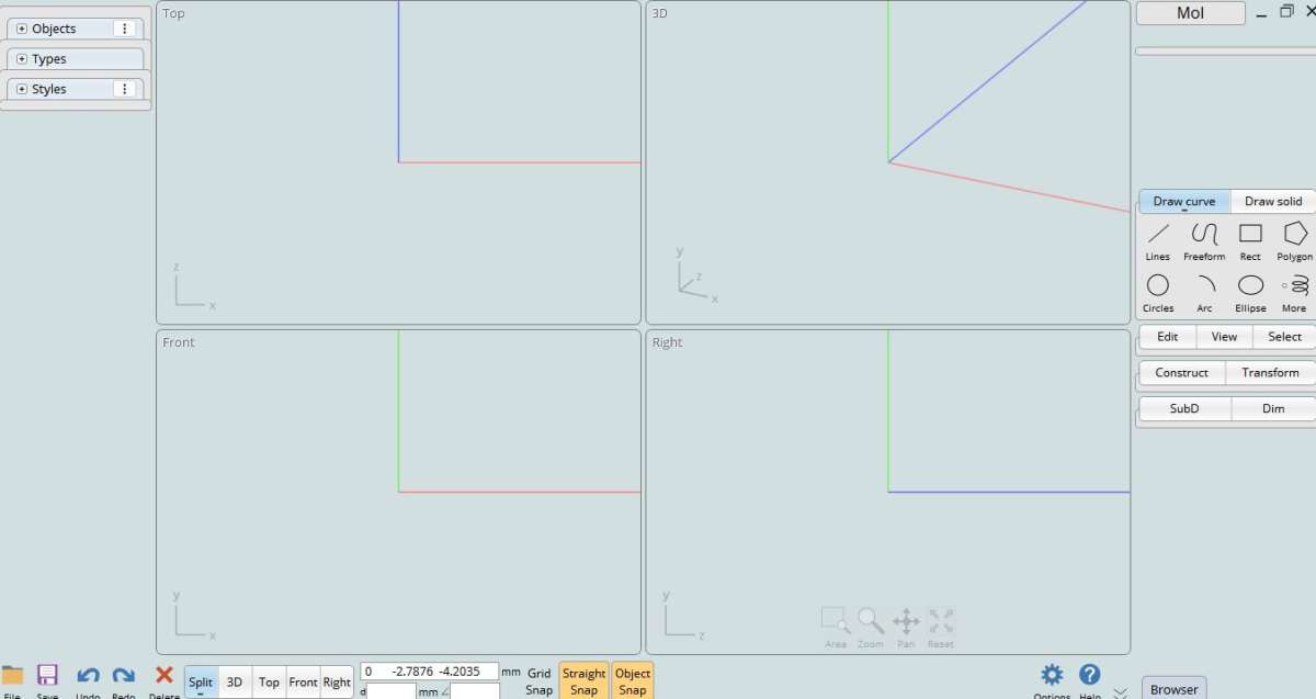

          I note with interest and bewilderment that this page from Alibre’s Help makes no reference to the related Axes
          https://help.alibre.com/articles/#!alibre-help-v27/view-cube
          Jason’s illustration, however, makes it clear that Alibre’s allocation of the axes is ‘novel’
          IMG_1297
          No wonder Nigel is struggling !

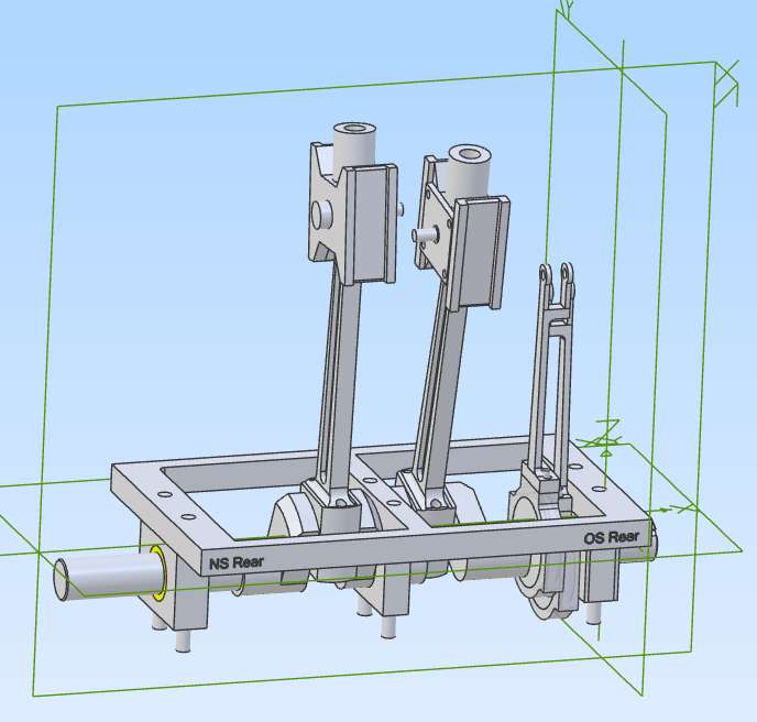

              I struggled on, added the remaining details then tried assembling the thing.
              It is the baseplate for my 2-cyl steam wagon engine, having realised an enclosed vertical engine has to be like a car-engine with the crankshaft below that plate. I’d not be able to assemble its original form physically, with the shaft above the baseplate, even if I could produce an award-winning 3D CAD model of it. CAD is wonderful for helping you design things impossible either to make or to work!
              It went vaguely well at first.
              I planted the three main bearings’ pairs of studs easily. The journals (in simplified form) went on with some arguing, and I added their bushes. “Fitted” the crankshaft – it even seemed to rotate without pulling through the journal walls, to my surprise, but showed the baseplate needed altering. Well, I could see that with the two real components!
              Completed that modification, then that was it.
              I tried to add one pair of eccentrics. They refused to co-operate and the constant battle ended predictably with the whole thing falling apart.
              Three or four hours to assemble barely fourteen parts… now deleted. Keeping useless data files only creates confusion and harder searching.
              Otherwise all I had achieved was redesigning the plate to accommodate the new suspended-crankshaft arrangement.
              Though I also spotted a previous sub-assembly with a strange misfit between its only two components. A dimension mistake, inevitable when having to draw a mechanism from its parts before seeing if they can actually fit together.
              At least redrawing the plate from scratch meant it was the right way up and symmetrical with axes pointing the right way, despite the view indicators being upside down. I assume there is a subtle trick to making all the parts and assembly orientations, planes, axes and view indicators all correct, logical and coherent, but I don’t know what it is.
              It seems two areas of Alibre Atom too difficult for me are orientation and plane manipulations, and assembly constraints.

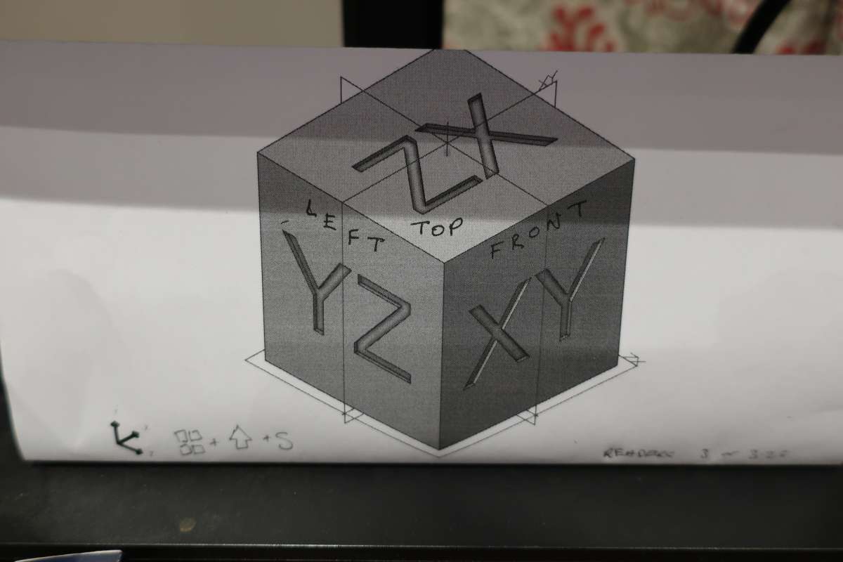

                ..one of the first things I ‘made’ was this cube to help orientate myself.
                IMG_2816

                    “Plane manipulation” is really part of the assembly process using constraints.
                    If you had that plate as your first part in a new assembly you would just constrain say it’s bottom face to the ZX (horizontal plane) on the assembly screen and then build up the engine from there.
                    As I have said several times before it does help to make thing seasier to assemble if a part is drawn the right way up visually to start with but is not the end of the world if it is not. I don’t tend to use the cube that much, maybe as it was not originally a feature of Alibre so I managed without it for  along time.
                    Another way that may help you when starting a new part would be to first move the cube about to the face you want, in this case pull th ecube until you can see “top” and then click towards the middle of that face of the cube. You will see the area around the word top turn dark blue when the mouse is in the right area and click that.
                    You will now have the correct plane showing on the main screen so click that to turn it from green to blue and then upto the top left and click “activate 2D sketch”
                    For the umptenth time don’t delete send the bundle to David, if nobody can see what you are doing wrong they can only partly help.

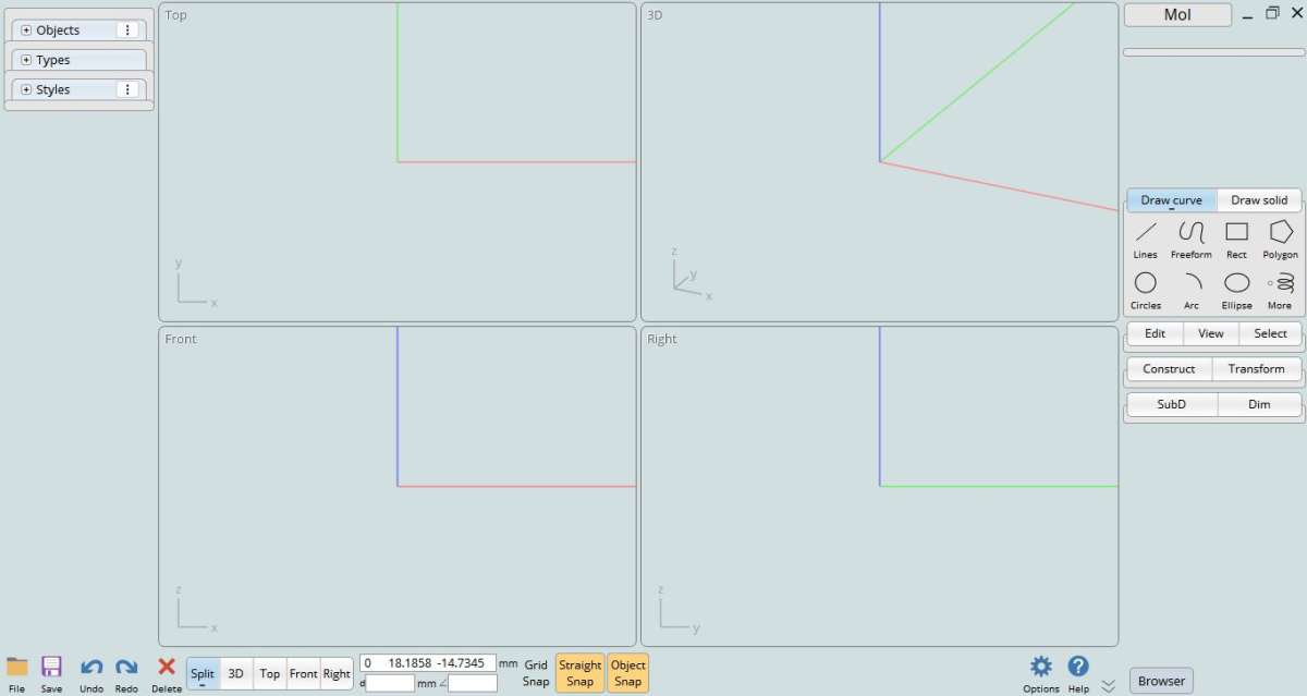

                                              On JasonB Said:
                                              On David Jupp Said:
                                              Whilst I sometimes try to be consistent in how parts I model are orientated, I usually don’t worry about that.  I simply model each part in a convenient orientation, knowing that I can re-arrange when I assemble the parts together (as you do in real life).
                                              This is where Nigel has the problem, he has difficulty re-arranging the parts in the assembly so it would help him to have them the “right” way up to start with.
                                              The answer should be that Alibre is like a professional draftsman standing at a near vertical dawing board with drafting head, other CAD which has XY flat is like a child using a crayon on a flat bit of paper🤣🤣🤣🤣🤣🤣
                                              I was completely outraged by this statement by JasonB and its implication against my MoI, until realising that with a simple change in settings, I too could become “like a professional draftsman standing at a near vertical dawing board with drafting head“. So now I’m in full agreement with him. 😉
                                              Martin.
                                              Before.
                                              Capture
                                              After.
                                              Capture2

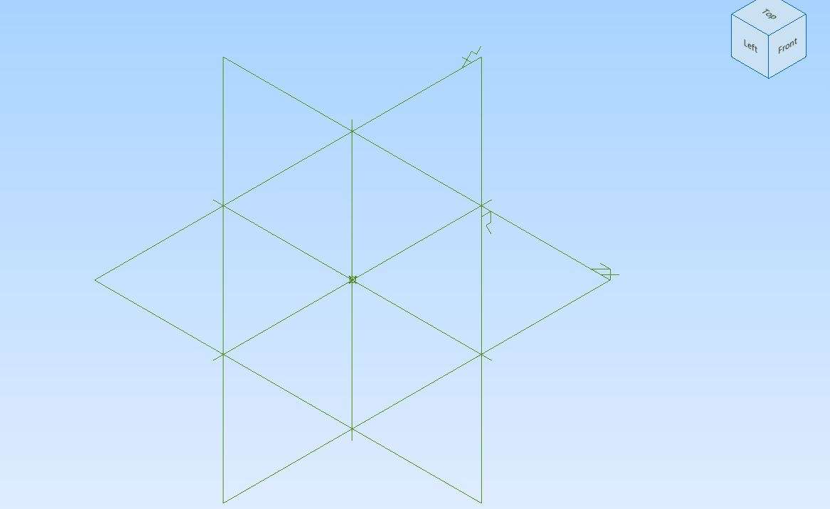

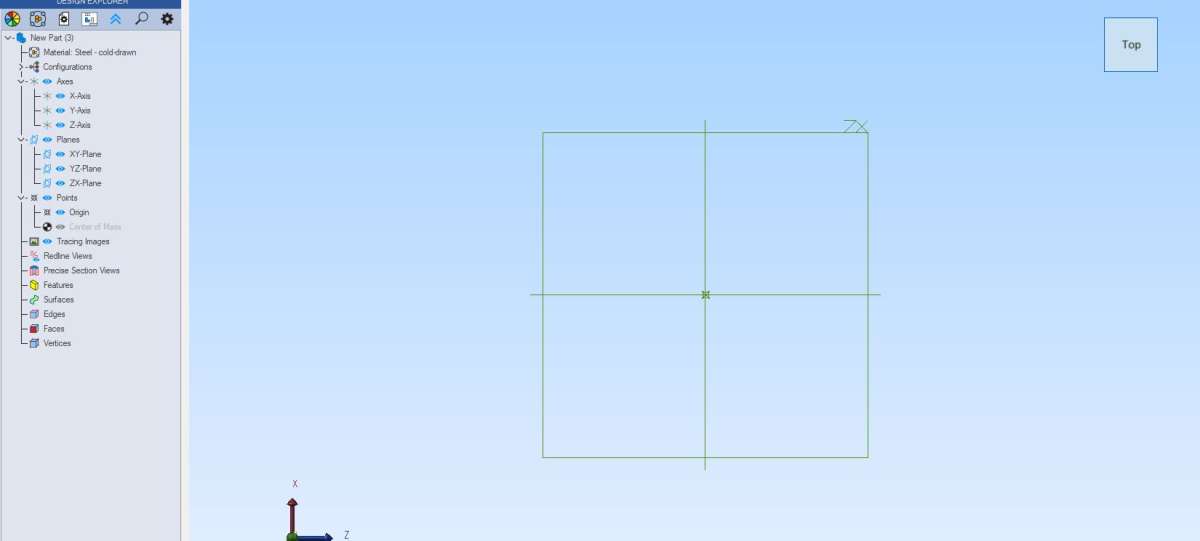

                                                  This is where my two suggestions of choosing the plane from the main screen or the cube should make it easier for you.
                                                  With your screen showing this you can simply click the flat one to draw your plate on and then click “activate 2D Sketch.
                                                  N1
                                                  Or if you move the cube about and click “Top” that will display the plane as if you were looking down in plan, click that plane and then “activate 2D sketch”

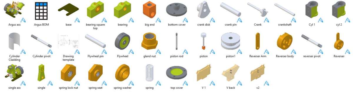

                                                    Anyway, using David’s advice to separate large assemblies into sub-assemblies, I managed to put the below together.
                                                    They are :
                                                    1) Base with its simplified journals and studs, with big “engraved” labels to show which way round. (The crankshaft has a longer nearside end to carry the first transmission pinion.)
                                                    2) Crankshaft with eccentrics,
                                                    3) Eccentric strap (as one-piece rings) plus rod – I saw and corrected a dimension mistake in that sub-assembly,
                                                    4) Connecting-rod, with small-end bush. The big-end is a 2-part cast-iron block without liner, not detailed here.
                                                    5) Crosshead.
                                                    I erected the engine in that order, then spotted a big dimension error in the eccentric-rod clevises: they do not line up! So I produced and printed a full-size, dimensioned drawing of that area only, to help me assess how to correct that cock-up.
                                                    The eccentrics are the type with internal retainer but so as to be able to turn the bearing surfaces straight through on both strap and sheave, I have grooved both parts, to carry an inserted sheet-metal ring like a circlip.
                                                    I gave the crankshaft short keys to constrain the eccentrics, but it still wasn’t easy, with a lot of constraint errors occurring.
                                                    Screenshot 2025-12-12 171230
