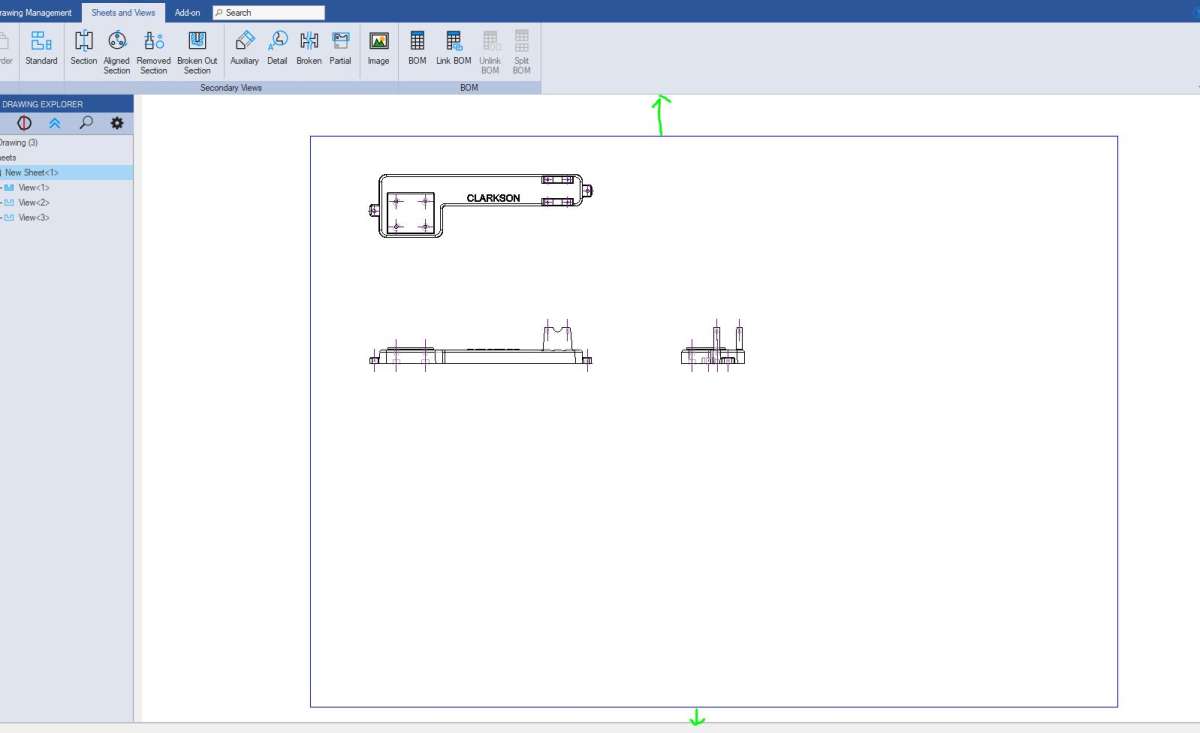

      I created a drawing and wanted to print it.
      Print Preview merely shows the images filling a white panel against a plain grey background, with no relationship to the paper. This implies it will expand the image right to the margins, irrespective of any scale you set.
      It didn’t do that. Instead it printed to my set scale but with the image hard against the top and left hand edges of the paper; not symmetrically to the sheet.
      The Print menu offers Portrait / Landscape and the Quality list but refers to the paper size as “Statement” with no list to select from. I’ve never seen that term before, in any software.
      I’ve just tried printing with Scale to Fit engaged but that made no difference: the images and notes are all up the top-left corner as happened without Scale to Fit.

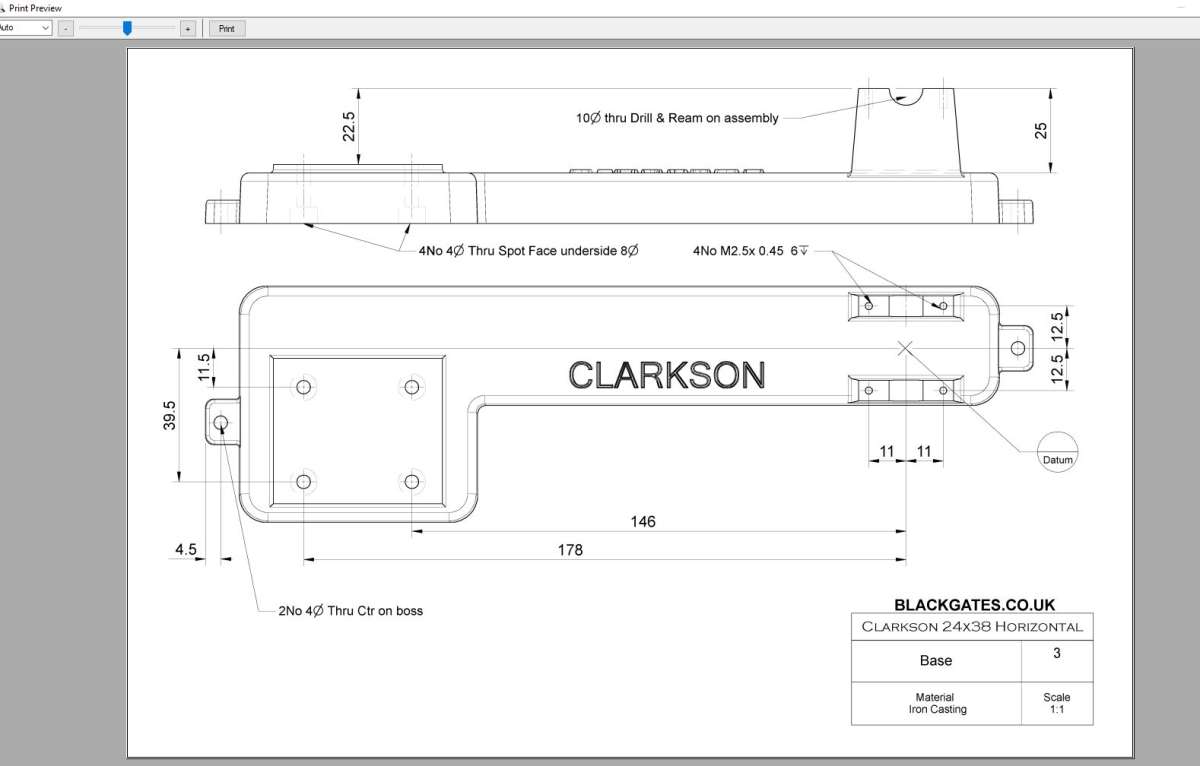

        Nigel. When you started the drawing what size and layout did you choose for your paper. That is what will set the size, the rest of what you are talking about relates more to your printer not what you have done in Alibre. You scale the elevations and plans to fit that initial sheet size chosen.
        This is the preview I get of a selected A4 sheet and I scaled the part to make full use of the sheet at the initial stage before adding dimensions and notes.

            When creating the drawing, you should see a (almost certainly blue) sheet outline on screen – that represents the paper that you’ll eventually print on.  You can manually position your views inside that rectangle.  You can change view scale if desired to better fill the sheet.

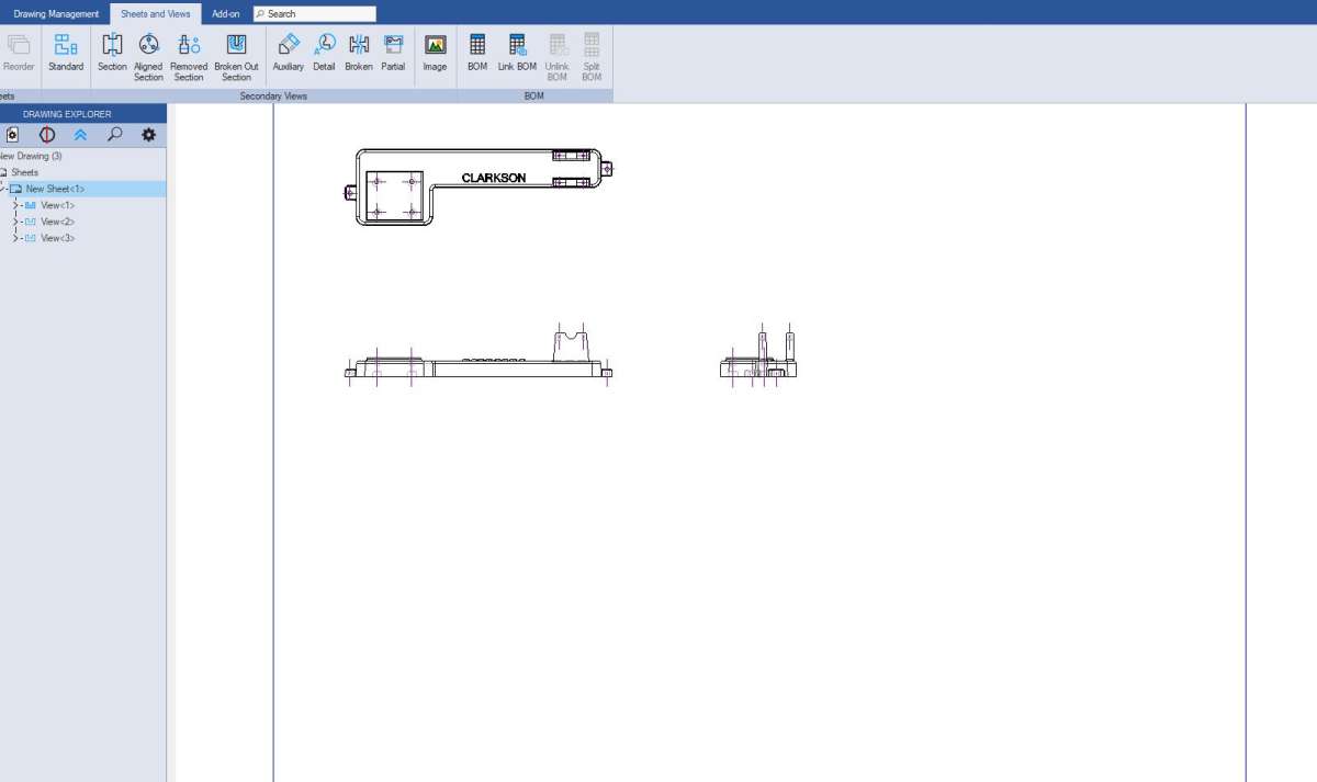

              Just to expand a bit on what you may be experiencing Nigel. If I start a drawing on a blank A4 landscape sheet and accept the three default views at the scale Alibre comes up with and position them on the sheet I get a screen that looks like this. You only see the two side borders of your “sheet”
              default 1
              Zooming out a bit reduced the white “paper” which is bounded by the blue box that was previously touching the top and bottom bars.
              default 2

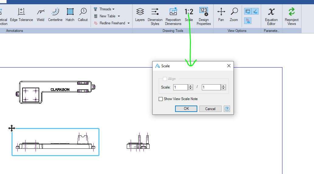

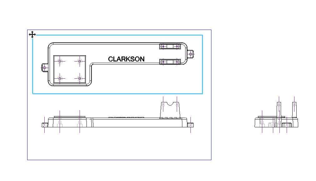

              I suspect you have just zoomed in on a similar layout and added your sizes etc. What I tend to do first is set a scale that suits the job in hand. If I were wanting to put multiple parts on that sheet then I would not alter the scale much if at all. But like my earlier post if I just want the sheet to show that part then increasing the scale of the part on the drawing is the way to do it.
              First click the main view so the box with the corner arrows shows up
              defult 3
              Then select scale from the top bar (may be a bit different on your Atom) and the box that comes up allows the scale to be altered I changed from 1:3 to 1:1, click Ok

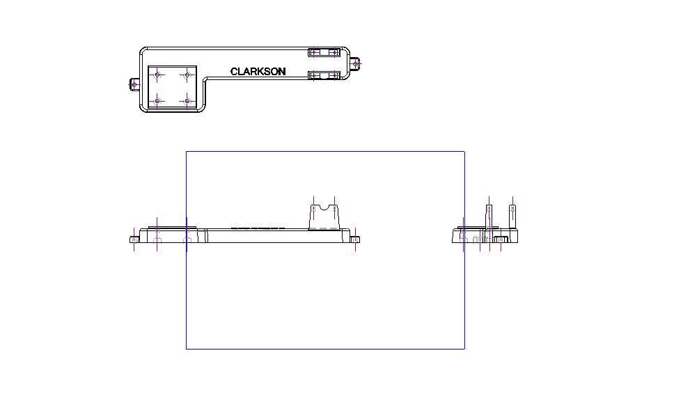

              default 4
              This increases the scale of all elevations so now they don’t fit the sheet (Sheet is the rectangle)

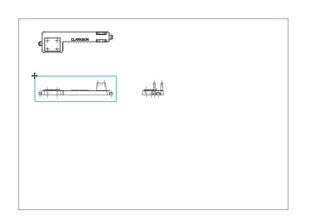

              default 5
              So now you can drag the plan and elevation sto where you want them on the sheet, click each to bring up the box with corner arrows and then drag, they will only drag one way as they need to keep there relationship to the main elevation correct in the other direction. I don’t want the end view so just left that off the sheet but could depete it.

              On the printer front “Statement” is an American paper size similar to A5. and not part of Alibre so must be related to your particular printer.

                  I’d not previously known “Statement” as a paper size, but that led to look more closely at the menus. The printer is a Hewlett-Packard ‘Deskjet’ and its driver offers a very long list of sizes.
                  I’d missed selecting the correct size at the right point, before adding the drawing itself. With that sorted, the layout rectangle re-appeared. I was also able to add a basic “title block” – just a Note holding suitably formatted lines of text, the second copied, pasted and edited from the first.
                  The missing centre-line was indeed by the two arcs being very slightly non-concentric.
