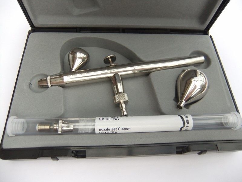

                  AirbrushI have the Harder and Steenbeck Ultra 2 in 1 It come with a .2 and .4 needle and nozzle set as well as a larger cup size. I find it has great control also spares are available if needed
                  I got mine from Air-craft.net They are in Fort William UK great service(Just a happy customer)
