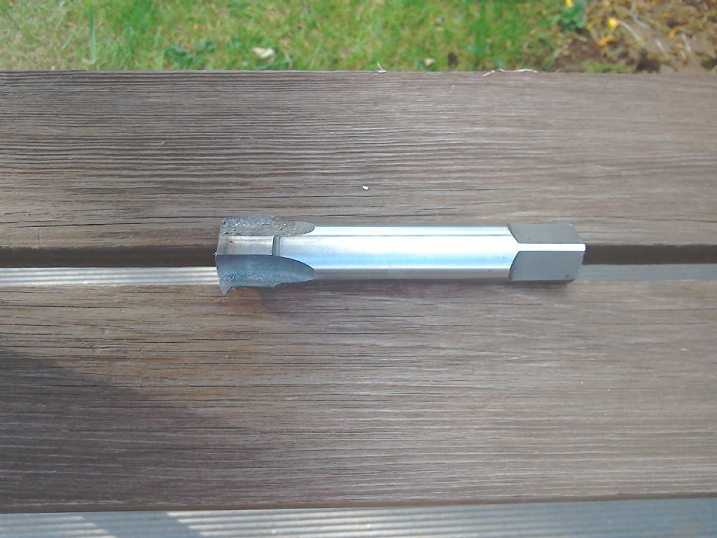

                Martin, I'm intrigued as to how you use the 1" tap for this process. Can you give me any more details?

                Martin Connelly
                  @martinconnelly55370
                  I think it is on the lathes.co.uk website that it mentions chuck registration on spindles being simpler than you would think and that a loose fitting backplate will still register on the spindle satisfactorily. It's in the fitting a chuck and making a backplate page. So as long as the plate you have screws on ok then it may be suitable.
                  I only recommend this if you have a suitable tap you no longer want!
                  Martin C

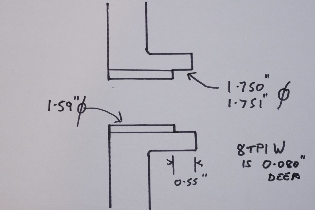

                    I have made several S & B backplates with the 1 3/4 X 8 W threads. When first plunging headfirst into the scary world of threading, it will be best to perform the actual threading part with the lathe switched off. Make a winding handle which fits into the left hand end of the spindle bore. You then have time to think about what you are doing without worrying about crashing the lathe.
                    I recently saw a couple of backplates for sale on ebay with the thread, a 5" and a 6". I bought the 6".

                      #473078
                        Jim, it may help to point out that martin's modified tap is held in the tool post and used like an internal threading tool, not wound into the hole. The advantage of using a tap of the desired tpi is that it will give the correct crest and valley radius for the thread which are not so easy to accurately grind onto an HSS tool
                        #473079

                              Why go to the expense of a 1" Whitworth tap and then destroy it?

                                        Old Mart, as I said, only do it if you have the tap and no longer want it. I think from memory this was a salvage from a shattered end.

                                            I expect a damaged tap with a 8 tpi thread would be as rare as hens teeth. I have made a sketch of the thread which shows the main dimensions. The starting bore of the thread is not critical, it could range between 1.59" and 1.614". I have always gone for the smaller size using carbide inserts. The size is right when the first sign of the thread shows in the 1.75" register. It would take multiple passes from just touching the bore to be threaded. The register size needs to be no less than 0.001" greater than the measured spindle size, or it will be very difficult to screw the plate on.
                                            I would go 12,10,10,8,8,7,6,5,4,3,2, and 1 in thousandths of an inch, keeping an eye out when close to the end for the witness mark on the register.
