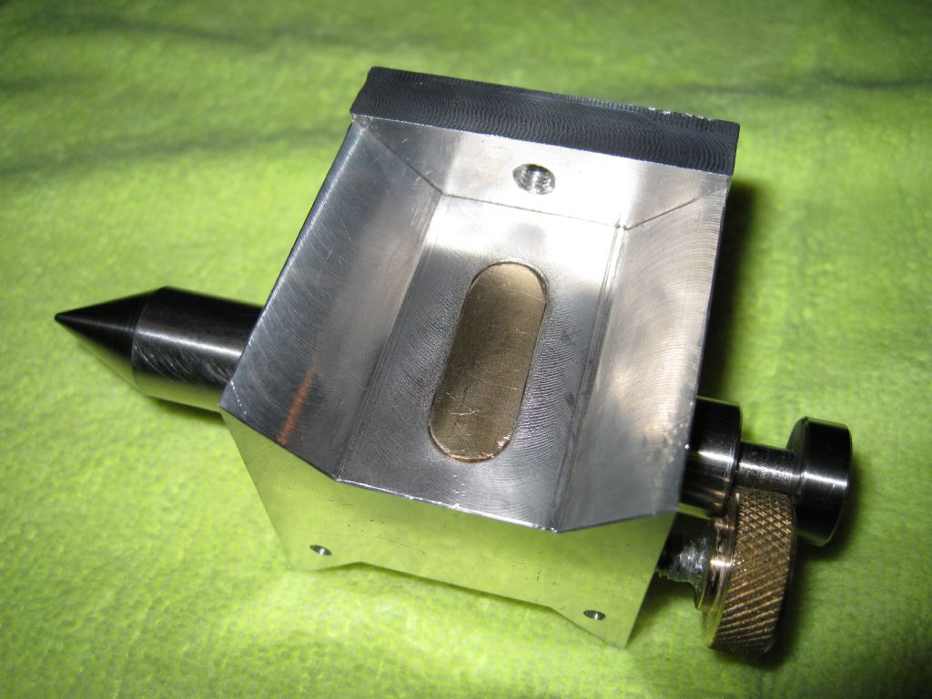

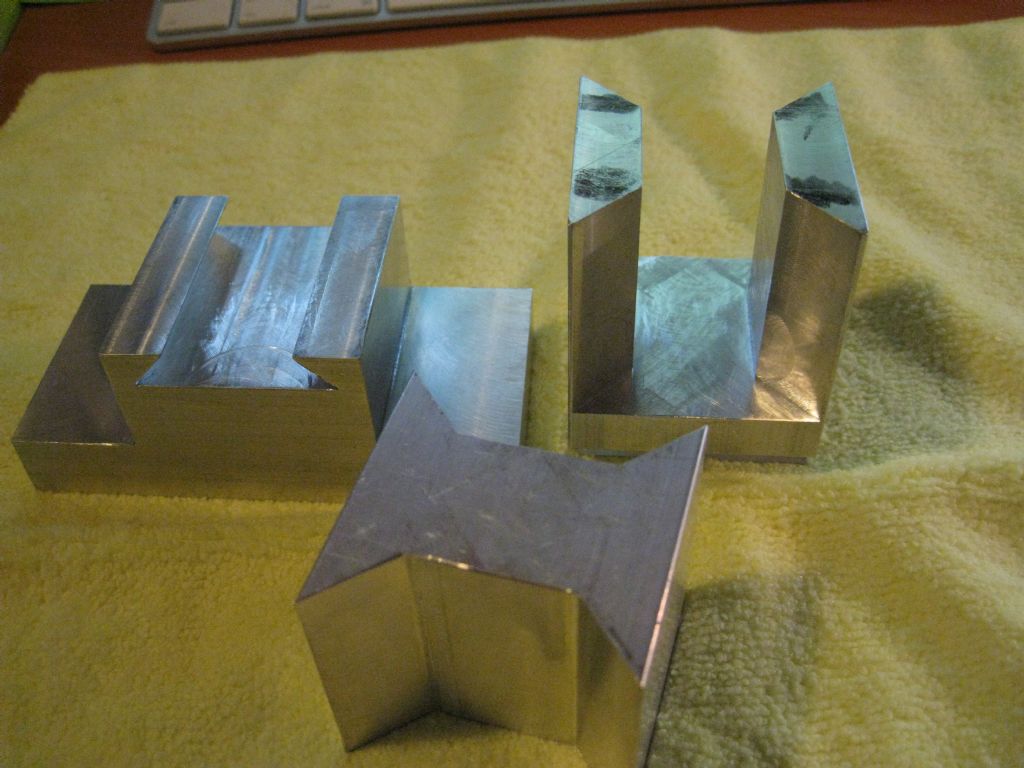

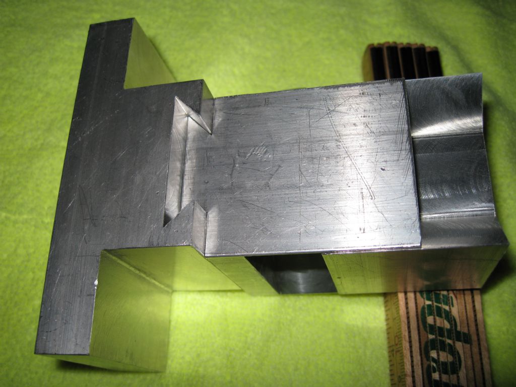

      Hi

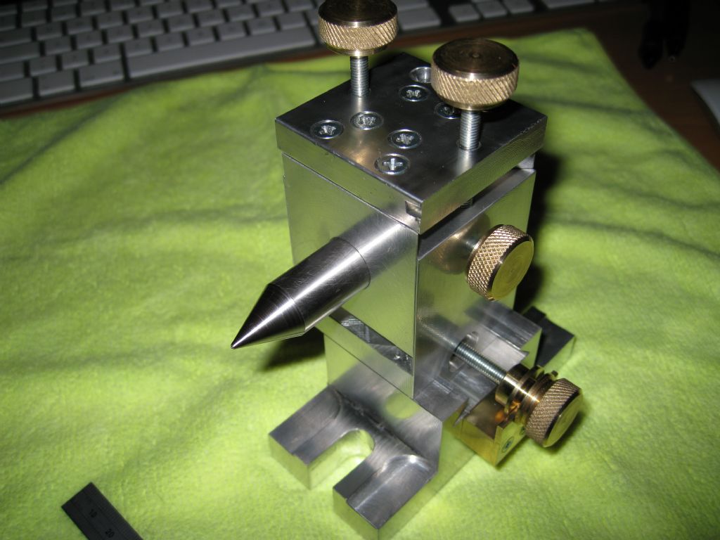

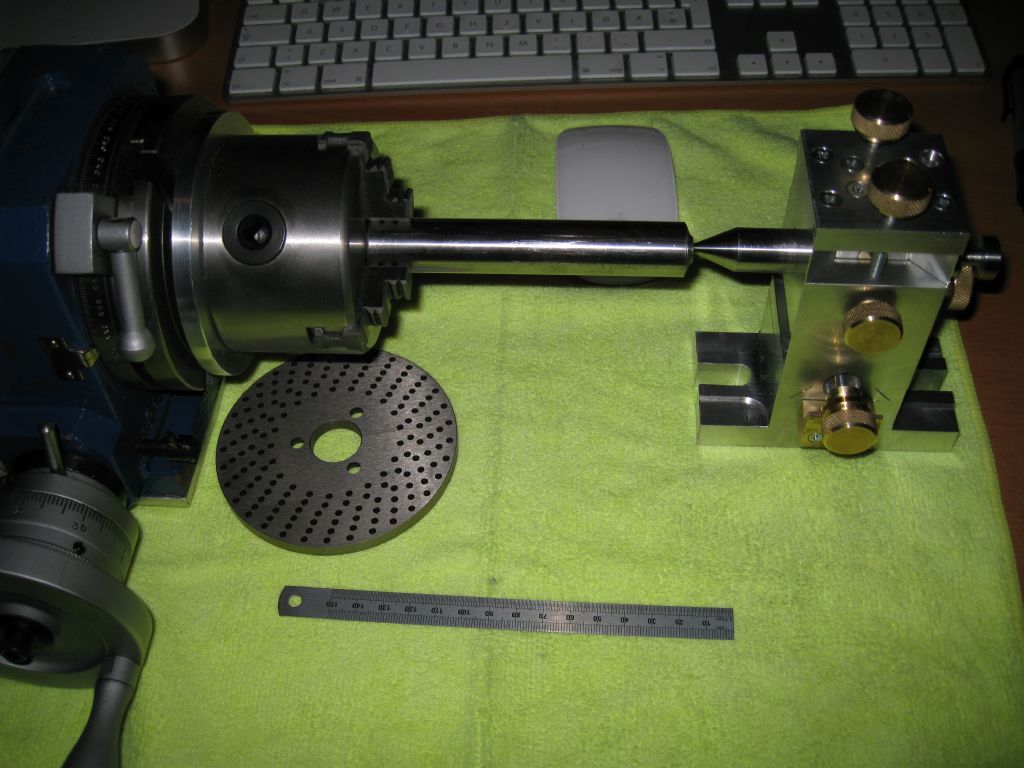

      I have startet to make my self a Tailstock for my Vertex HV 4 and I do need a little advice on the best way to make the adjustment of the unit
      Johnny Gleden

        JohnF
          @johnf59703
          Johnny, personally I would re-think your project, why do you need both lateral and vertical adjustment? Why not stick with the lateral adjustment so you can align with the table centre when used as a dividing head but the height need only be the same as your table centre which is easy to ascertain with slips or a height gauge etc.
          I would also make a tenon for both the table and the tailstock to suit your mill table T slots thus once set you will rarely if ever need to re-adjust the tailstock except after moving it for some reason. For this adjustment consider fixing a plate on each side of the base block with a tapped hole in the centre for a grub screw to centralise the main pillar similar to that used on many lathes.
          When in industry I can't recall using a dividing head with such an adjustable tailstock but many of the imported ones have this type of adjustment.
          Just my thoughts. John

            Hi
            Thank you, thank you very much for the answer and the good advise
            Also my question might also have been a little strange and not that clear…English is not my native lanaguage
            You are perfectly right, I should not need the vertical adjustment as you say
            I will rethink and make the changes, skip the vertical adjustment and only keep the lateral adjustment
            I will also look into the idea with the tenon for both teh table and the tailstock
            Actualy this where my problem… my silly idea where to complex..stupid me as a greenhorn to the hobby where thinking that I did need a lot of adjustment to make it work well
            I almost whent down in the "basement" and had the idea to put all my machines up on ebay and go back to the sofa and the TV
            It is not the first "peaces" that will end up in the drawer…waiting on som other clever idea from the back of my head
            When this "big" ide hit me…to make an tailstock with lot of adjustments…belive it or not, I where sober
            Johnny

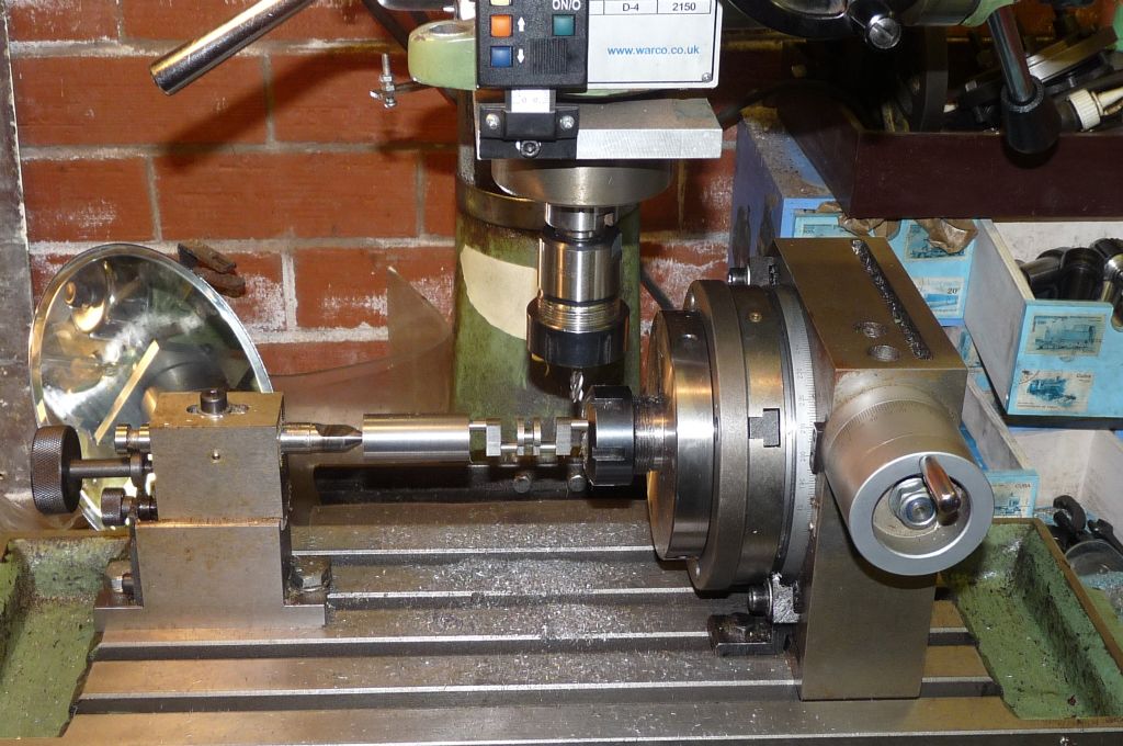

                The one I made as John said . I found centre height with slips ect and fitted a tenon and  sideways adjustment
                 only as you can see it was fabricated using steel .Notice rule and pointer for setting depths and micrometer dial  Keep metal working
                Regards Nobby

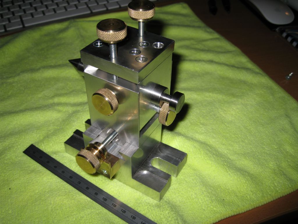

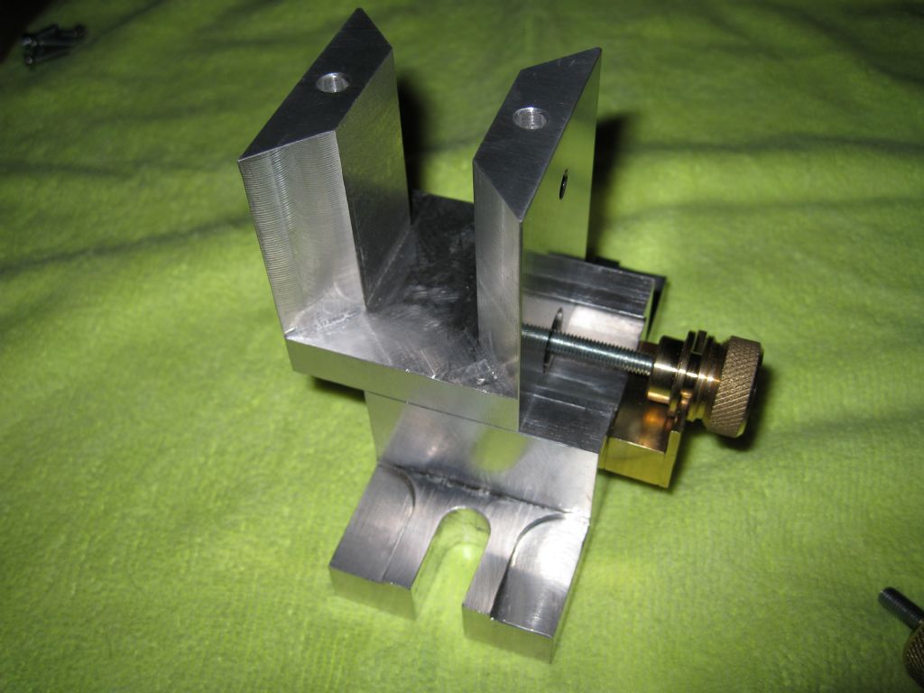

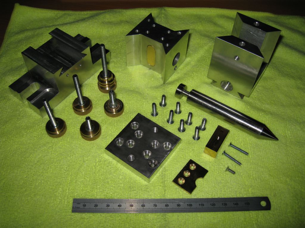

                      Hi
                      Thank you all for all the help and advice

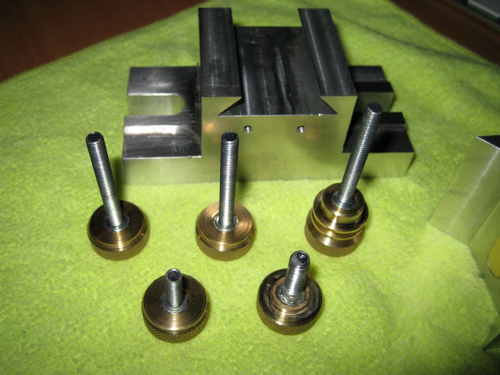

                      Finally I am finished with the parts and the unit
                      Broke a tap..and some other small faults… her and there…the "finish" do not look nice at all, but it it is working and it is my first parts ever made… I will hopefully learn……
                      I am able to adjust the tailstock sideways ( 20mm away from the knob-10mm against the knob )
                      Adjustment up/down ( 73mm – 100mm )
                      Johnny

                          Hello Johnny Gleden
                          That is a great first project piece, nice to see a piece of original design too. Clearly the quality of your piece shows great skill in working with metal. What machines did you use to make it?
                          The opposing dovetails that support the slide for vertical movement are an intriguing concept. If I understand the photographs correctly there is a brass screw that clamps the the vertical carriage by pressing against the side of the carriage.
                          I wonder a little about this? does it have a tendency to push the dovetail that holds the set screw away from the central column? I suspect it might.

                            Hi
                            "John"
                            Thank you for the links
                            I do not have any skills in metal work, I am actually a retired Plant Manager from the printing/packaging industri What I have learn is from this website and from Youtube..and of cause by failing/trying, I still have all my fingers where they belong.There are a lot of smart and skilled people on this forum so it is a good place to collect some skills and information .Lot of people on this forum are like an big "engineering manual " online
                            I did use a Chester DB8VS Lathe and a Chester Champion 20VS mill I did bought late 2011
                            Terrible machines if talking about quality and accuracy. I have spend months/year adjusting the machines, but the machines are actualy only good for making small garden fence wood poles, if you put them in the back of the house and not in front where everyone can see them
                            … life is to short to spend time with this type of things……I am now saving money for some other machines to replace the ones I do have.I will give the old machines away to my brother as a mooring for his boat after I have removed the clamping levers from the mill and put them in a box as they can usable for locks on my tailstock
                            You are right..there is one screw that is moving the tailstock sideways. It moves very easy sideways and there is not much forse needed on the screw( knob) to make it to move ( tread inside the carriage ) , its also is actually very stable in all direction, but the dowtail need to be made very accurate, if not it will make some movment if it does not have a really tight fit or are made to tight to not move easy with the adjustment screw
                            I actually had a plan to make a lock to lock the part from moving sideways during use as a safety and to pick up eventually som slack in the construction, same as I did on the movment up/down with a lock screw, but I did skip the lock when I found out how stiff it actualy is after the assembling, but it it si clearly a week point if not locked….I do belive, if som heavy force will occure from the mill by heavy usage or by accident. I did test the tailstock with the Vertex table in the mill, but only with som light cut and easy testing to check all the functions….Huummmm..
                            Your right…..I will start to plan how to make an lock to stop the small movment that the tailstock might have in the sideways construction during use..I also need to order some corner rounding end mills, or to make me one out of silversteel or to make one from an used drill bit for use on the tailstock to improve the look and to get the edges and corner rounded
                            Johnny
