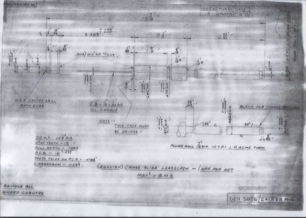

                              The Boxford drawing specifies that the threads are plunge rolled – for the imperial leadscrews at least.

                                              I think it's fair to postulate that the thread rolling was farmed out simply because the drawing only specifies the blank diameter for rolling, not the specific tolerances for the rolled thread which you would expect would be on the drawing if the rolling were done in house. The integral gear on the other hand has those specifics listed on the drawing.
                                              I'll see if I can dig it out and post it.
                                              The South Bend lathe that the Boxford was copied from had cut threads which we know because Larry Vanice has the leadscrew cutting machine they used at the factory.
                                              #428923

                                                  Here's the drawing, as found in the files section of the Boxford Yahoo group.
                                                  #428945
                                                    Thanks again, Pete
                                                    So we now know [pretty much for sure] that the English version was made for plunge rolling a 10tpi LH ACME form thread … 'though I can't quite decide whether, or not, the instruction effectively includes the rolling thereof.
                                                    [my thinking is that it probably does … because the ACME form is sufficiently well-prescribed to need no further detailing]
                                                    Mystery stll surrounds the [Boxford special] Metric specification though
