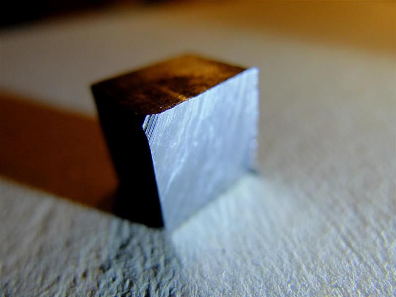

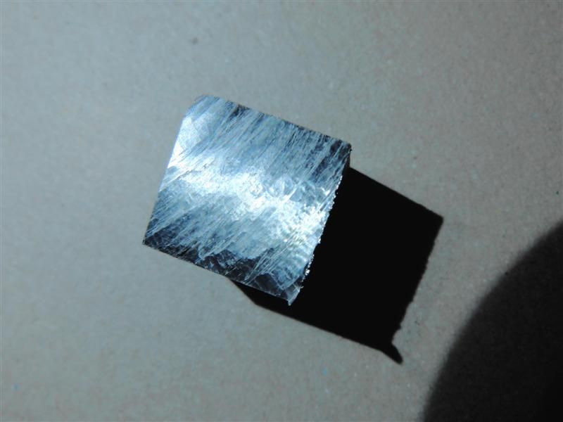

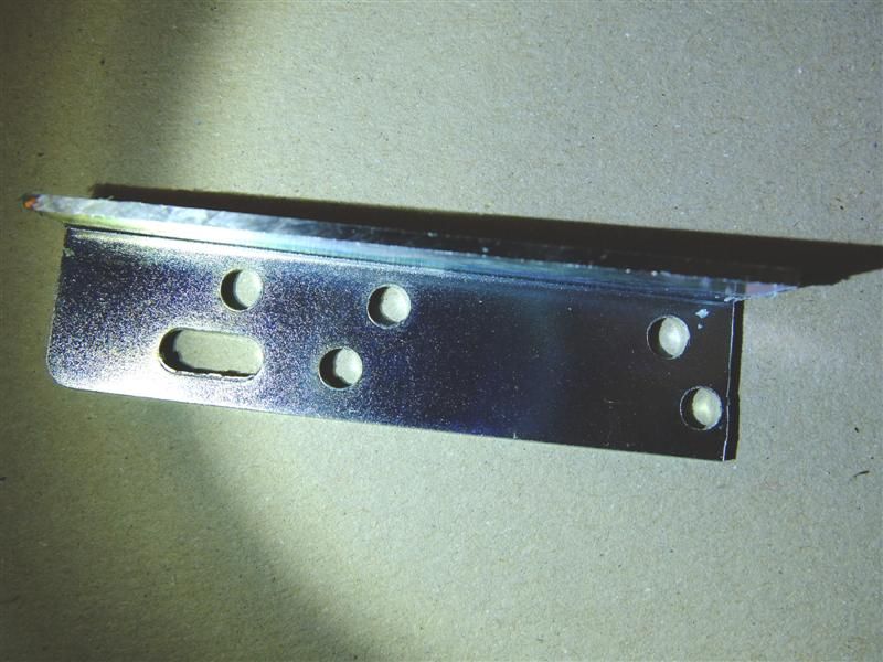

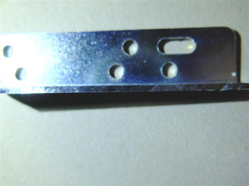

                                              Seems that I owe you something Roger, so here it is. Just as a test I did two cuts with the angle-grinder blade, one in a scrap bracket from 1.5 mm steel, the other a piece of 15 mm square steel. Both cuts done in say 5-10 seconds, I did not measure the time.The parts stay completely cool, and the (very small) chips are natural colour also.
                                              Then again came the difficulty to photograph these parts, in my pictures steel never looks like steel. May be the LED lighting has something to do with that?

                                                  Posted by Versaboss on 01/12/2015 22:14:14
                                                  "Seems that I owe you something Roger, so here it is…"
                                                  Thanks for that, Hans, I've been following this thread with interest. When I first looked at the link you provided I was surprised by the idea of using such a large tooth geometry for cutting thin sheet, hence my questions. However, as you have shown, there doesn't appear to be any problem at all – the edge of that piece of angle appears very clean, with no distortion. Can you tell me how close the cut is to the corner of the angle (i.e. how much support the side being cut was getting from the fold in the metal), and secondly, how was the piece held while being cut? Was the side with the holes simply clamped in a vice, or did you use any backing sheet (particle board, etc), and so on?
                                                  I had a look for anything similar at the local Bunnings store a few days ago, but while the blades that I saw all had a similar geometry, they were mostly larger, and only rated for cutting masonry or ceramic tiles, etc. I will need to look further, but I'm sure there will be something similar to the Kaindl product, although the Kaindl guard also looks fairly substantial.
