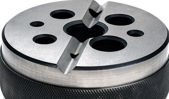

      A question for those who may know the answer…
      About two years ago, ARC used to sell a product described as 'Precision Bench Block', as shown in the picture below:

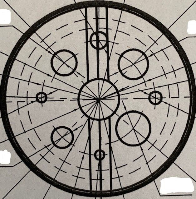

      It is an imperial size 3" in diameter, with nine oversized holes ranging from 1/8" to 5/8". The block is hardened and ground steel, ground vee groove to accommodate round stock.
      If you have a look at the top view of the drawing below, two of the holes are located in the vee groove, but they are not center to the vee. One of the holes is 6.6mm in diameter, and the other is 3.7mm in diameter (yes I know I am stating metric measurements here.. because that is how they are made). Anyone know the exact reason why their positioning is the way it is?
      There is no fault in the original drawing/specification for this product. This is exactly how it has been specified by an American importer, many moons ago.
      Some people refer to this block as a jewellers block, others refer to it as a block for gunsmithing. For engineering, I would suggest that it is a great support when drifting out pins and drilling small parts, but I am unable to figure out why the positioning of the holes are the way they are in the vee groove.
      I am unable to find an explanation.

            The offset 6.6 mm (1/4" clearance) might be derived from gunsmithing practice. Specifically removal of the link pin from 911 style barrels, as fitted to the Colt M1911 handgun and clones, which I believe is slightly off centre when the barrel is laid in the Vee groove.

                  I have an original Starett bench block in unused condition. Both holes in the vee are exactly central, no offset at all.
                  I would guess the drawing is wrong as I cant see any reason for having a hole offset as shown.

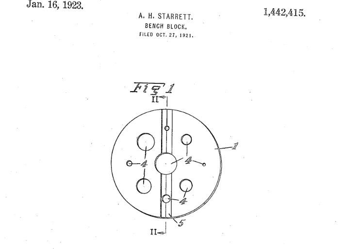

                    The original patent (US1442415A) was taken out Arthur Hermone Starrett in 1921. The patent drawing doesn't show the holes being offset, and no claim about them is made in the wording. It's all rather vague:
                    These holes may be spaced about the top of the block in any manner, but are preferably arranged in the symmetrical manner disclosed in Fig. 1. Intersecting certain of the holes is a diametrical centering groove 5, preferably V-shaped as indicated in Fig. 3.
                    and
                    The intersection of the groove 5 with the three sizes of holes makes it possible to set or remove a pin from a finished cylindrical object without danger of having its slip or dent, while the pre dominant flat top of the block will support any flat object.
                    My 50th Anniversary Starrett Catalogue of 1930 says: 'The V in the center is a feature needing no explanation.'
                    I usually suggest patent evasion for odd features like this – someone claiming their Block isn't a copy of the Starrett because of the differences. In this case, if I read it right, the Patent expired in 1940.
                    No mention gun-smithing or jewellery either, it's a general purpose engineering tool for driving pins in and out of round and flat work.

                              It also looks like the Starrett and Neil's have the holes on a single pcd. Having different circles is a small niggle.

                                  After reading Clive Fosters explanation and seeing the drawing on SpeedyBuilders link, it is making more sense as to why the maker we were buying from makes them the way he does…. especially considering that he predominantly makes for the American market.
                                  Bazyl: I had 6 pieces returned from a batch of 300pcs. based on the comment you made. However, it would be wrong to presume that the product was made incorrectly. I raised the question via this thread to get some explanation, which I now have. The maker we purchased from has been making this block in this way for a specific U.S. dealer for a very long time. The only reason we stopped buying was because there was no certainty on delivery. Our demand is low, and we have to wait to fit in with a high volume purchase… which only the U.S. could give.
                                  Plasma: Thank you for the photograph of the block you have from STARRETT. Looking at the photo, it gives an impression that the vee groove on the left is narrow (with larger hole), and wide on the right (with smaller hole)?…similar to SpeedyBuilders link?.
                                  S.O.D.: Thank you for the original patent details. After reading the various comments, I would suggest that this product has been modified/ or developed futher perhaps? to meet the demands of the U.S. importers market.

                                    Clive is right on the money. I have seen this type of block (with offset holes in the V) used to remove the link pin on Colt style 911 pistols. This I hasten to add was a gunsmith friend of mine, who operates in the USA.
                                    I believe that Brownells sell the offset hole block in the US for this very purpose.
