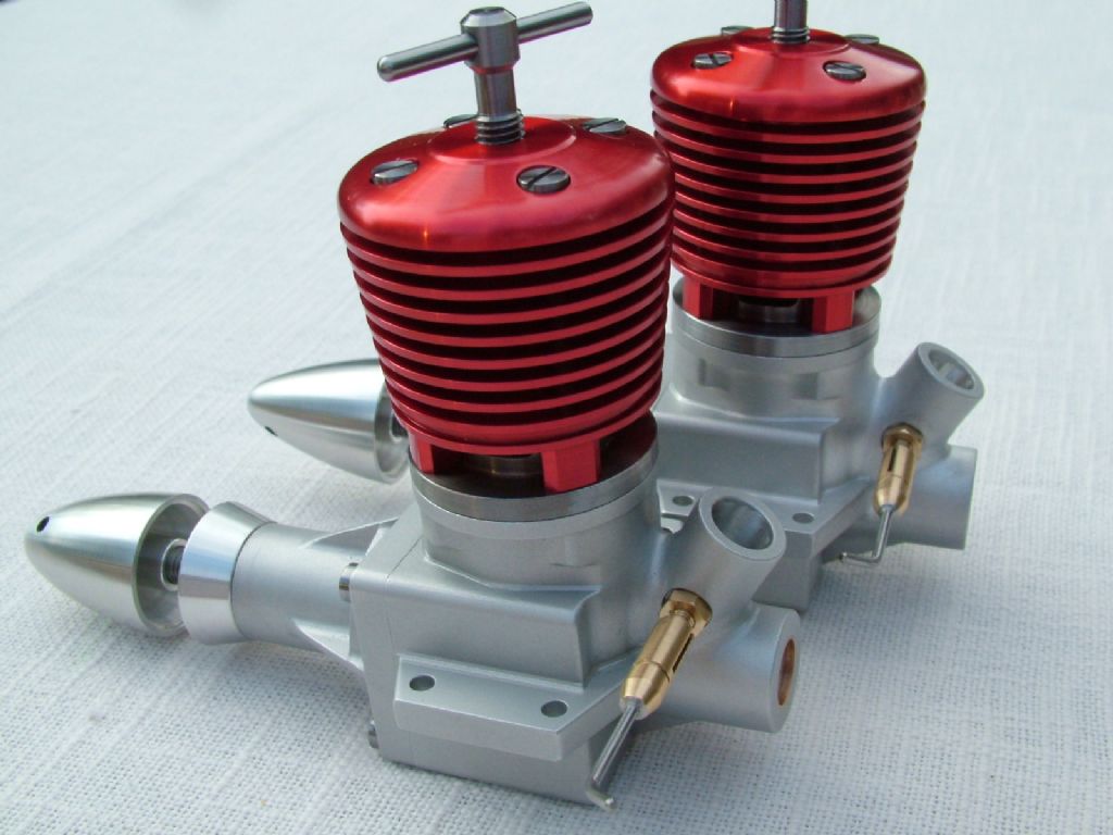

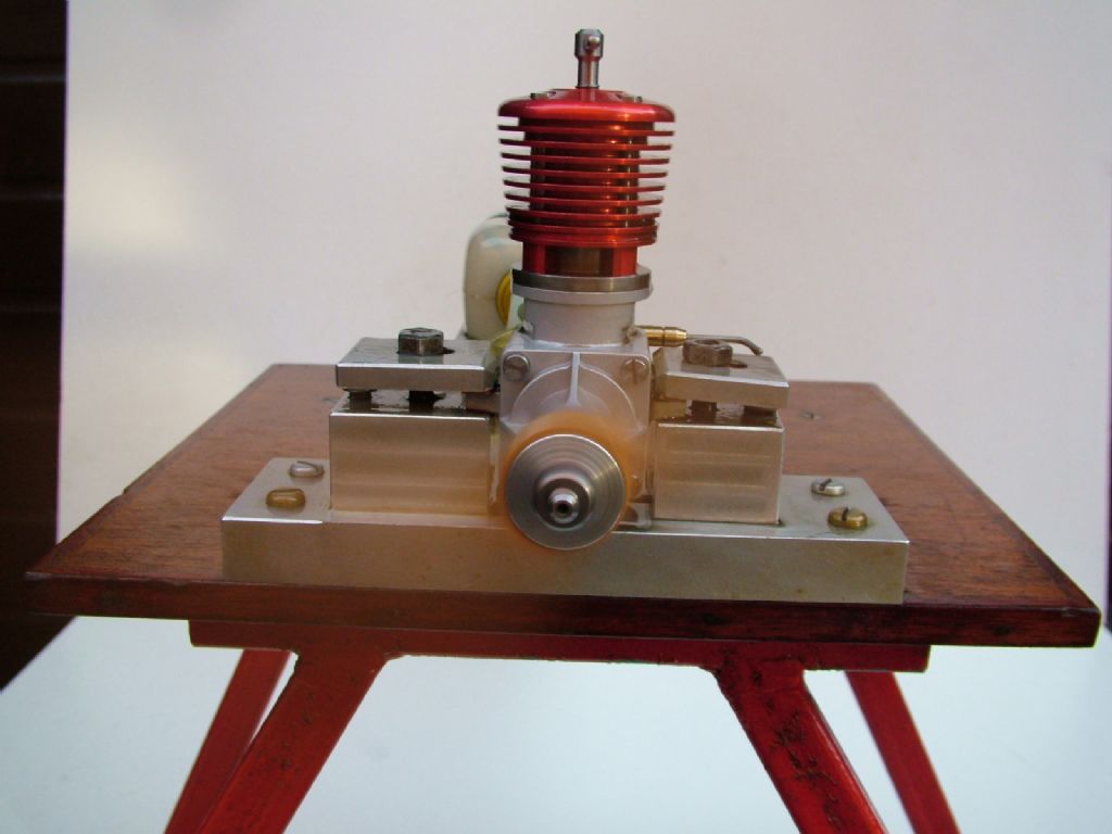

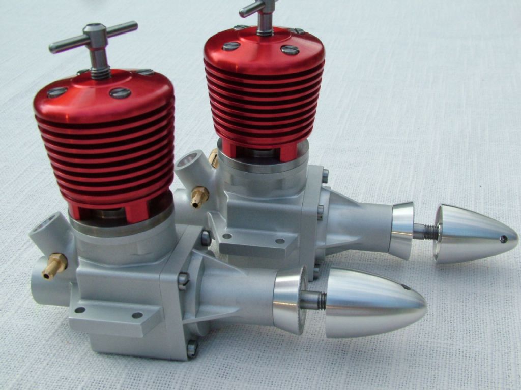

      Hi Guys, Given the interest in Jason's Firefly build and the engine in general thought you might like to see a couple of pics of the latest diesel engine project.
      I haven't posted about them on here before having previously done so for the Nova, Racers and Etas – over kill in mind.
      However if it's of interest there's a full build thread over on HMEM here –
      **LINK**
      As previously the cases have been machined from solid and bead blasted. The whole project took just over 8 weeks – as I think I mentioned before the nice thing about this type of project is the low part count and the quick return wink 2.dscf0900.jpg
      Good luck to whoever tackles one of these types of little engine – when it first fires you will certainly be rewarded
      Regards – Ramon

        #93805
        David Clark 13
          @davidclark13
          Hi Ramon
          What about some articles for Model Engineer?
          regards David
          #93814
            I would strongly reccomend anyone thinking of building the Firefly or any other aero engine for that matter to read Ramons build over on HMEM, to see those crankcases being sculpted from solid is a joy to behold. Tells you just about all you need to know about making this type of engine..
            Well except the annodising which you should have an article for David?
            J
            #93828
            Ramon Wilson
              @ramonwilson3
              Hi David, Thanks for the invitation however at this precise moment I need to take a short break though intend to begin something new I/C in the Autumn. Perhaps then? I will PM you on the details later
              Jason's comment re anodising comes after being asked to cover it on the HMEM thread – which was declined saying that an article is in the offing – always assuming that's still the case?smile
              Regards – Ramon

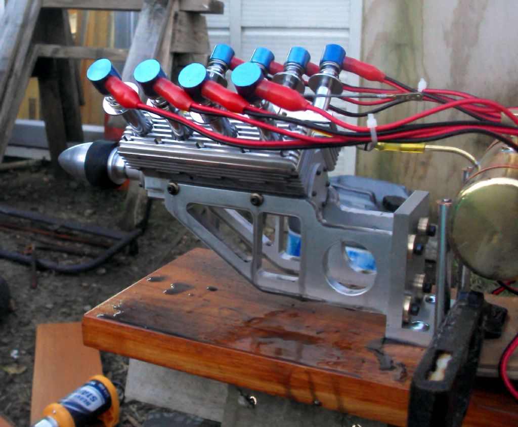

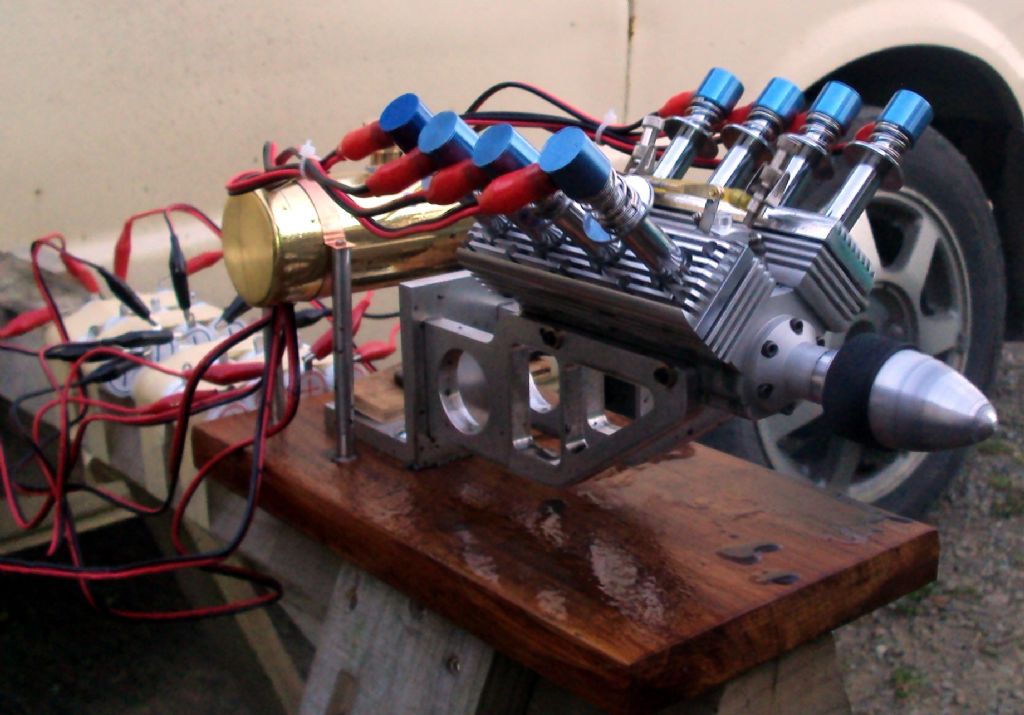

                              hi again all, just wondering if anyone out there knows how i can fire up 8 glo plugs at once, any help with this puzzle would be greatly appreciated. i need a system that will glo all plugs well and simultainously.
                              thanks
                              dean
                              p.s. i will post some photos of my engines when i work out how and have taken some photos to upload.

                                    Without knowing exactly which glow plugs you are using and their characteristics it is difficult to give a definitive answer. However if they will work at about 2 volts then connect them in parallel and feed from a nominal 2 volt lead acid battery via a fairly heavy duty switch. Something like a 4 to 8 AH battery should be OK.
                                    Cheers

                                      I would wire in all the glow plugs rather than trying to fit eight removable clips.
                                      From a common "Distributor" take a live feed to the pin on each glow plug,( you can buy what look like spark plug caps to do this) and take one common neutral back from the engine. You will need a decent ampage to drive all the plugs, maybe a glow panel that gives 1.2V from a large 12V battery would be best.
                                      Have a look at these bits from Just Engines, they do the plug caps

                                        The 'Glow Panels' are, I think, designed to feed just one glow plug. As Dean needs to run 8 simultaneously he will need something much more beefy. I have dug out some old glow plugs I had, from heli flying days, and their cold resistance looks to be about 0.2 ohms. This gives a cold current of about 10 amps per unit with the hot current being lower.
                                        8 plugs running at 2v would require a whopping start/cold current of somewhere in the region of 80 amps which would fall back as they reach temperature. It might be better to break them down into separate smaller groups which while it does nothing for the total power requirement would would lower the current for each branch and make switching easier.
                                        A quick test has given a current of 3 amps at 1.2 volts, nice orange glow, which would equate roughly to about 5 amps at 2 volts or 40 amps for 8 plugs in parallel for the plugs I have got.
                                        If run from a 12v source, i.e. car battery, then the most efficient method would to use some form of switched mode supply or pulse width control system to regulate the feed to the plugs. A simple but crude solution would be to use a beefy hex-fet on a heat sync fed from a variable mark space oscillator and tune for optimum current. I would suggest something like a 555 Timer IC but Andrew would not approve wink 2 as its very old hatno.

                                          Here is another solution though it would be better kept under the engine display stand, just one rechargable per plug.
                                          **LINK**

                                            hi all thanks for the info, i have 12 glo leads coming and 24x 6000mAh batteries, anyone got any idea as to how i go about charging all these batts?
                                            going to make 4 banks of 6 batteries to cope with a couple of other projects underway as well as the v8 beast
                                            thanks
                                            dean
                                            p.s. taking photos of engines at the mo will upload as soon as i can

                                                  many thanks to all of you guys for the ignition ideas. i am still working out how to get a single setup for each bank of cylinders rather than 8 individual batteries.
                                                  thanks
                                                  dean

                                                    That was an expensive way of doing it, rather than the removable glow clips I would have used the ones that stay wired in with just a small plug cap which I linked to earlier. That way if you just get the engine running and pull all the clips off and it dies you don't have to put all the clips back on.
                                                    It can also be wired with one positive wire to each plug and a common negative to the engine and the battery holder. You could wire a neat loom with just 4 wires and small plug caps or make glow plugs like old screwtop spark plugs as these ones on this Whittle have been.
                                                    Edited By JasonB on 01/11/2012 07:14:46

                                                      actually it wasn't that dear, but i hear what your saying. i have in fact got the leads you suggested already but am struggling to come up with a battery combo that will glo them all hot enough. thats why i went to individuall glo sets, having said that, i am now wiring the 2 sets of 12 nimh's into pairs in series and then into sets of 12 in parallel to get a better duration of glo time. you can see the engines first run on you tube if you search "777engman v8". thanks again for the help
                                                      dean
