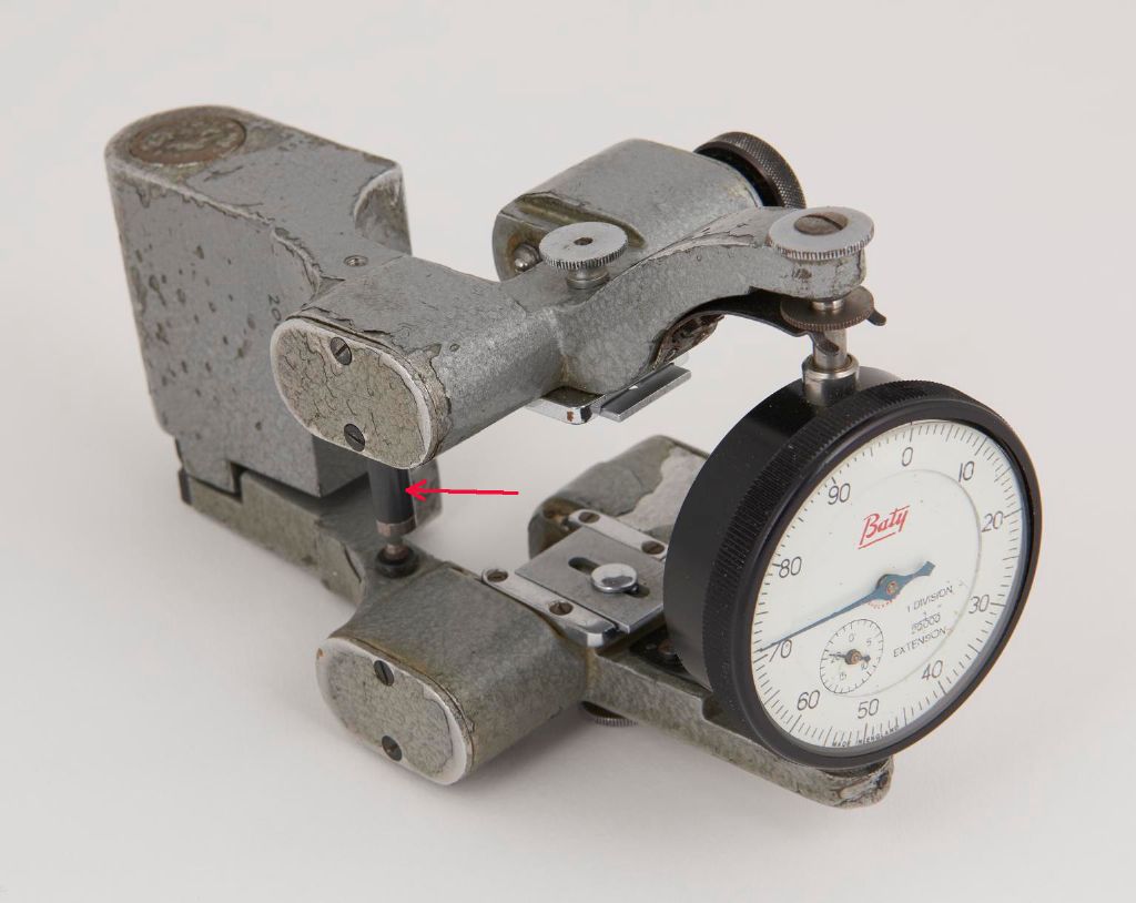

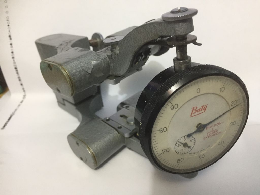

                After starting this thread I remembered that I had splashed out a fiver or so on something called a Lindley extensometer at a junk shop some years ago. It looked interesting, but has since been gathering dust:
                I think that this is functionally equivalent to the device in Gary's article, so I should be able to make measurements myself. However, having a look around I see that the Science Museum has something similar but with an extra part:
                Can anyone suggest what that part does? There is no indication of anything missing (eg redundant threaded hole in the casting) in my example.
                Robin
                PS the second image was downloaded from the Science Museum and has been altered to the extent of adding a red arrow to indicate a particular part.
                R.

                  Ah, cripes, I've just noticed that my one has a part that the Science Museum one doesn't – a sort of a cone on a spring which when pressed in 'zero's' the gauge. So maybe that's what the indicated part on the Science Museum one does, but I'd be interested to know which was the earlier development.
                  Robin.

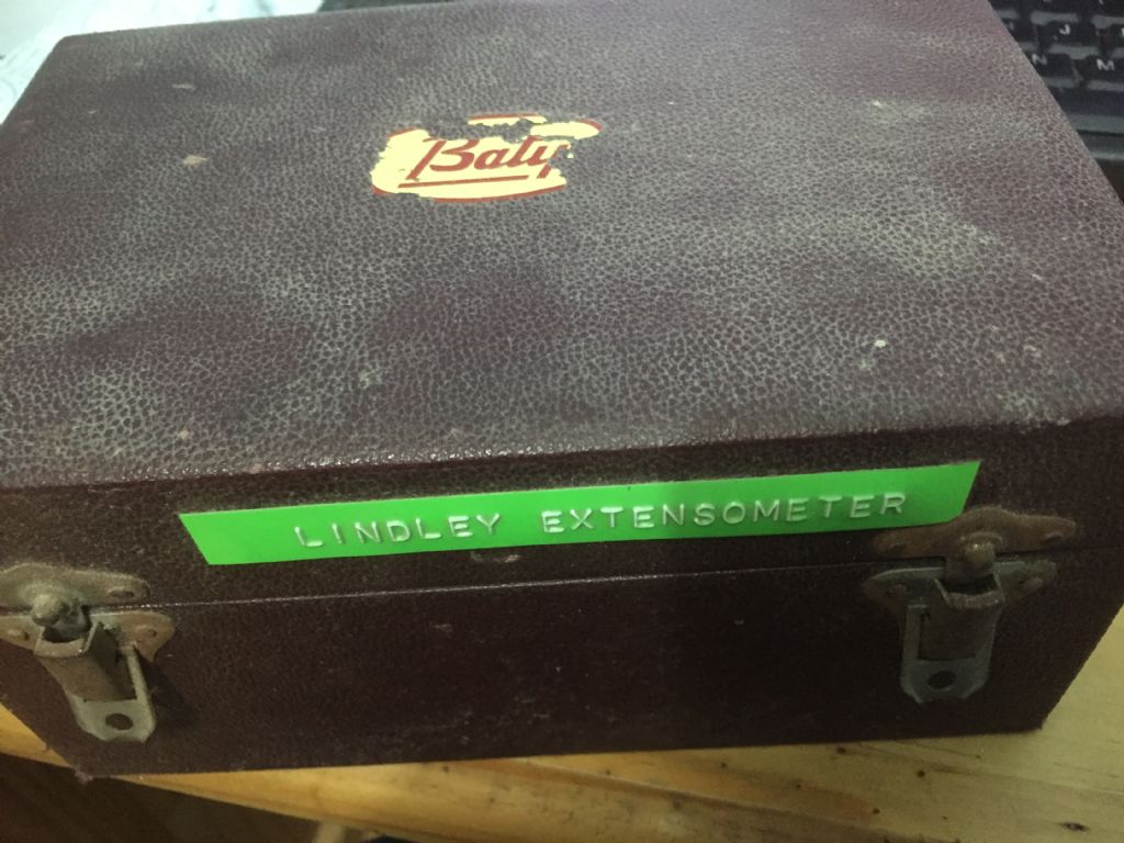

                          My own example is Baty for sure:
                          My guess, based on the faux leather and the Dymo label is that it is 1960's -70's.
