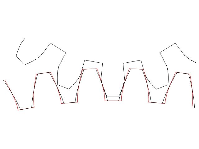

            If it helps to visualise what Jason has proposed, I attach a portion of a drawing showing a 70 tooth 20° PA 10 DP gear ( the lower gear portion in black ) with a gear portion of the same specification, but 14.5° PA ( in red ) superimposed, meshing with a portion of a 17 tooth 14.5° PA 10 DP gear ( above ).
            20? v 14.5? gears meshing
            It was generated using GearDXF program and manipulated in QCAD Professional.

              The 20 degree PA teeth are more "triangular" (less parallel) than the 14.5 and one result is a larger radial force pushing the gears apart when a given torque is applied. The teeth are also slightly more robust.

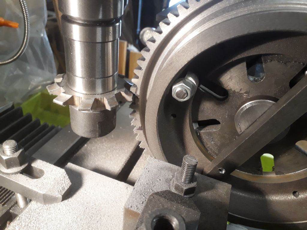

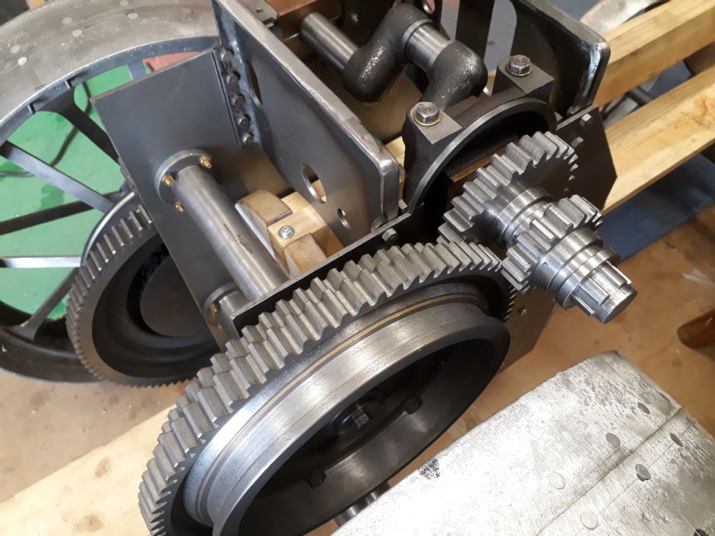

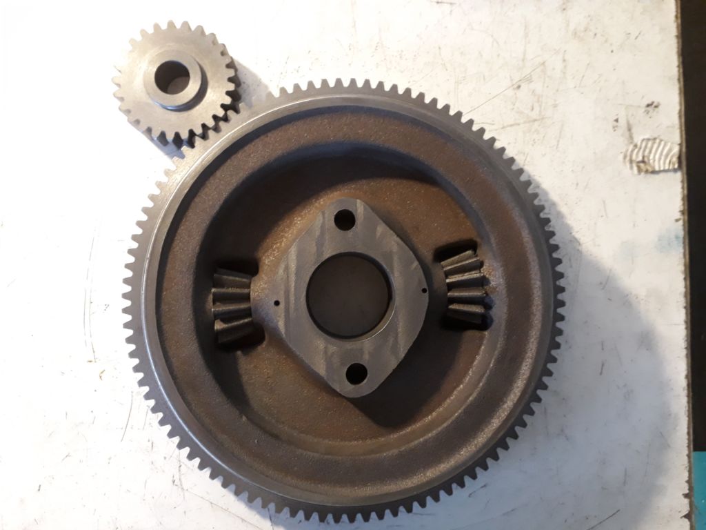

                                      Hi Stephen, I went for the specified 20 deg PA in the end. Steve Holder at [email protected] was able to supply the cutters I needed second hand at a reasonable price.
                                      Here are some of the resulting gears:20190521_101833.jpg
                                      2019-09-02 10.56.07.jpgHi Stephen, I went for the specified 20 deg PA in the end. Steve Holder at [email protected] was able to supply the cutters I needed second hand at a reasonable price. Here are some of the resulting gears:2019-07-14 19.31.31.jpg20190521_101833.jpg
