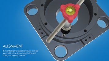

              This is a handy gadget from edge technology it is a bubble level
              that fits on top of the tap wrench.
              Best Wishes Martin

                  One thing about the bubble level Martin – It assumes the work is being held on a surface that is level so worth checking that.

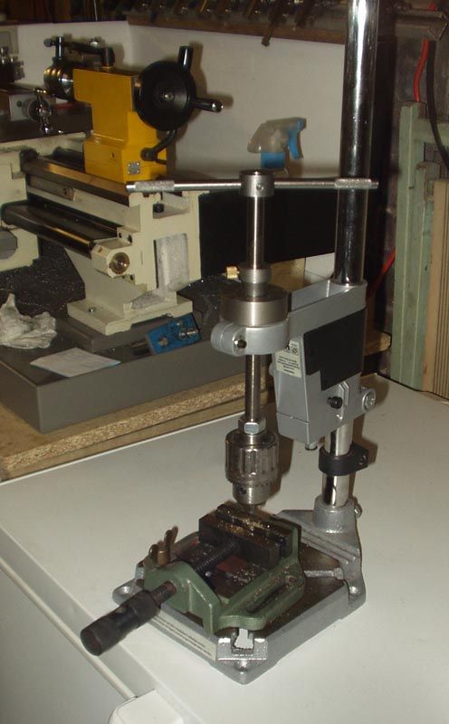

                            I have this one, made from stuff from the "cuminandy" box. Actually used it today to tap 18 M3 holes.
                            Tapping fixture
                            Base is from an old Wolfcraft mini-drill stand, twin arm is an old countershaft bracket, column is 1" ground steel.
                            But don't buy one ready made, save the cash for something more useful.
