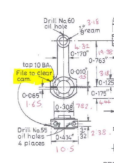

      Hi Guys,
      While sorting out my lathe I decided to draft the engine up in cad. I have assembled everything and turned it over, only to notice the conrod collides with the lobe on the camshaft.
      I make the distance between crank and camshaft 0.5625in, which as far as I can tell is correct, so I am calling on anyone else who has made this engine to tell me where I have screwed up?!
      Cheers,,
      Pete

        #373421
          He gives 0.5625" in the ME article and that also agrees with the gear PCDs
          Just a thought but do you have the camshaft rotating when you turn the engine over in CAD as it may be they don't clash when timed correctly

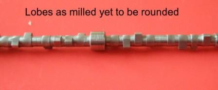

            Hi Pete
            I am in the process of building the same engine, work to date includes all ally bits and the camshaft,
            now on the 4th attempt at the crankshaft !!!!
            Are you certain the camshaft is built to the drawings, that is are all cams aligned as per drawing and timed for correct opening periods. ?
            Emgee

            Emgee
              @emgee
              Posted by Emgee on 26/09/2018 20:58:57:
              Hi Pete
              Emgee

                    #373453
                      CAD is only as good as the info you put in, have another look at the original drawings.
                      Edited By JasonB on 27/09/2018 07:03:51
                      #373465
                      Pete Savage
                        @petesavage40461
                        That’s the ticket! Didn’t notice that, I must have seen it at some point, but I go off and come back to this project quite a lot. Thanks for the help!

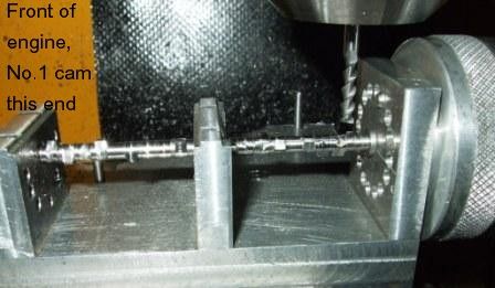

                          Emgee, When you were machining your cam shaft, did you assume the radial pin point order was towards the outside of the jig or the inside? As I understand it at the moment, the end of the shaft with the 2 different diameter bits on the end is the rear/cyl 7&8 end, which goes through the clock dial and into the 245 slotted wheel.
                          I aligned the centre of the lobe to the opposite of this point for the corresponding cam position, assuming the points were on the outside, however the shaft appears to now be a mirror image of what it should be.
                          On an unrelated note, the purpose of the arbitrary "Index pin hole" seems like an added complexity, those holes could just be numbered with what cam number it was!
                          #373518
                          Emgee
                            @emgee
                            Hi Pete
                            My setup for milling the cams, see note on picture ref ends.

                              Pete
                              Is it possible to modify the rod drawing to allow for the clearance to the camshaft when modelled ? so providing dimensions of material removed for clearance.
                              Is fouling at the same part of the rod for all cylinders or is it variable ?
                              Huge benefit to those still to make those parts, save dismantling to file rods and assemble again.
                              Emgee
                              #373677
                              Pete Savage
                                @petesavage40461
                                I think a chamfer of 1.5-2mm on this edge is enough for clearance.
                                EDIT: It is on the opposite side to in the photo
                                Edited By Pete Savage on 28/09/2018 15:31:44

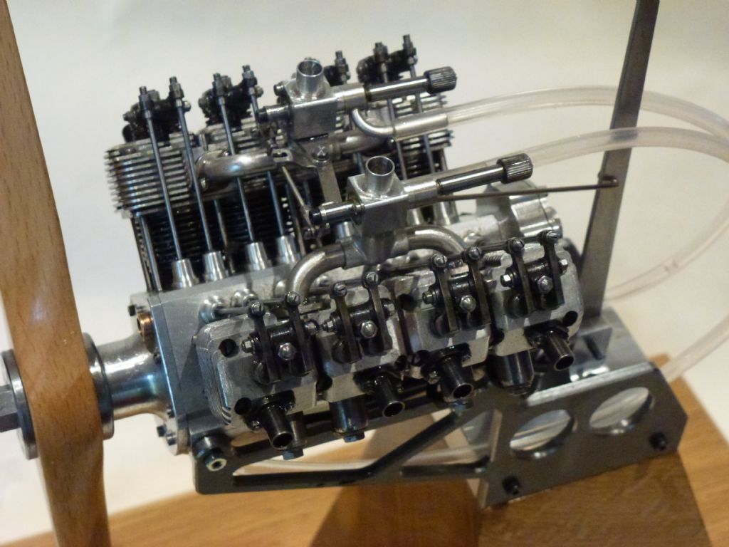

                                  John Roberts 10
                                    @johnroberts10
                                    Yes I can clarify that relief on one side if the con rods is necessary. I attach photo of the finished engine. For me the biggest challenge is getting the engine to run. I have now a power supply which gives correct power to glow plugs and tried a high nitro fuel, but there is air leakage though the valves despite grinding/lapping valves in. The next option is to try more powerful springs and possibly remaking pistons which are taller. The hope of raising compression. I am confident that I have timed correctly. Any one in the process of making this engine take an extra effort to prevent air escaping other wise you will be in the same boat as me.
                                    My attention has now moved on to making the Blackmore Bentley BR2 Rotary engine. I would be very interested in contacting anyone that has made one as I have some questions!!
