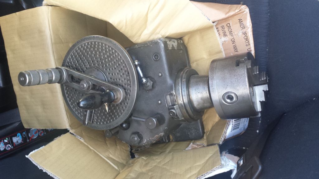

      Hi guys.
      I was looking at trying my hand at making some gears for my lathe and knew that one thing i would need is an indexing dial.
      I saw this lump today and got it right cheap but I think I may have way overspeced…
      Does anyone have any info on this piece of gear and or if have got something I will probably never use…..
      Regards
      Mat
          Just pm me your address and I will send you a jiffy bag for it.
          Now upset us all by telling what you paid for it.

            Nice, nothing wrong with that. Did you get any more index plates with it and will it fit onto the table of your Mill?

              Spend an hour on GOOGLE looking up manufacturers name / part number or any thing relevant that the part is marked with.
              Include all the relevant information in an ebay listing.
              After your successful sale use the loot to buy the gears for your lathe.

                I also tried Google images, No luck But here is the link…. It is amazing how may different dividing head images are out there in the aether.

                    To be honest, it looks simple enough to use, all you need to do is work out the gear ratio for the worm wheel.
                    Only two issues – one you will struggle to use it in horizontal mode and two, it will obviously use up a lot of room.

                      Tracked it down to being a Walter SVT100.
                      The plate on top is split into 9 with 60 marks in-between each 1-9
                      each number turns the chuck by 1 degree so 9 degrees a turn makes 40 turns for on revolution of the chuck.
                      Not sure if this is normal as i have never owned or used an indexing dial before. all seems fairly straight forward, now just need something to mount it on……….

                        40 is one of the commoner ratios, along with 60.
                        Using teh dial you can get 1-minute accuracy (1/60 0f a degree) which is good enough for many purposes without resorting to teh division plate. The division plate will make it harder to make errors…

                          I rather like your find, the centre height appears to be fairly low, that might help if you end up with a smaller size mill. Having the index plate on top is handy too. it keeps it out of the way of the hand wheels. Made in Germany….. If you open it up you will almost certainly find a nice precision ground and lapped worm and wheel that can be adjusted to zero backlash together with precision bearings that are also adjustable.
                          I found some more images on the net **LINK** it appears you can rotate it on its base.
                          If the bolt slots in the base do not line up with a particular mill you can always make up an adaptor plate.
                          I can not see a tailstock in the picture, it would not be that hard to fabricate one a few ideas here:

                              I have a complete manual for the use of a dividing head,including information about change gears(for really abstract divisions),plus info on set ups for helical milling. If there is any interest, I will try and copy it to share.

                                The low centre height possibly indicates it was intended for the German/swiss type precision toolmaking mills,used for making punches,milling cutters etc and could be mounted on the table or the front face of the machine,with swivel table removed,google LATHES UK and then go to THIEL under the list of milling machines which shows an example of this type of dividing head with index plate on top. bit of very expensive kit in its day.

                                  Looks like a nice bit of kit, once you're familiar with it you'll wonder how you ever did without it!
                                  If you can't achieve the number of divisions using the index plate that's shown, have a look on the other side of it, there may well be another selection of blind holes.

                                    Oooh differential indexing, those were the days. Both on div heads and rotary tables.
