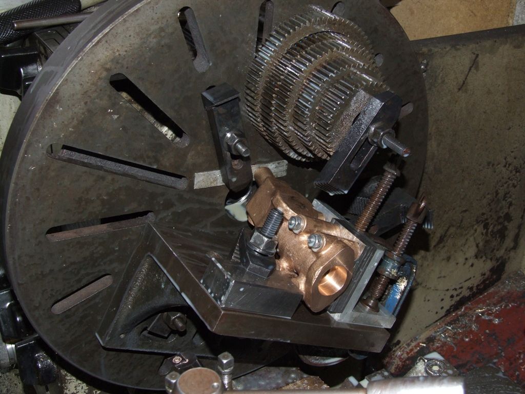

                        I am building a traction engine, so the gap bed does come in useful:
                        But it also comes in handy for smaller parts that need involved setups, meaning that the diddy faceplate cannot be used:
