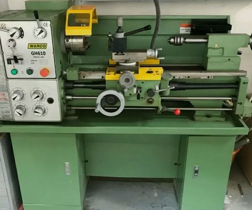

      Hi all
      I have just been offered a used Walco GH610 lathe including extras, QCTP, 4 jaw chuck, face plate, steadies, drill chuck and some tools, all in good condition for £1250.
      Just wondered what your general thoughts were? Does that seem a reasonable price?
      I have only just bought a used Clarke CL500M which I am very happy with, but I am considering spending £300 on a Variable speed motor package upgrade. So thinking before I do this should I consider buying the Walco instead and selling on the Clarke.
      Thanks Stuart

            Looks a good deal but just be careful, that lathe has ‘sold’ twice on eBay in the last couple of months. Photo has been cropped but definitely the same photo, bisley drawers alongside and metal strip on floor.

              Yes, I would say it is worth £1250. From what can be seen in the photo it looks quite good, so if with a closer look it has no signs of wear, damage or abuse and doesn't make any nasty noises and everything is working correctly then it is certainly worth it.
              Warco have been selling that design of Chinese lathe for donkeys years, I remember when they called it the Warco 1224 and originally cost £2000 new many years ago. Their current version is the GH1230 at around £4000 with a DRO and coolant pump I think.
              Although the centre height is the same as your Clarke lathe at 6 inches, the GH610 is in a different league with properly proportioned castings to suit its capacity, full screwcutting gearbox, power feeds and a geared headstock with a camlock spindle fitting.
              With a lathe like the GH610 for home use you may never feel the need to upgrade again.

                      In my view, the GH610 is a far better machine than the CL500M.
                      This example looks to be in good condition, and possibly has not done a lot of work.
                      It has hardened bedways, provides power feed for both sliding and surfacing, with a separate, protected Leadscrew, and probably more options of feed rates and pitches (15 plus the same again using back gear and changewheels? ) than the old CL500M. It will probably weigh more, so be a more rigid machine.
                      You are being offered it at little more than half the price of a new GH600, which does not have the QCTP.
                      Warco have sold the GH600 from their USED lists, so we have no idea of what the price was.
                      (You may well need to purchase additional tool holders, so need to know the details of the particular QCTP on the machine )
                      In the same circumstances, I would probably got for it. But it is your money!

                              Being over cautious, I would not cut threads at 200 rpm, with Taps, Dies or single point tools. Too little time to react!
                              Less than a third of a second per revolution of the chuck, sounds like a recipe for running the tool into the shoulder, unless it is through hole.
                              This is a manual lathe, not a cam controlled Cridan E!
                              With a VFD giving 90 rpm, i use the "jog" function, sometimes in Back Gear, or a Mandrel Handle, so that I have greater control of speed and distance.
                              If the Warco GH 610 is good, it will be more useful machine than the CL500M, although it lacks the ability to mill. Although may still be better with a sturdy Vertical Slide added (Have only flycut or co ordinate drilled with one on my belt driven fore runner. of the GH610 )

                                There was a previous post from someone having suspicions about a seller on eBay. I can’t find it now , but since then I have noticed a few lathes (Harrison M250 or 300 for instance) for sale with the same details and photos, showing sold then for sale again a few days later by a different seller in a different part of the uk . Mostly northern Scotland but also other parts of UK. It seems dodgy to me but I can’t see what the scam could be. This Warco lathe matches that pattern.

                                  Mmm….that's interesting! So the Warco lathe mentioned is being offered to me on a second chance offer via eBay. I put a half hearted bid in not expecting to win and got out bid as expected. Then 2 days later I got the second chance offer. The seller hasn't called me as arranged to discuss, so I'm going to give it a miss, there is definitely something not right about it all!!

                                        If the seller is genuine, they should not object to you visiting to examine the machine, (as long as it is within a sensible distance of you ) Talk of cash in hand, and collect may be a persuasive suggestion.
                                        Or would they let someone knowledgeable of your choosing go and examine?
                                        If not, could they provide a video of the machine in use, preferably performing tasks that you specify, to reduce the risk of it being a scam )?
                                        If the answers are "No", "Don't know how to use it" or "Covid" then be suspicious and prepared to walk away.

                                              I've only just noticed this thread but I had seen the lathe on ebay together with the other items that the seller (maredw-784) had for sale. When checking 'sold items' to compare the price, the same ad but with a different seller in a different location came up.
                                              If this wasn't enough to convince anyone that the seller was a sammer, all the other facts need to be taken into account.
                                              1. The ebay account is a new one, only opened in November
                                              2. His feedback is all as a buyer, all from bulk sellers so presumably low value items.
                                              3. He was selling several high value yet unrelated items, most of which had descriptions and photos directly lifted from other 'sold item' listing from other, presumably genuine, sellers.
                                              4. He is alledgedly based way up north, making collection for most potential buyers, inconvenient.
                                              5 He doesn't accept paypal, but does accept bank transfer.
                                              6. His auctions are all short duration.
                                              7. His 'sold items' showed the same items he was still selling, sometimes two or three times in the previous few days.
                                              Number 3 should be a massive red flag to a potential buyer. Any of the others should be something of a warning, all of them taken together means this seller is a scammer.
                                              I reported him to ebay twice over Christmas. In the past when I have done this, ebay took the auctiions down straight away. It didn't happen this time and I can only guess that covid and Christmas combined to slow things down.
                                              Ebay can't and won't protect you from all scammers, particularly when paying using BACS. Using BACS is fine face to face, I've both bought and sold reletively high value items this way using on line banking. It's better than cash, but BACS at a distance to someone you can't authenticate is a big no no.
