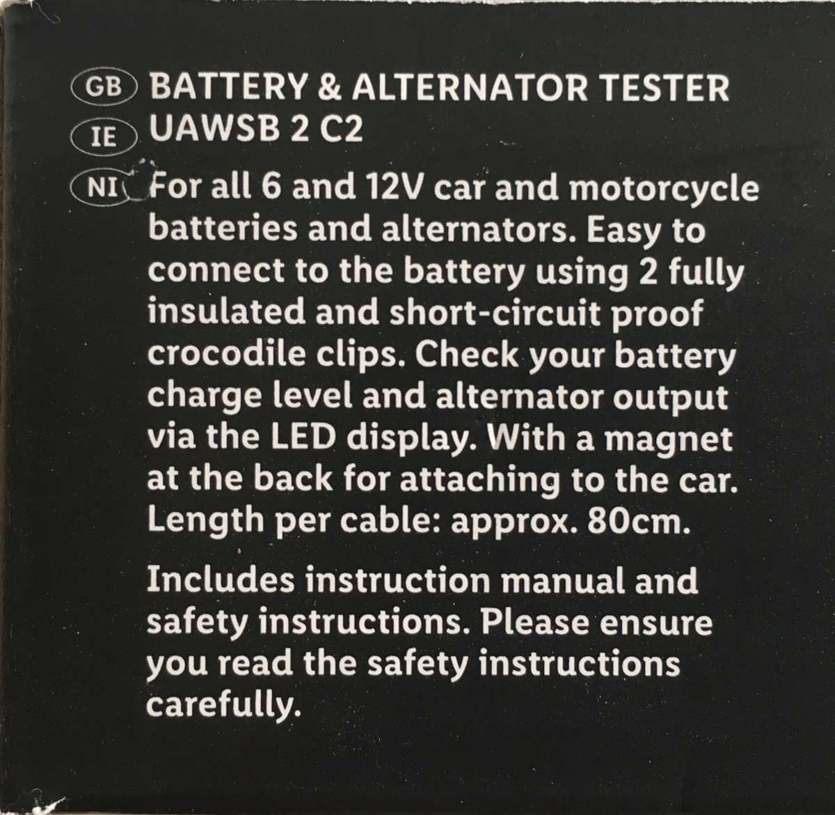

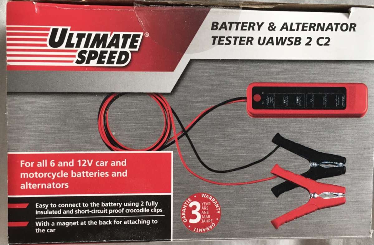

                                  These, which occasionally appear in Lidl “silly-cheap” don’t do anything very clever … but they do it quite well:
                                  IMG_0888
                                  IMG_0889
                                  #807253

                                    Surely all it can do is measure voltage?
                                        Yes, Duncan …. it just lights-up the appropriate LEDs
                                        It’s simply a convenient indicator of battery condition … reasonably robust, and trivially priced.
                                        I thought it might be useful
                                        … never mind.
