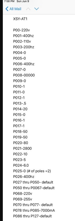

                          #458508
                          Joseph Noci 1
                            @josephnoci1
                            John, maybe this may help – I believe it is a setup for your VFD.
                            Parameter P78 thru P85 seem to be current settings ( in mA). This example is set for 7amps (7000mA)
                            Voltage settings, max and min frequencies, etc, to be set as you need, not necessarily as per this example!
                            Joe
                            Edited By Joseph Noci 1 on 21/03/2020 06:55:03

                              #458546

                                sit down, RTM and think logically….It is pretty simple, If you cant understand it seek help here. See one of my previous posts on a search for AT1 thread.
                                you should have a parameter P78 main current overload
                                set that at the calculated normal load current for your motor + 20% or what you feel comfortable with (it is expressed in mA so 6A would be entered as 6000)  (the default by the way is 3000 which is why you may be experiencing trouble)
                                set parameter P24 to 2 seconds
                                make sure you have set P0 through 10 correctly (not what is the table above which is for high speed spindles)
                                Have regard to P12 for you application
                                Review the ramp times P26 P34 P42 (and others if you are using them) I have come across some units Hz/s has been a multiple of 10.
                                Avoid using the factory reset unless you have been through all of the parameters and written them down – sometimes the defaults are not as stated on the printed sheet and I also suspect there may be some hidden non accessible ones.
                                Contrary to the received blather on the net, these are excellent high quality units, let down by poor end user manuals, the connections are no more exposed than in the majority of older industrial inverters. The boxes are intended for industrial panel mounted use, but sold onto the hobby market hence the howls of outrage. The Chinese assume that the people purchasing this class of device will be smart enough to enclose the devices or carry out some other form of risk mitigation.

                                        joseph noci 1, my instructions do not have a setting for P25 which according to the set up you posted is for number of poles. The VFD does have P25 so I will try that. I have P21 set to 1420 which I thought was for the rated speed of the motor. The VFD trips out at 1420 so I will increase that and see what happens. Thanks for your help.
                                            P21 correct – enter plate speed which if you motor is 4 pole will 1400 or so There isn't usually a P25, as setting the motor speed performs same function (more or less). If you set a higher plate speed, only the display RPM will be affected.

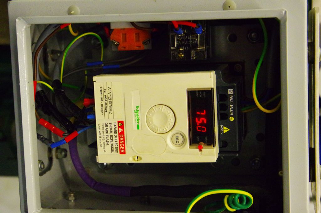

                                                      imgp0944.jpgI agree with making sure the VFD is kept in a secure environment with ventilation designed to keep swarf at bay. This metal box is fully earthed as well.
