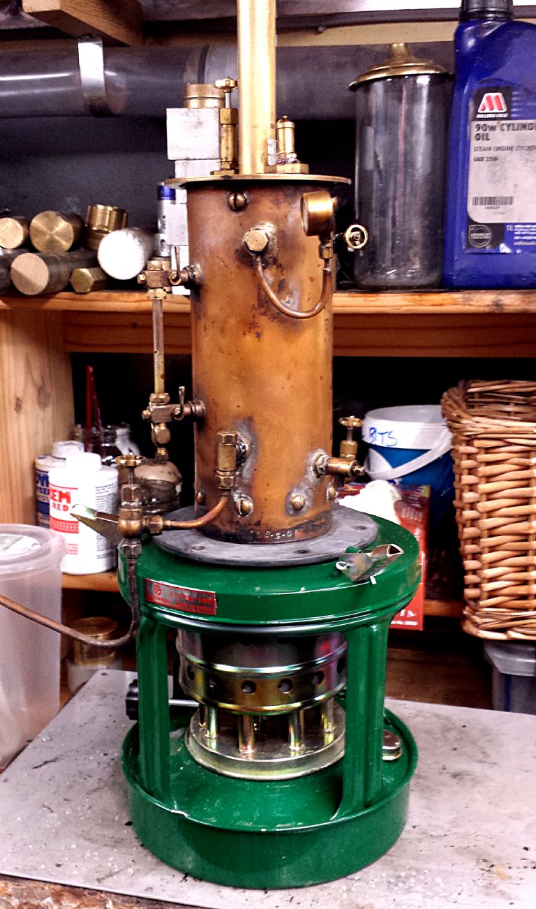

                      This evening I tested the Trangia inside the cast iron housing which features a few posts above. It was tested under very similar conditions to the open structure I tried last night, i.e. indoors, same burner height, similar amount of water in boiler. Last night with the open structure it took 50 minutes from cold before the safety valve blew off. This evening with the cast iron housing an hour and a quarter in and still nowhere near. There was also an acrid smell – not overpowering but unpleasant. I'm not sure if this came from poorly combusted alcohol or from the plasticky paint inside the housing, but I gave up the ghost and turned off the heat. So, even though I thought that the housing was plenty open enough, clearly it wasn't, so I'll use the open structure if and when I fire the boiler with the Trangia in the future. I guess this could be an option for indoor use.

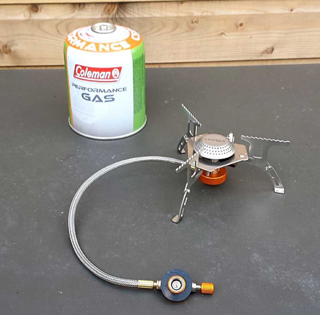

                      #390948
                      gary arthur
                        @garyarthur48070

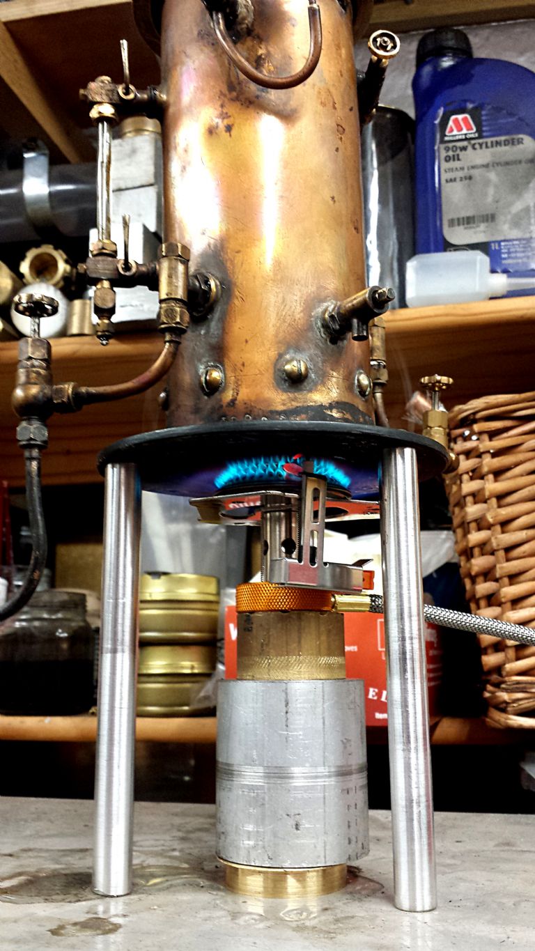

                        I tried the boiler on my gas burner for the first time. I removed the pot stand from the stove burner and set the latter up temporarily on some bits of round stock. Way more powerful than the meths was, as expected – it blew off the safety valve in 15 minutes and I'm pretty sure it would have been much quicker than that if I had turned the flame up higher. It maintained a steady jet of steam from the steam out valve, and I noticed that when I opened the steam blower just to try it, it pulled the flame up into the tubes quite dramatically. However, I think I gave it too much blower as the whole thing went a bit out of control and started to splutter water, at which point I turned off the gas and let it cool down. Overall, though, looking good, and the colour of those flames is to die for:

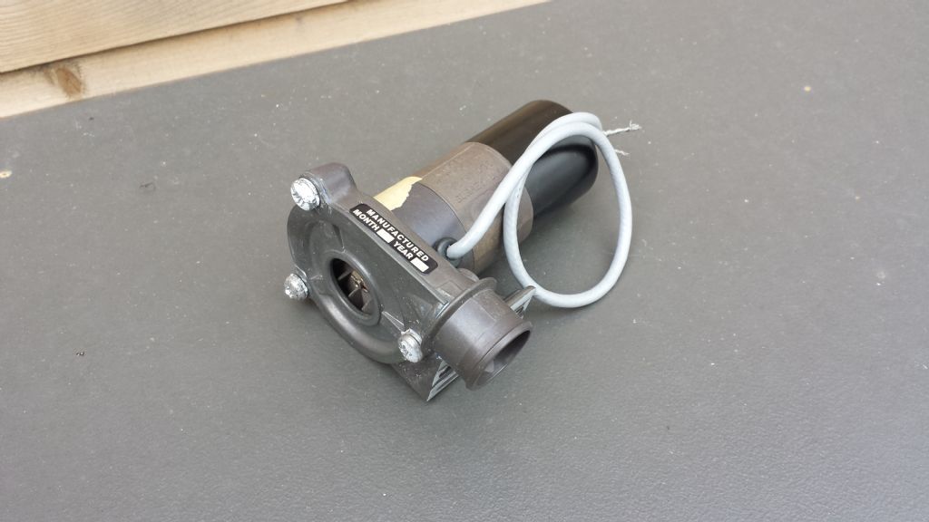

                        Meanwhile, in preparation for my next try with coal, I bought this after a fellow forum member kindly drew my attention to it:
                        It's a quality little piece of British engineering from the 1970's – a cooling fan for some piece of equipment on a plane, possibly military. It appears they are quite often used as blowers. It has the kind of motor which doesn't reverse direction when the polarity of the wires is changed round, so the suction tube has to cover the fan rather than connect to the nozzle. Fortunately I had a copper plumbing reducer which wedges pretty snugly between the three housing screws. Here it is jury-rigged; I think a bit of metallic tape and/or heatproof sealant will suffice to see it working:
                        Having been given feedback that my last firebox for coal was too wide and not sealed enough, I got started on making a leaner, tighter one:

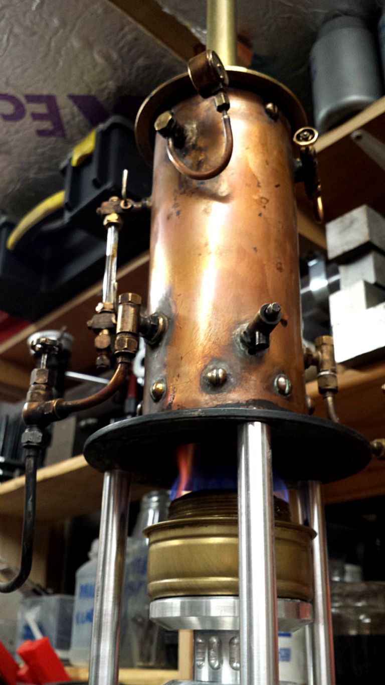

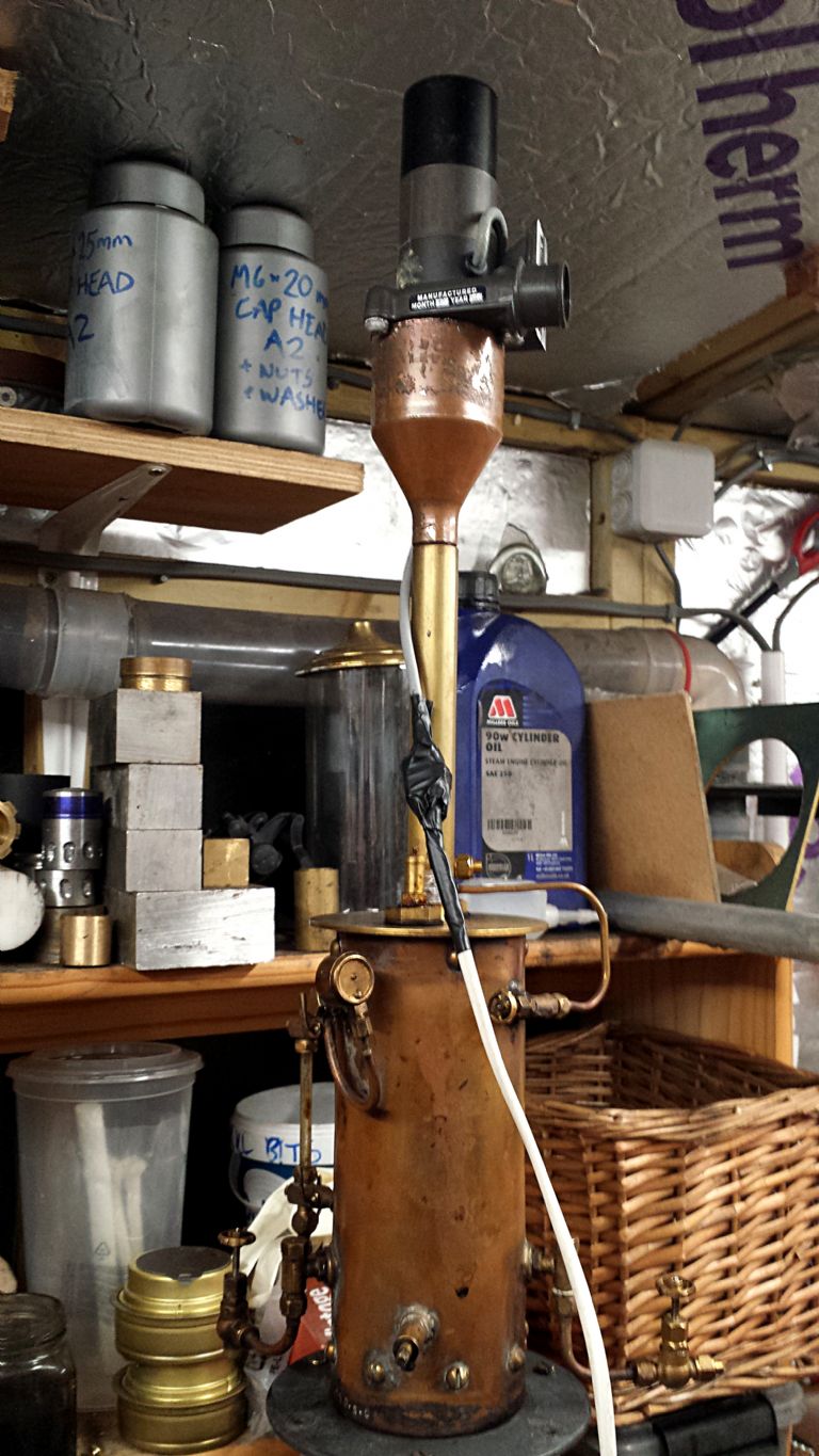

                                    This evening I decided to actually try running the boiler rather than just heat it up and gaze at it in stupified awe while it did its thing.
                                    Using the gas burner, I took it up to 50 psi on the gauge. I had the gas turned up a bit higher than last night and it took me 10 minutes to reach 50.
                                    I then opened the steam takeoff valve a bit, resulting in a steady jet of steam which made a narrow strip of paper which I held in front of it flap. The pressure stayed at 50 until I opened the takeoff a bit more, at which point it dropped a little, but it was easy to get it back up again just by restricting the steam out a bit and/or turning up the gas. I went on like this for 20 minutes, with the pressure between 40 and 50 most of the time. At one point it dropped to 30 psi, but that was mainly due to inattention on my part I think. I pumped in more cold water several times and the system recovered quite quickly from that.
                                    That said, the gas was turned up full for most of it, but this didn't seem to do any harm other than to use more gas…
                                    When I get to lagging the boiler it can only get better…
                                    After 20 minutes, I decided to have a fiddle with the steam blower. I was amazed at the dramatic effect it had even with the gas turned up full. The gauge went up fast, and looking up into the bottom of the boiler I could see the flame being sucked up the tubes. I think the blower on this boiler might be useful even with gas.
                                    I'm tempted to be pleased with this, but the one thing I do not yet know is whether or not that jet of steam will drive an engine.
                                    There's only one way to find out…

                                      If you run it with the burner flat out and the safety valve blowing merrily and measure how much water you have to pump in to keep the level constant for a time, you know how much steam it is making and so how big an engine it will run. Allow a big margin for losses!
                                      I would expect the twisted shim down the tubes t help, they are quite big for their length and so hot gas can get up the middle without ever touching the sides. Don't go mad, start with half a turn and it then try increasing the twist to see if it gets better.
                                      More blower means you can burn more gas, but eventually you can have too much and have excess air which cools it all down again. Another set of experiments, but when you have enough air to be able to have the gas full on seems like a good place to stop.

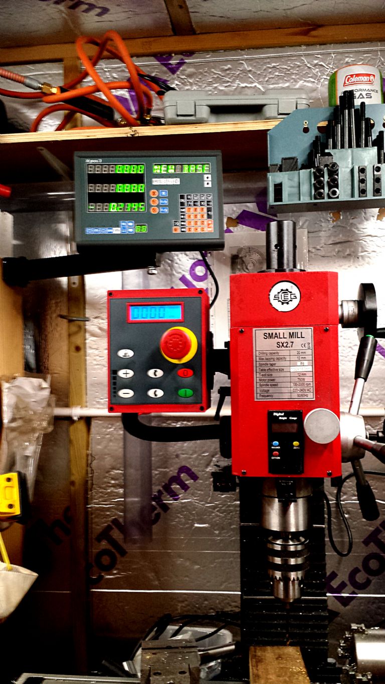

                                              While waiting for a couple of items to arrive, I made a start on installling the DRO on my mill in preparation for starting on my first engine (which day draws constantly closer). Fixing the display with its bracket to a convenient storage unit made me feel good, and it looks pretty:
                                              Unfortunately, though, it is attached to the mill's axes by nothing at all as yet and so remains decorative for the moment. That said, I did make a start on making the mounting brackets for the glass scales.

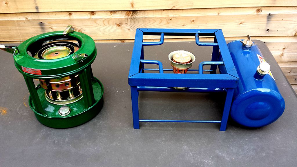

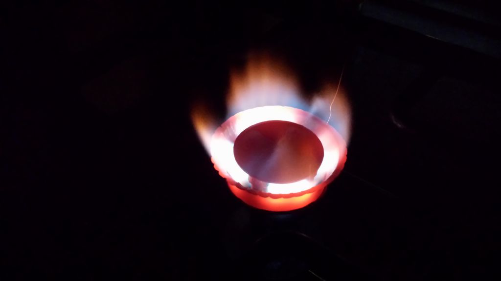

                                              Those of you who have been following this thread will know that the Lixada camping stove gas burner seemed to raise steam with the boiler quite effectively. While I will continue to use gas as an option, I am nevertheless in pursuit of a couple of funky alternatives. I received two contenders in the post today:

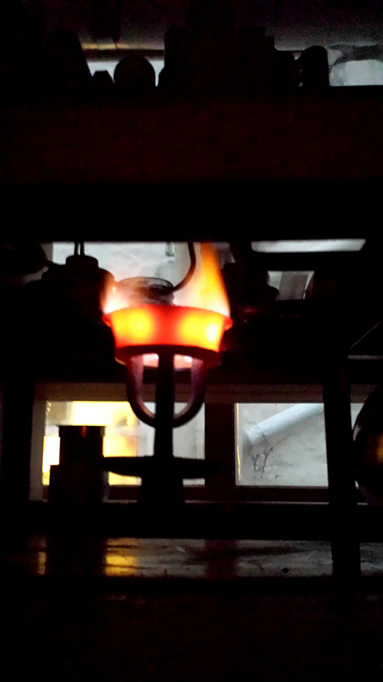

                                              In the green corner we have an eight-wick kerosene stove from China. It has a catalytic converter/secondary combustion chamber/whatever you want to call it. Although it is not a pressurised unit it vapourises the kerosene and generates a fiendish amount of heat. Unfortunately I took no photos. I did shoot some video but that comes later. It cost less than a tenner, including shipping.
                                              In the blue corner we have a pressurised kerosene stove all the way from India. £22.99 including P&P. It took me a couple of goes to get the hang of it. For those of you who are unfamiliar with these things, it's like an old-school Primus stove – the burner needs to be preheated. In this case I filed the'spirit trough' (hidden in photo by frame of stove) with methylated spirits and ignited it, thereby pre-heating the vapourising tubes and allowing the kerosene burner to kick in under pressure:
                                              This resulted in a seriously hot flame which rivals the gas burner and which I suspect will raise steam effectively:
                                              Assuming these two bad boys raise steam, they will be hacked and modified as final alternative heat sources for the boiler, which will be fun and allow for some creativity. However, I will wait until I try them on the boiler before chopping them up so that if they don't work they can always be used as stoves or repurposed for something else in the future. Either way, no great loss at the price.
                                              Trials with each of these under the boiler soon.

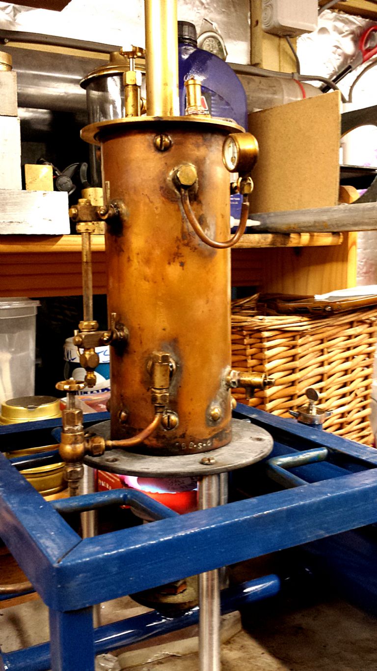

                                                So, this evening I tested the two kerosene stoves:
                                                First
                                                then
                                                The blue Indian pressurising stove emerged as the winner. It's fierce, and almost up there with gas I'd say. It had the gauge up to 50 psi in 12 minutes and the safety valve blowing off in 15. It might do better yet with a bit of burner/boiler distance adjustment. It's also great fun to use and looks fabulous
                                                In contrast, the green 8-wicker didn't even have the needle off the peg in 15 minutes. It's a nice stove of a kind I haven't seen before, and it burns with a very hot flame but a flame of the wrong size and shape. Some fiddling with heights would help, but not enough I reckon. The steam blower made a considerable difference, pulling that soft flame into a neat cone which pushed the pressure up fairly quickly, but this revealed another problem: when the safety valve blew off the flame went out. Not sure why, but it did. That's a problem with this stove because the burner assembly is such that either it or the boiler would have to be removed to relight it. The pressurising one is much easier to relight because the burner is accessible.
                                                It will be very pleasant to use the 8-wick stove to cook a pot of couscous on the patio in France in the Summertime as the barbecue sizzles.
                                                So… thus far the promising contenders are the gas burner and the blue kerosene stove. The square pot stand on the stove will be cut off. I intend to use these two heat sources interchangeably. The idea is to have them both set at the same height so that they can be set in position without doing anything to the boiler. I also aim to make a cool-looking boiler stand and burner supports. However, the proof of the pudding will be in testing the setup out on an engine, so I'd better get on and start building one.
                                                Whether or not the boiler will run on coal assisted by the electric blower remains to be seen, and I intend to have a second go at making a firebox for it. I may do this in parallel with building my first engine, which I shall start once I have the DRO fitted to the mill.
