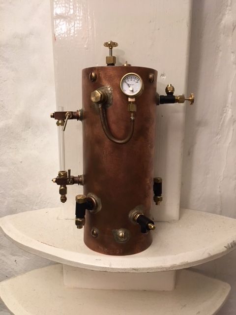

                              #357673
                              gary arthur
                                @garyarthur48070
                                Hi again.
                                Thought it was time to post an update. The picture below shows the boiler in its present state, fitted with the test pressure gauge, Schrader valve for initial air testing and lots of blanking plugs. Not the neatest construction or silver soldering job in the world, but it's my first effort. It's a 1.5 scale (3 inch) version of Stan Bray's five-tube 2 inch design. The first air test was last night, to 10 psi. I discovered one very small leak where one of the fire tubes joins the top end plate (marked in the photo with a blue marker pen which you may be able to see).
                                I wanted to avoid having to torch it again if possible, and certainly didn't want to add soft solder to the equation. To my relief I was able to mechanically close the leak by further flaring the end of the tube with my pipe expanding tool. This evening the boiler held 15 psi of air for an hour, submerged in water with no leaks apparent. Hope it stays that way…
                                Next up is a water test to 90 psi (twice working pressure). Wish me luck…

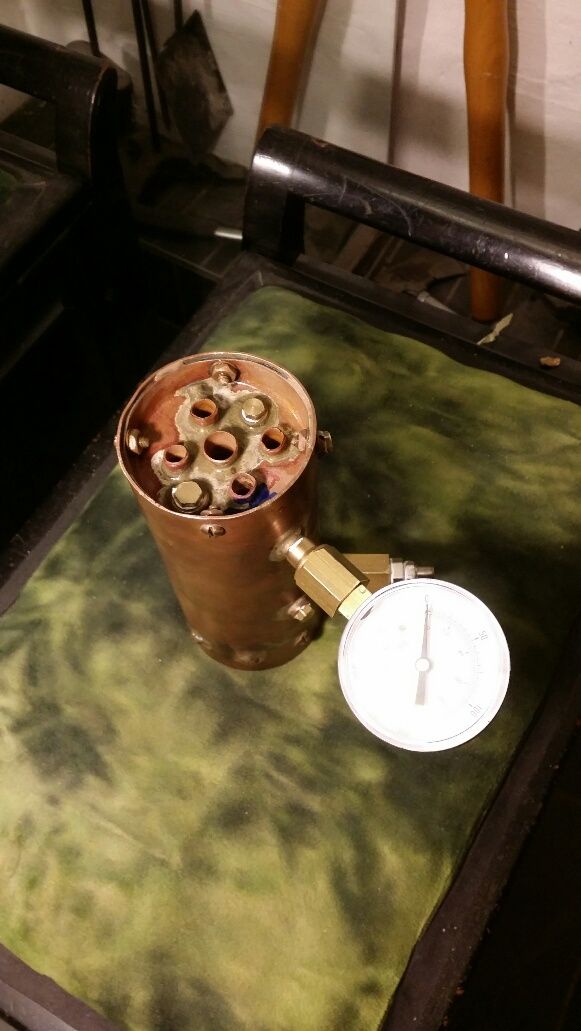

                                  Just for fun, I thought I'd post a picture of the boiler with all of its attachments loosely fitted on a temporary basis. The top plate and smoke stack (which will be of brass) have still to be added, as does the firebox. Not perfect by any means, but at least I can be happy tonight as it held air under pressure for the first time with no leaks.
                                  The blower (top right) will be routed up the stack, as will the exhaust from the eventual engine(s). I may put a twist of copper down the central tube to help hold the heat where it belongs.
                                  When it's all working the way it should I'll clean up the worst excesses of silver solder on the barrel and give the whole thing a polish to make it nice and shiny.
                                  Edited By gary.a.ayres on 13/06/2018 22:57:06
